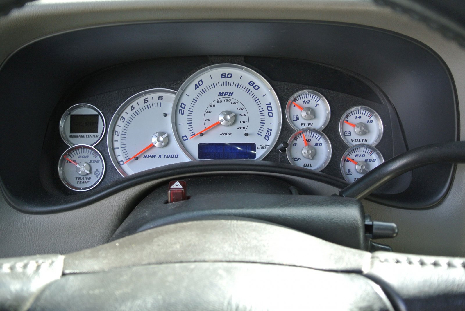

had this one in my 00, had it custom built by one of the places that doesn't build them anymore
