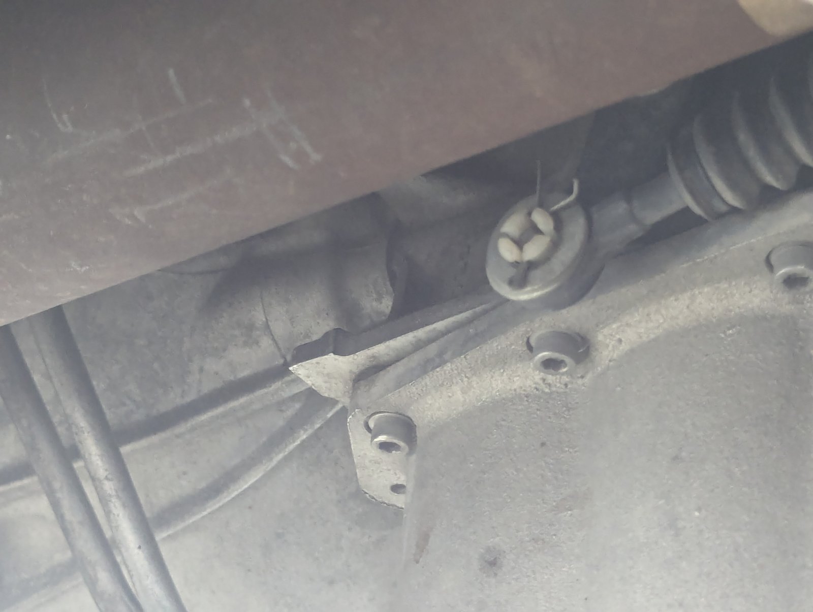

FITZALL T74498-1A $30 shipped in CA but ya it works been on there for a while now, I had already drilled it and put a cotter pin and washer so now it has both

Fitzall, washer, cotter pin it's been like 3 years already
Yep, thanks! I did see the Fitzall #T74498-1A. Not sure if that is the one you used.
It looked the most promising of the bunch, but unfortunately it's not getting here until the 10th or so.
So you have to drill out the nipple on the shift lever?
