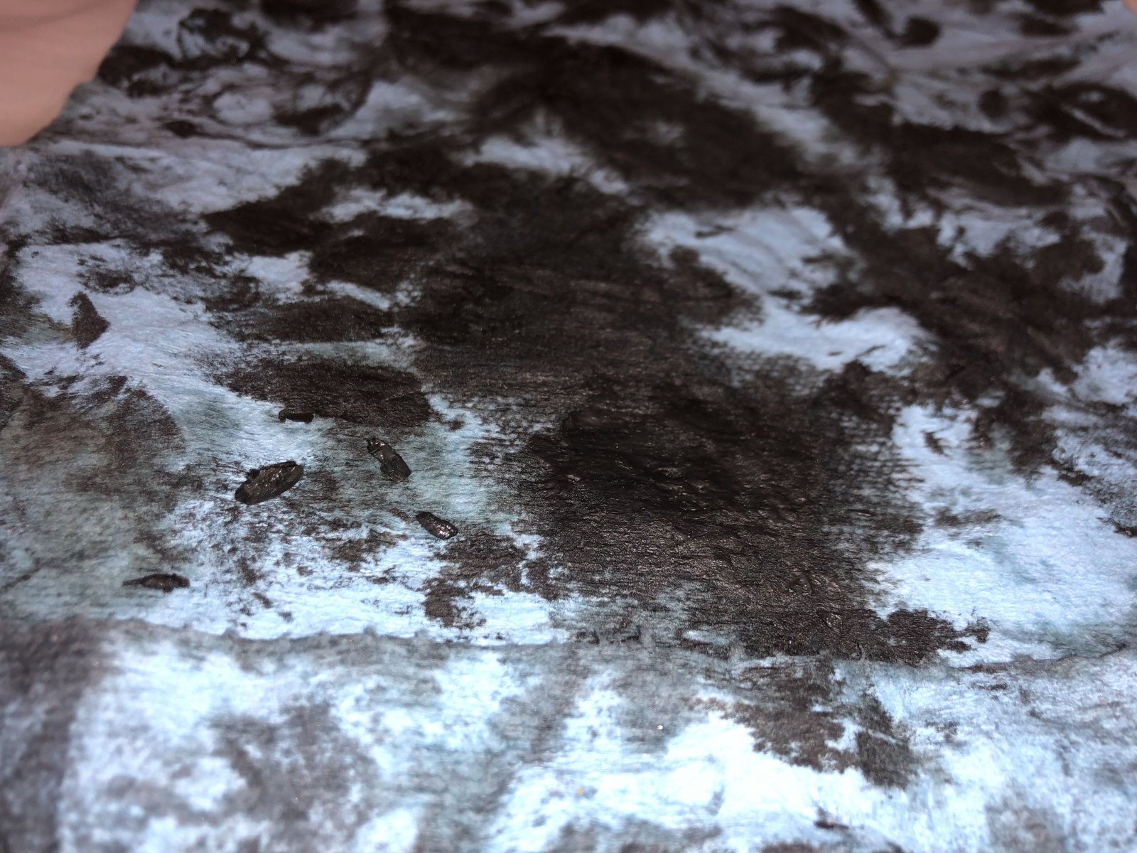

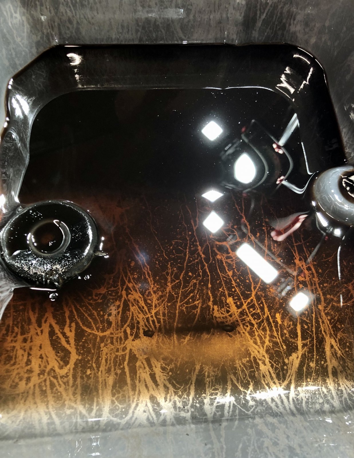

Does anyone have a list of repairs/replacements “suggested” when hitting the 100k mile mark on these transmissions? I know the obvious info listed in the owners manual and what’s listed in the Haynes manual, but is there anything additional that anyone knows of that should be inspected, tightened, or replaced while the trans pan is removed?
I’m replacing mine with the B&M (deeper pan plus it has the drain), plus draining the fluid, replacing the gasket, o-ring, filter and dipstick tube/dipstick, plus swapping out the stock trans cooler with a TruCool 40k. Am I missing anything with the transmission?

Keep the fluid clean and shorten your intervals to 40K or so. The first signs of trouble with these things usually shows up at around 160K and that is the solenoids needing rebuilding, usually from extended 100k or more dirty, worn out fluid. Can be rebuilt on the kitchen table for about $100 plus fluids.

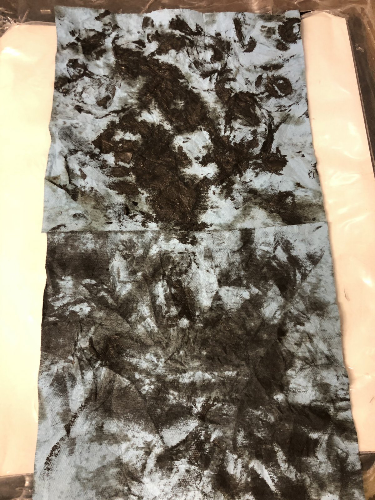

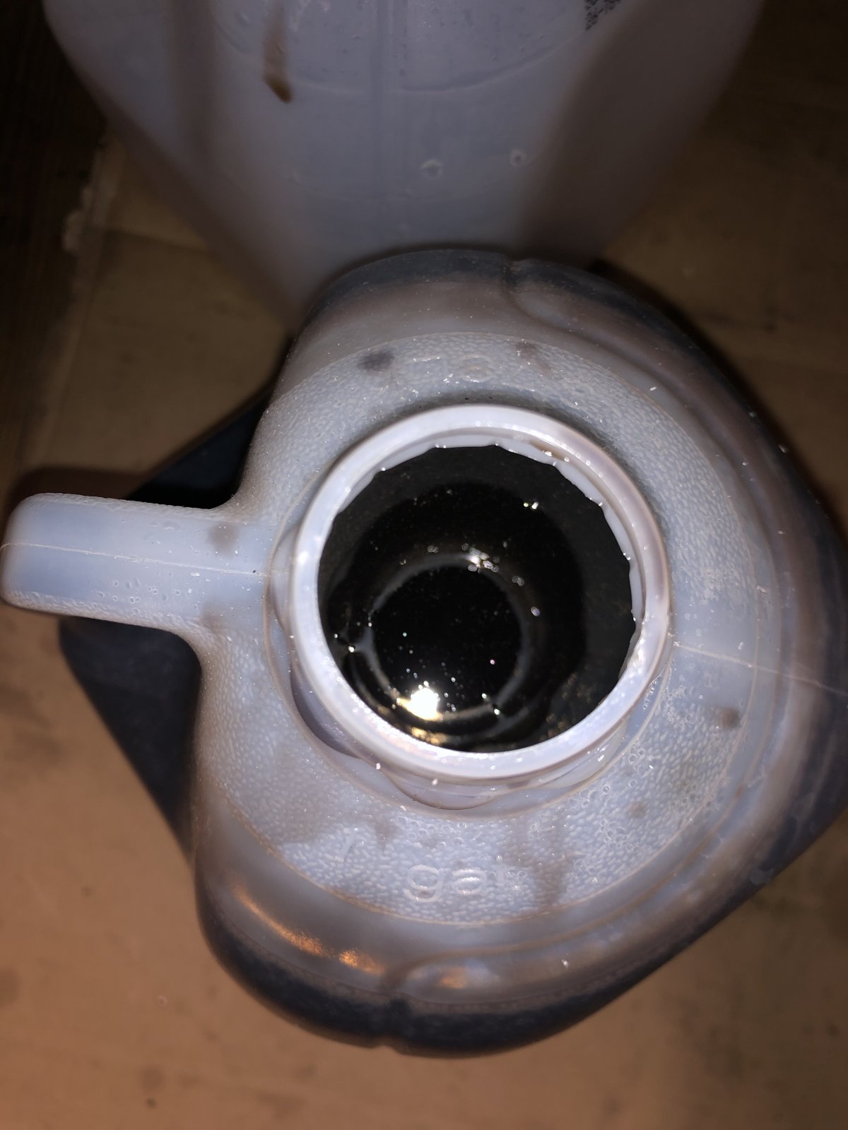

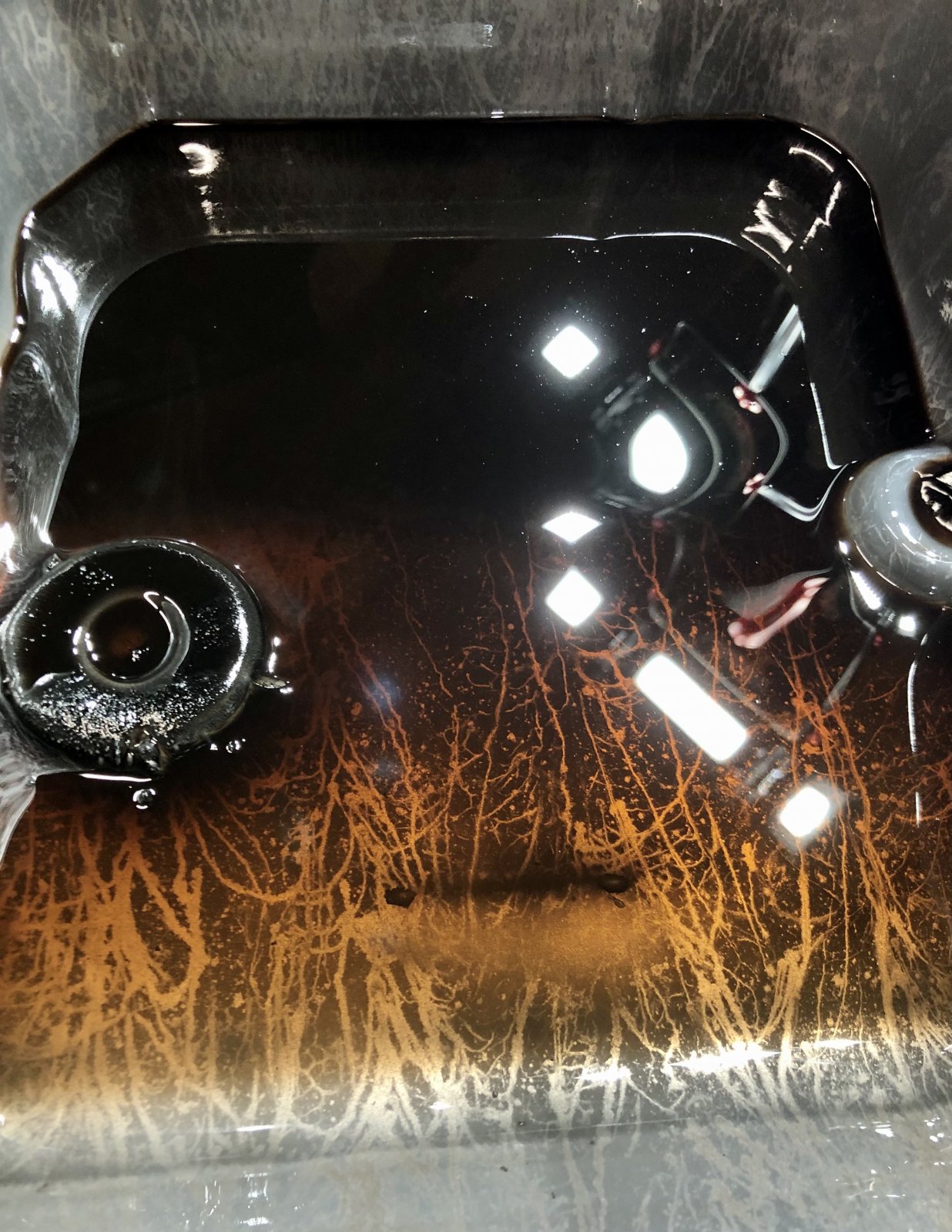

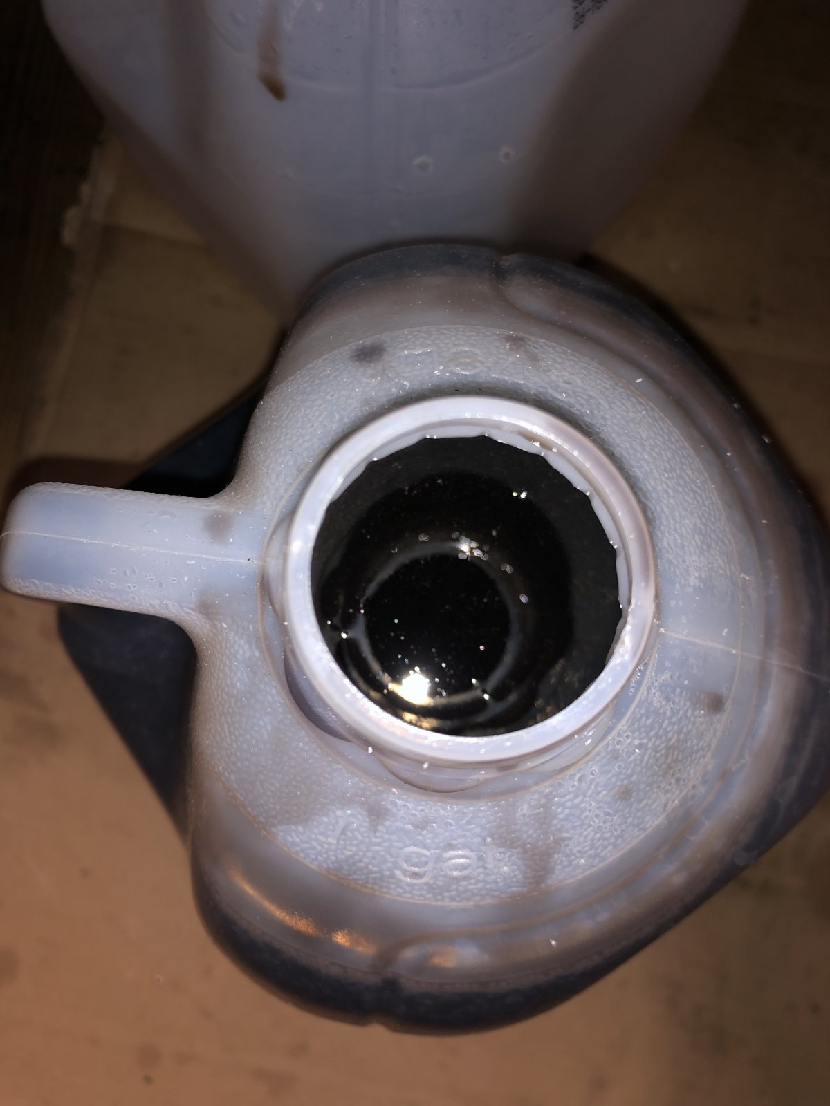

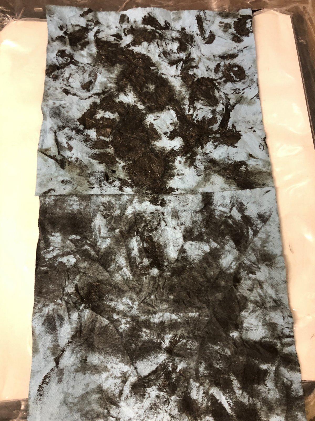

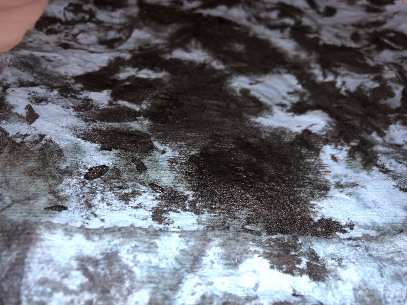

Thanks. I had already decided on every 30k from here on out like I did with my 02’. It’s close to 400k miles right now but she’s been treated well over the years, otherwise I doubt she would have lasted longer than my first marriage.

Not what I had hoped to find.
