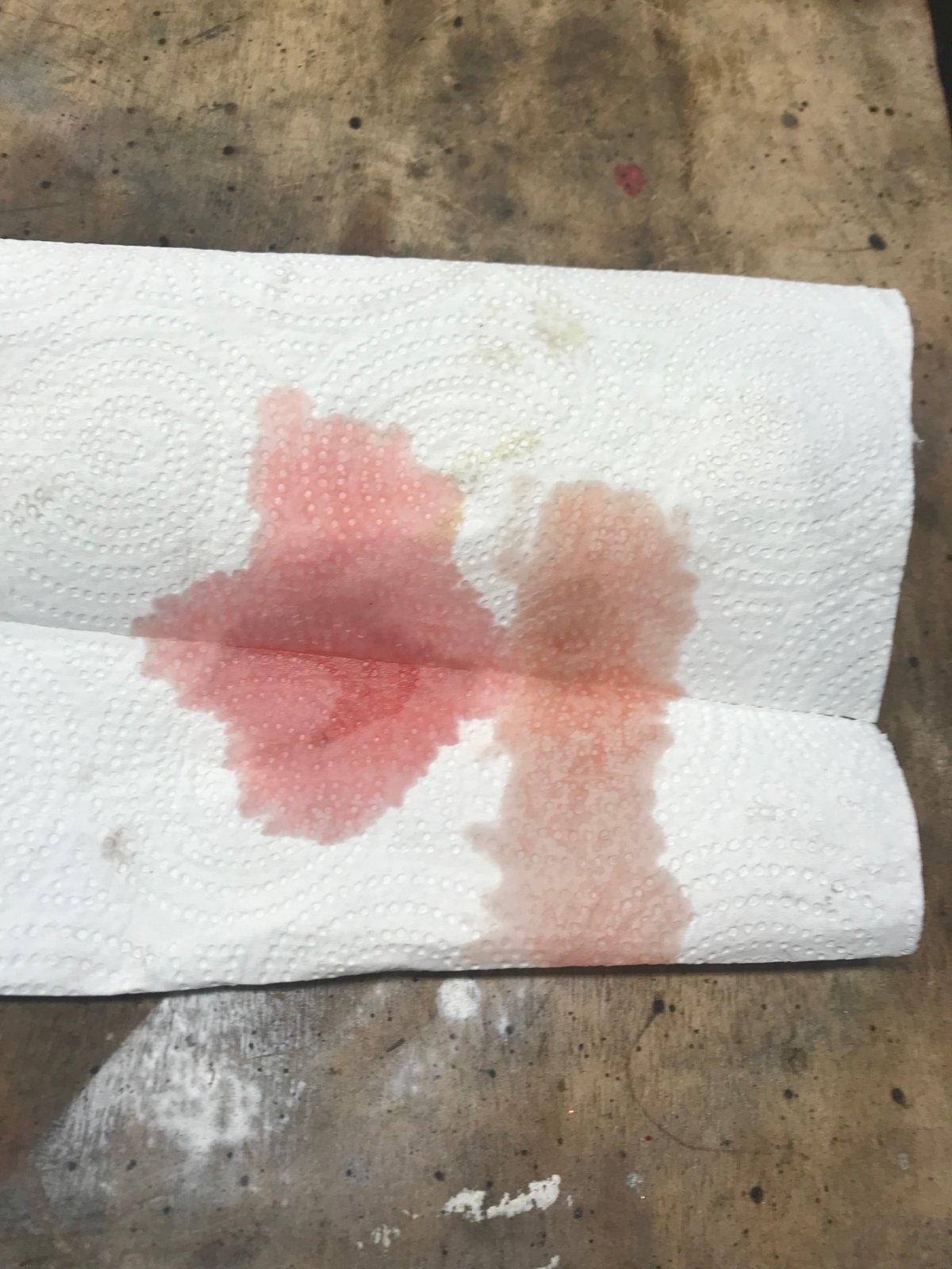

I did a paper-towel test today and it looks like the transmission fluid has most likely been changed as it looks nearly pink with just a slight brown discoloration. No way at 200k it would not be dark I would think. On the attached pic I poured some DexroVl on the left side and pulled the trans dipstick several times to coat the right hand side. My plan is to pick up about 6 quarts of DexronVl and drain whatever comes out of the trans cover drain plug and refill back with new. Next summer when the weather warms a bit I will drop the pan/change the filter and check for any sludge. The 2ML70 is a beast of a trans. It apparently has some components that a normal trans does not have.

I think that's a good plan. Def don't wanna open an unknown can of worms.

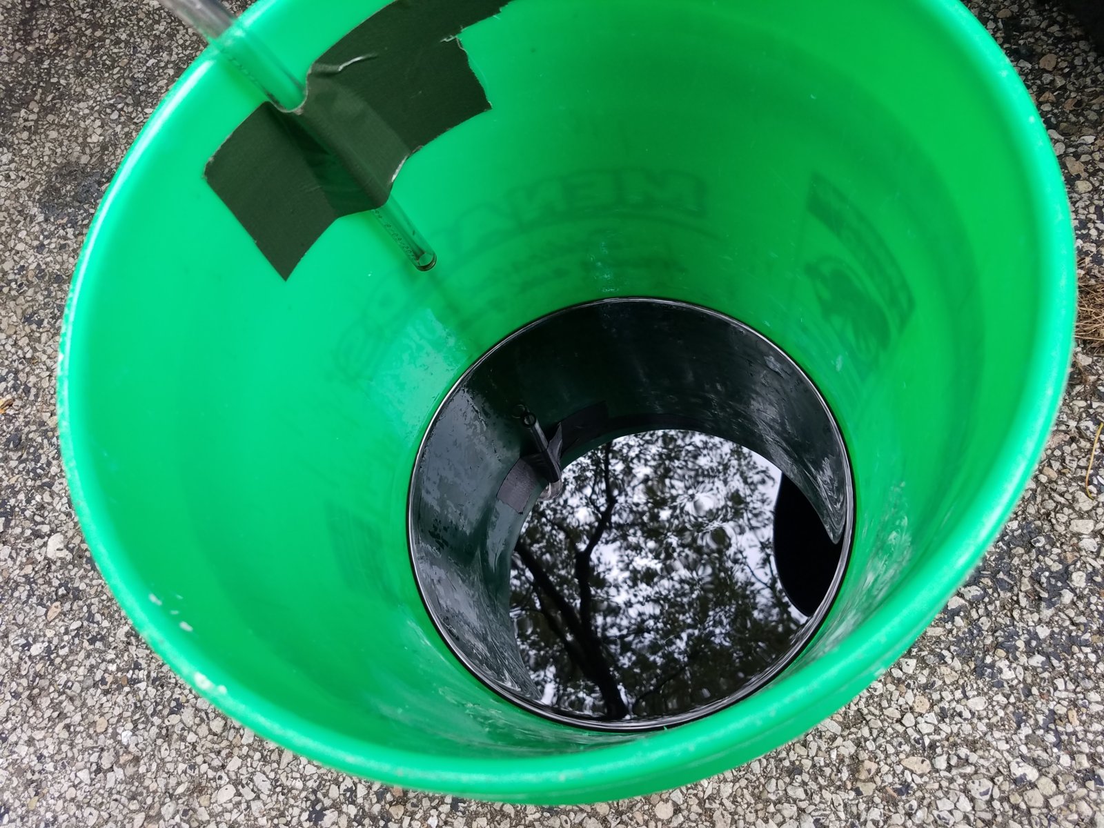

I agree that it's a decent plan, just be prepared for the drained fluid to surprise you. The dipstick can be deceiving when looking for anything beyond fill level.
Mine looked similar to yours, and my thoughts were along your lines. Here's what it looked like when I pumped that girl out....
33,200
51,447
Looks like motor oil.
