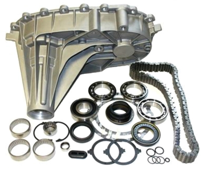

I have a 2002 Tahoe and the transfer case whines while in 2high, it gets quieter while under a load and goes away when shifted into 4high. Seems like the chain could be stretching and whining while not under a load. I am capable of rebuilding the transfer case myself, but there are so many rebuild kits that very in parts and price. Please give me your insight! Thank you

Unlikely the chain is whining. More likely its a bearing whining. You checked the fluid level in the case? Have a small pinhole on passenger side of Tcase half way up just forward of output shaft? (The pump did it).

I bought this Tahoe as a mess. Rebuilt rear end and got rid of that whine, then replaced front end to get rid of that whine. I changed the T-case fluid when I bought the truck and haven’t seen any leaks at all.

When you changed the Tcase fluid how much did you get out of it? Did you check its level before draining it to make sure it hadnt been ran low? It is quite possible that you have a bearing inside the Tcase on its way out. If you plan on keeping the Tahoe around I would just drop the Tcase and do a quick rebuild. They are stupid easy to rebuild. Theres tons of videos on youtube. My 03's have the NP246E model Tcase with the Autotrac (Auto 4wd) which means theres some clutches in the Tcase. Rebuild kits expect to pay around $350 or less if I remember correctly for standard rebuild parts (Seals and Bearing kit, Chain, Clutches if you have the Auto 4wd, fluid, Internal/External snapring pliers with long reach). But the pump rub fix plate for around $25. If yours is already rubbed through and many are then expect to buy a replacement rear half case. Inspect for the rub hole in yours. Tons of youtube videos on this also.
