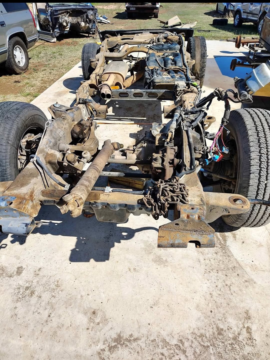

A update to my post. After getting it in the air and checking where the noise was it's coming from the rear axle after all. Around the pinion/ ring gear area. I've purchased a roller 4x4 01 Tahoe frame with both axles in 3:73 to swap over. Got lucky and all suspension components seem to be nearly new. I started a new thread if anyone wants to follow along with the swap this weekend and see the results. I'm figuring it will be a all Saturday affair.
