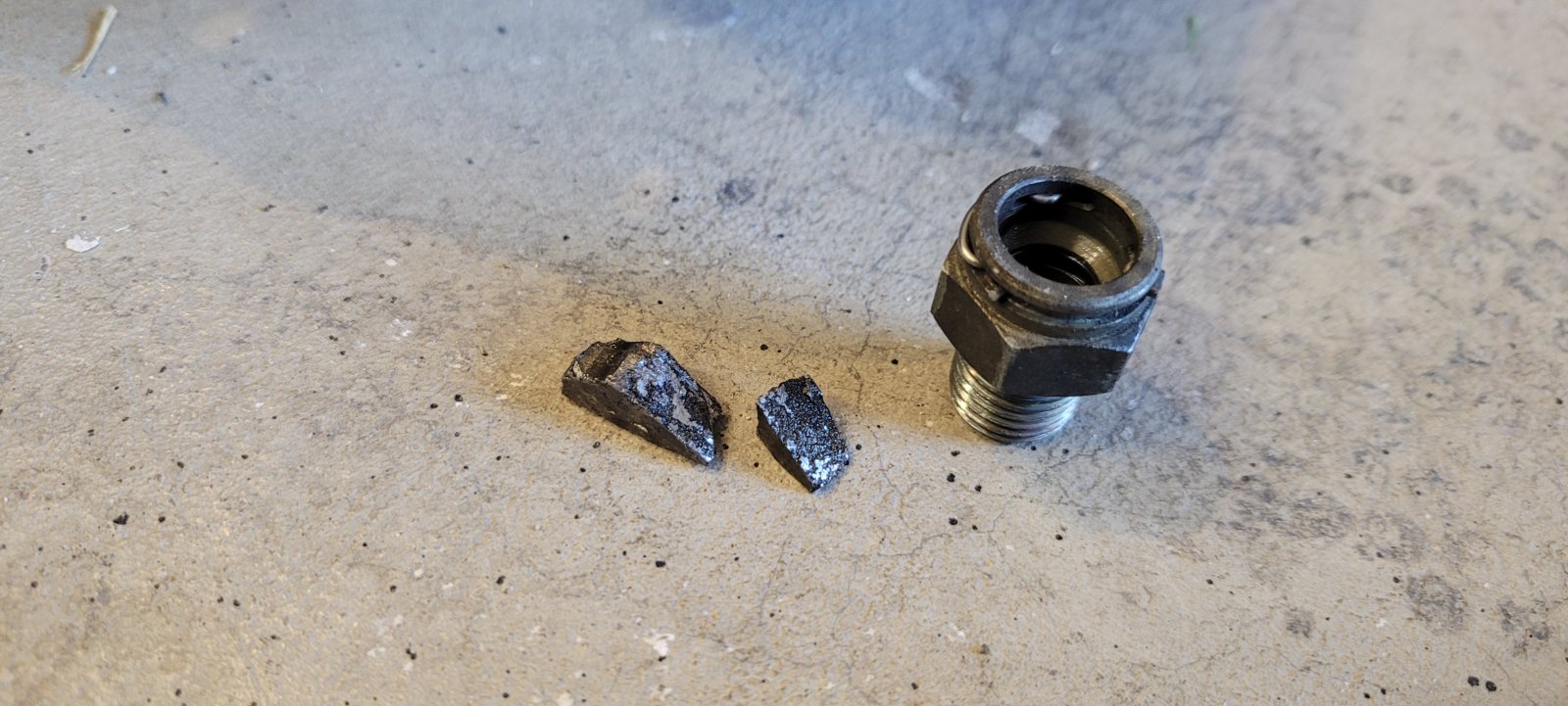

was messing around with the broken trans and found more chunks. These are the biggest so far.

Got the "new" used transmission installed and it's working fine. Took me a while to get it done and it was quite challenging for me with all my arthritis and just working in my garage without a lift. But I'm happy it's finally done. Now I have an old broken transmission sitting around.
