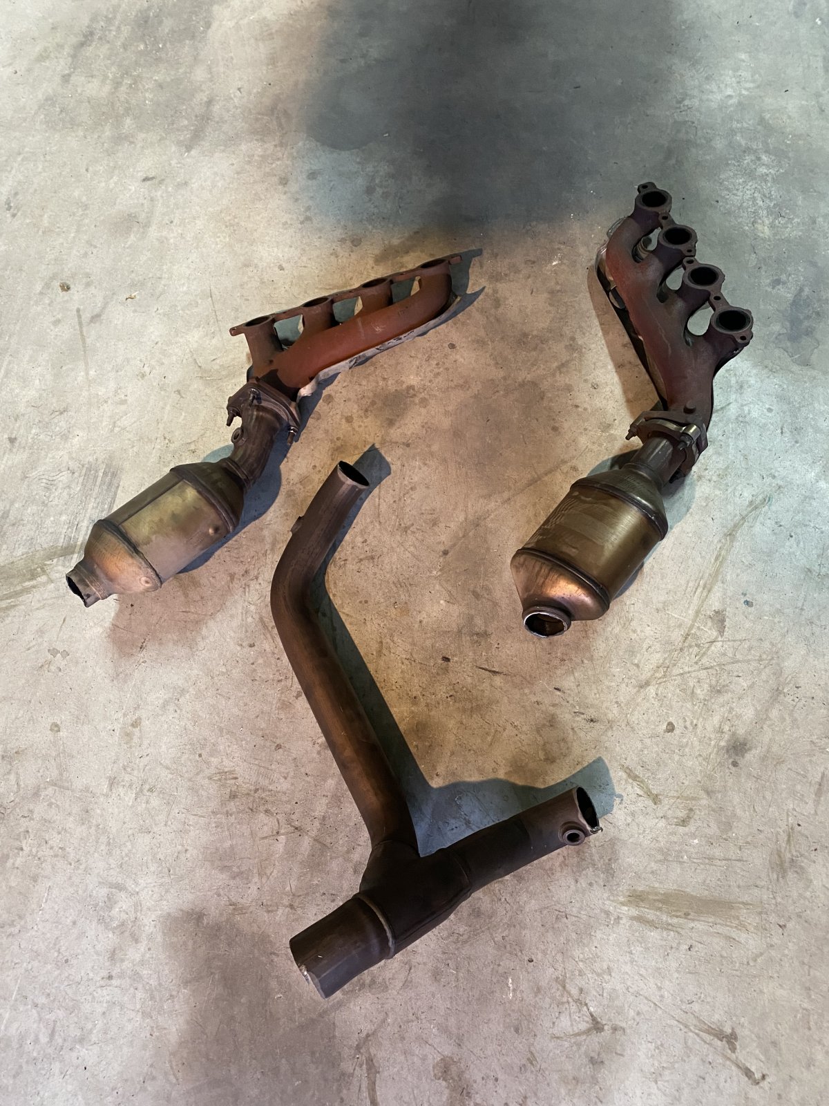

donjetman
Oct 22, 2018
2,015
3,706
I remove the exhaust Y-pipe to remove the pan on mine.
Sometimes the exhaust manifold bolts can be a nightmare (rust/corrosion) to get off.

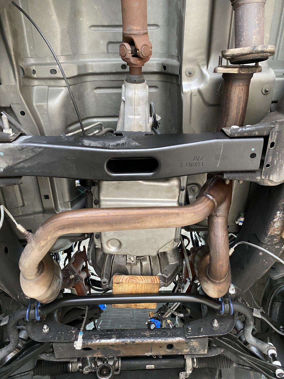

The other option is a big bar. Use it to slightly pry down the wye section of the pipe - use cross member as leverage point. With it flexed down slightly, the pan will slip out. Seems stupid, but have done it myself numerous times on my vehicles over the years. All my friends at the dealerships do the same thing. It may be a 2 person job on the floor. And when I say pry bar, I mean something substantial that can give you some reasonable leverage.

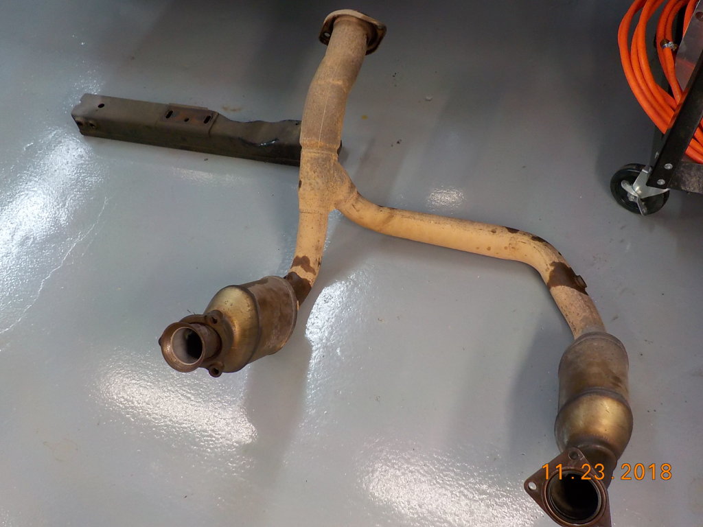

I thought @iamdub had a trick for this very situation for "persuading" the Y-pipe to cooperate.
OR VietVet
GMT800 2005 Tahoe Z71
Navy Supporting Member
Oct 8, 2014
23,961
44,740
Willamette Valley
I saw a video at you tube about using a 2x4 and a ratchet strap to pull/flex the exhaust down just enough for clearance. You have to remember that getting the pan down is only half the battle. You have to get the pan and gasket back up in that hole.
45,016
This Y-pipe?
Persuaded to cooperate:
:yaoface2:
I recall it being tight, but not very difficult. But, mine is a 4L60E so the space constraints are probably different than the OP's 6L80E. I also have a lift so I can easily use prybars and/or lengths of 2x4, which is what I might have done. I just didn't put much thought into it and didn't bother to memorize whatever it was I did. Actually, I probably did my trans stuff after I cut the pipe out.

I got 'er done. I used the jack method to raise the rear of the trans, as was outlined here. Got it finished today. No leaks yet...ha ha. Thanks for all the good suggestions for this job. 2 or 3 or7 heads are sure better than one ! thank you
Caveman1975
Oct 26, 2023
I just did this job on my 2014. Had the same problem. I used a 3 or 4 ft piece of 2x4 steel that I had laying around.
Wedge it above the exhaust. Push it up against the chassis rail. Use a floor Jack on the end. It becomes a lever, and the chassis rail is the fulcrum.
Pushes the exhaust down just enough to slide the pan off, without taking the exhaust apart.

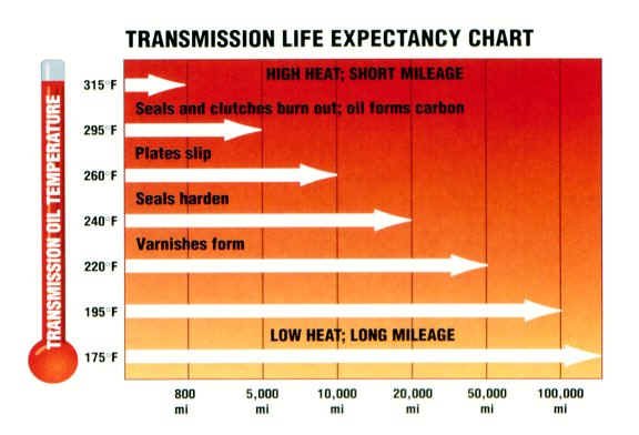

* consider this...... note that the cross over goes under the trans pan for about 10-12 inches. how much heat
do you think that radiates into the transmission? While you are under the vehicle, make a heat shield to reduce the
heat from the exhaust raising the transmission fluid temp. .... really cheap insurance for the transmission.
