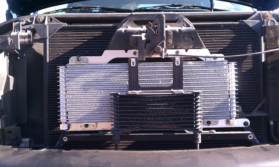

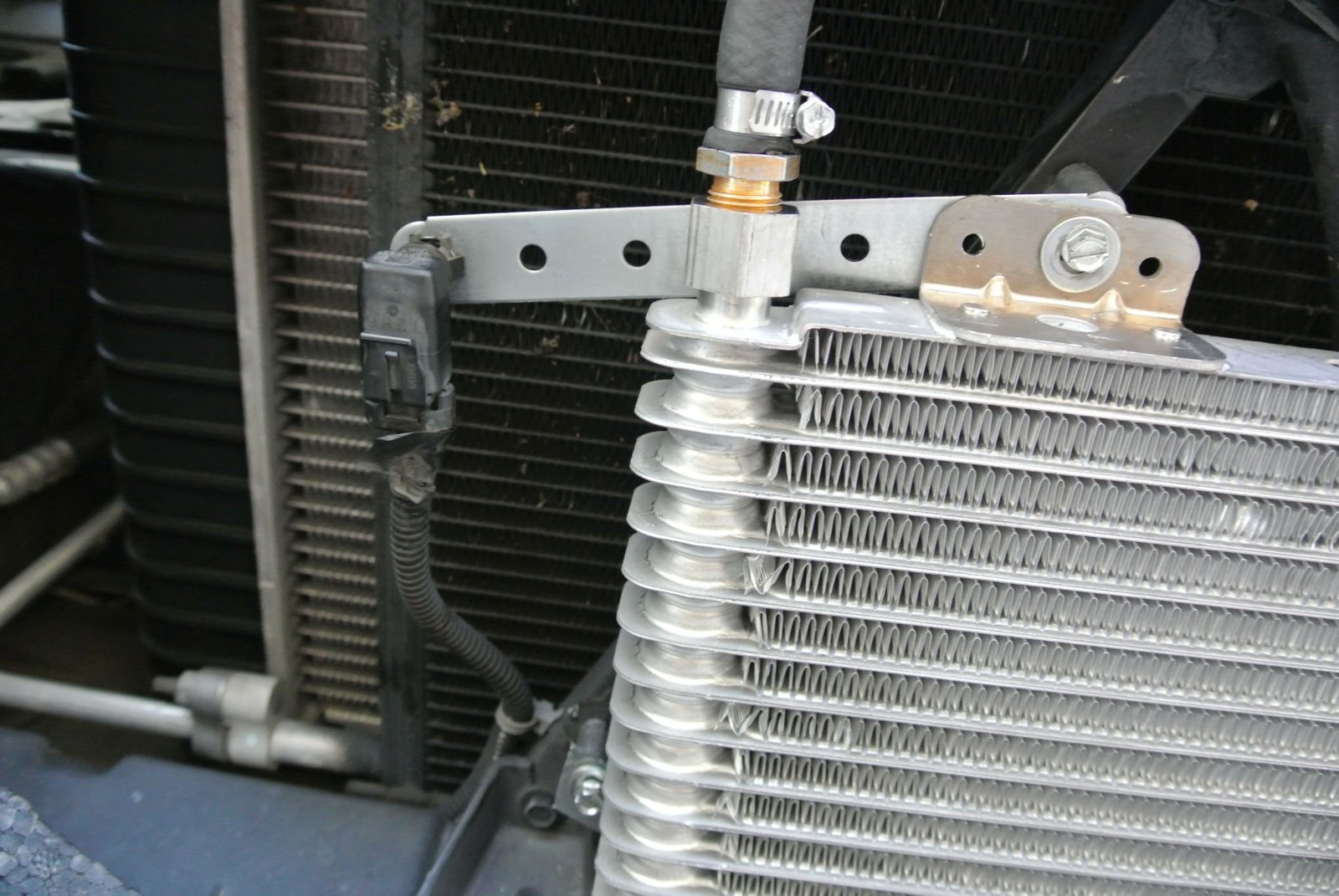

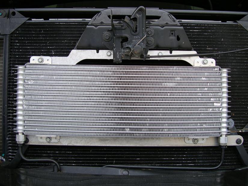

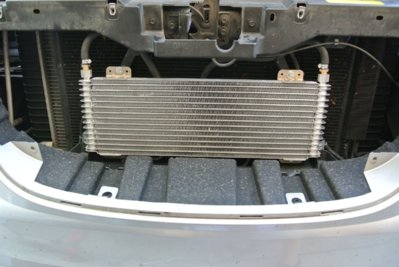

I found these pictures from EAD performance, they sell the bracket but I can fab those on my own. What I am interested in is since the factory cooler lines are run from the bottom up to feed the cooler can the true cool be run the same way as pictured?
I have read some controversy on this stating it should be mounted with ports on the top or it wont fill the cooler completely but I come from the class 8 world and mounting like this is perfectly acceptable.

They can be mounted either way. Most of us mount them with the fittings on the bottom because that’s where the stock lines are routed to. I actually contacted Tru Cool and they verified it’s fine with the fittings on the bottom. Mine is working fine like that.

it's easier to mount it with the lines coming in from the top, facing them down makes for a very tight fit and didn't want mine to get pinched, I used some 1" standoff's so it wouldn't rub on anything, drilled 2 holes in the upper radiator support for mounting and the existing holes on the bottom worked perfect then I just cut the included brackets so it fit just right, regardless you can mount it in any position the transmission fluid pump will push the fluid thru, the point of course is airflow. also you will want to move the ambient temperature sensor to the side of the cooler otherwise it will read the outside air temp from behind the cooler mine kept saying it was 120deg outside when it was really 80deg
