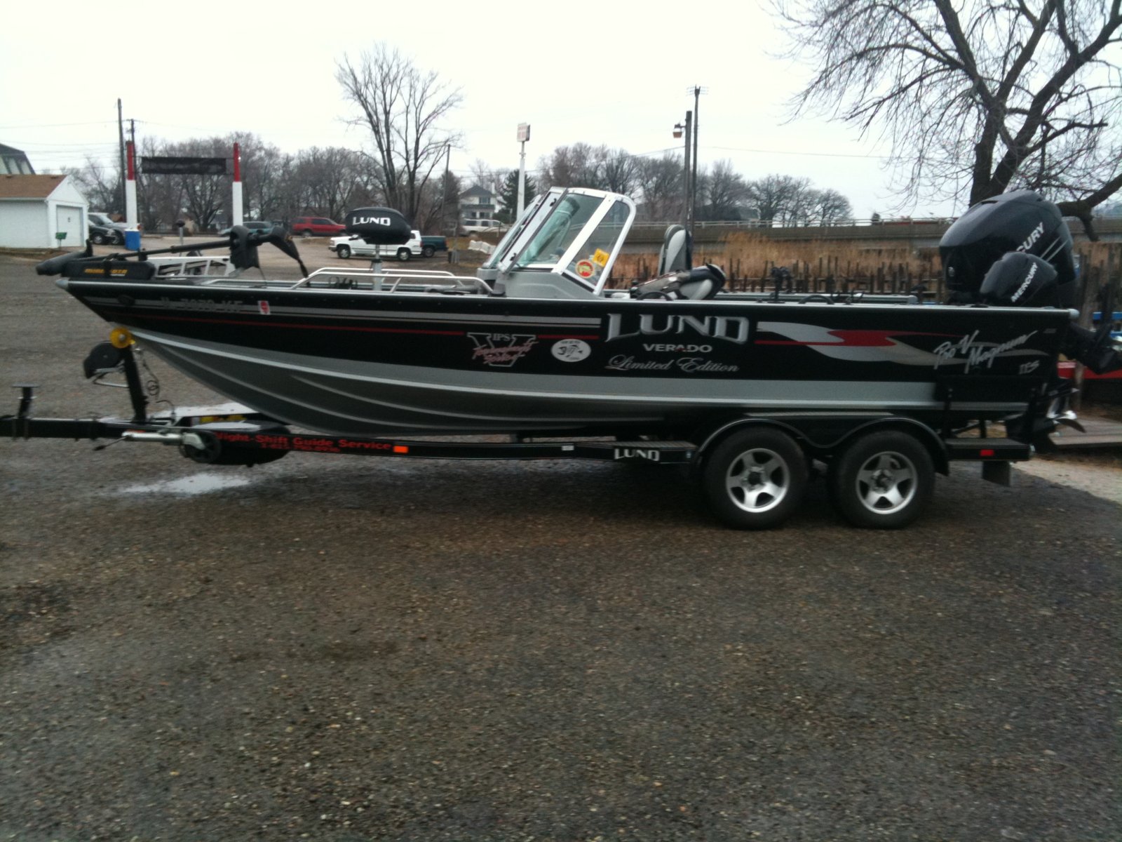

Their are no brakes on my trailer and i love it.3000 lbs and up and most around 3000 have surge still no need for the electric trailer brake box-unless your towing over 3000 and your trailer has electric brakes.
may 10th water temp 49 2014 033.JPG 2nd boat was way over 3000 and only had surge no electric brakes only surge no box. IMG_1272.JPG

i had a 4,000 lb boat, tandem axles brakes on both, had no idea the boat was back there stopping. came with drums, i swapped em to disk, had a hydro brake set up.
i tow a 4000 lb landscape trailer daily the brakes burnt out, i miss them so bad, early spring time repairs to come on that thing.
