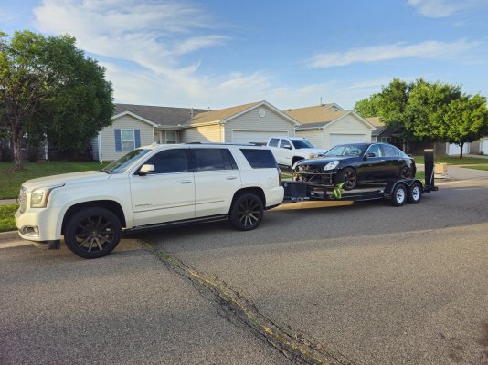

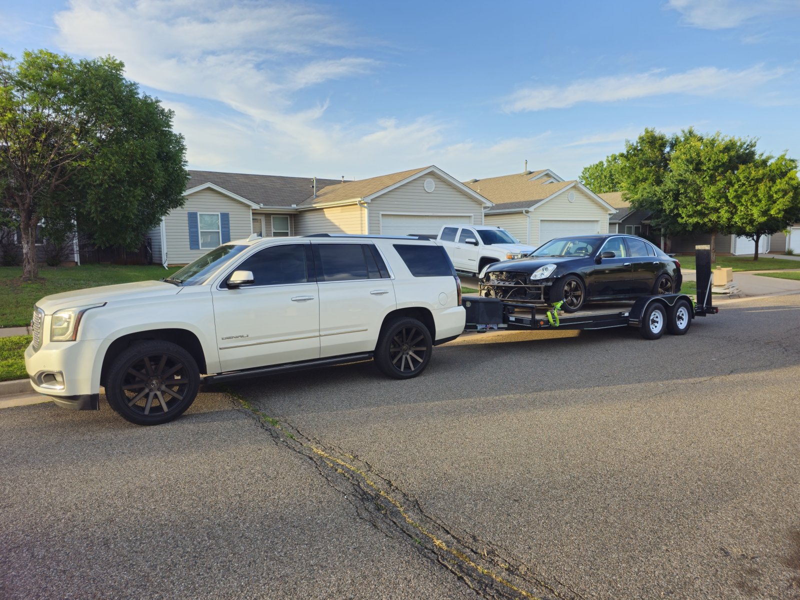

So after many miles I finally got my ass beat by my truck.
Preface, I have a 18' car hauler, towed this ***** many miles, no real issues other than being too light on tongue weight when unloaded. Towing with the suburban before, and 3 of the NBS tahoes, no issues, smooth and clear when loaded from 1k to 5k on the trailer. All my trailers I have ever owned have balanced trailer tires, this helps make them tow smooth, and helps the MPG out a bit.

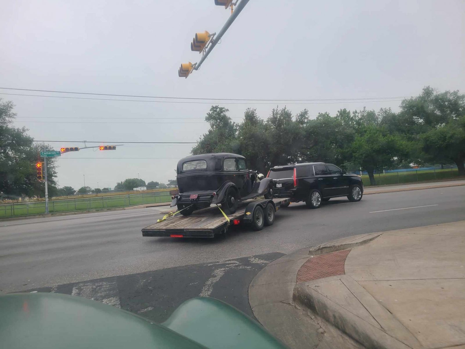

I bought the Esky last December area, loved it, Towed with it a few months ago and noticed it beating the shit out of me, I thought I was at a weird loading point, maybe not enough tongue weight, NOPE did it worse, so slid it back and was back to where it was before. This car on the trailer is a touch over 2k and was very easy to tow, hell I got 14 mpg to 15 loaded.
1 pic from that trip, notice the tow rig good and level, air suspension doing what It should and bumping up the back a bit, but front of trailer a bit nose high as they should be, not stupid high.
Today I sold the c10 I had acquired recently, and bought a Buick. Heavier car by 1500-2k lbs, instantly was the most beat down I have ever received from a truck. The steering wheel and shifter were shacking up and down, we were getting thrown up and down in the seats. The beating I got today has my whole body sore, my right hand numb a bit from trying to hold on to her. So it seems the Esky does not like this trailering stuff. Only from 70-80 mph, worse on asphalt roads that are smoother, concrete and bumpy seems to make it a bit less pronounced. The drivetrain does wonderful, and power is great... This is so bad, I am strongly considering selling both and starting from scratch.
So does anyone else have any insight on this beat down I got today? Anyone else had similar issues towing with their K2 platform? Is it the air suspension and MRC maybe fighting eachother?

I would agree with the trailer tongue height as @gooffeyguy stated. I have the Z95 suspension on my Denali of rhe same Era as yours and it tows fantastically. The air suspension works great - firm, but stable.
Shaking possibilities:
1. Bad balanced tires that act up with different front end geometry from loaded ass end.
2. Bad u-joint that is now at a different angle and binding (know this from experience)
3. Trans shudder? Did it vibrate all the time, or mainly when under throttle?
All tires 100%, new, road force balanced.
U joint, weird but plausable if the rear was sagging real bad, but it didnt sag as the air suspension brought it back up to normal height.
Shudder, I would expect it to change if lowering a gear as I was in 7th, and going to 8 did the same junk as well as 6th.
I'm on a 6" drop bar right now, I may need to go to 10" or just lower the truck it to get the trailer level.

What drop do you have on your drawbar?
To me, both pics look like the trailer is too high in the front. That may not be the problem though. Do you have another vehicle you could hook the trailer to and drive a few miles just to test and make sure there's nothing wrong with the trailer?
When I pulled with the suburban it was lowered and the trailer was level, it had MRC and didnt bat an eye lash, one thing I did find is the Burb when loading a car, that thing went down a bit and the air suspension pumped it back up, the escalade, its not dropping all that much when putting a load on the trailer, so that has really got me thinking its this truck, all problems started when towing with the Escalade. My buddies pickup the trailer hammers a bit on the tongue when empty just as it does on my tow pigs. But loaded it pulls fine on his and my dads truck. I have been thinking of getting a steel floor car hauler, maybe this is how I justify it to myself. But The tow pig issue needs to be sorted for sure.
I guess the only 2 things that would do the rear staying pumped up is the air shock links being too long from factory? or the MRC not wanting to give any under load.
Hell, I feel like I got into a fight and got rear ended after a simple 1.5 hr tow with it loaded.

Really I am leaning to a MRC issue. Tire issues I have tons experience with, and the shake was deff, wasn't an isolated one side or side to side, whole rear up and down kind of feel like an off balanced washing machine on spin cycle. And it was more pronounced on smoother roads like asphalt, and less on concrete bumpy roads.
I do agree now looking at photos, I need to get the front down or I need to drop the escalade a few inches to fix this issue of trailer not being level.
Last thing I can think of is maybe a belt in the tire is failing on the trailer and causing a harmonic? Weird shot in the dark, but may have to try to take it over to the tire shop and get them checked out.

So, FWIW, I tow a 4300 lb boat and trailer all the time w/ My Air Ride+Mag Ride Denali, and it is smooth. As a matter of fact, I almsot think the ride is better w/ the trailer than without. Just towed this thing 1000 miles round trip, and one of my passengers commented, on about mile 700 "This Vehicle has to be the smoothest riding I have ever been in."
First, you should always have the trailer tongue level w/ the road, so you probably should adjust your drop.
Second, there is a TSB out for a kinked/pinced air compressor intake hose...I would check this hose to make sure you don't have a restriction, but would think this would flag a DTC in the system.
Third, you need to load it so you have about 10% of total weight on the tongue...best way to measure this is on a scale (See if there is a CAT scale near you, and measure it). If I had to harken a guess, you are getting shook because the tongue is pulling on the rear end...likely not enough tongue weight, although I would expect you to feel this in any tow vehicle...
Are you sure the load in the trailer is centered left to right? Perhaps the anti sway is kicking in due to this?
Definitely ponderous...but, my towing experience w/ my boat is fantastic w/ this rig.

That car particularly has a 800 lb motor in it, so it's Very nose heavy, before starting the esky to head home the truck was just about leveled and the air pumped it up to stock height.
the 34 Tudor is alot less up front, so I have to load it further forward.
But I think the Air is pressuring up so much to put me back at stock and the trailer is too high up front, so it's a compound issue. I realized I am using the drop that I had on the Suburban and it's a 6", that truck was lowered on a 2/3" drop. Thinking maybe the trailer has a tire issue that could be adding to it.
I really miss the Suburban platform; the longer wheelbase makes it ride so much better all in all. But for backing up maneuvering, the short is where it's at.
I got used to the nnbs with no air suspension, load it down and the trailer was about level loaded and the non mag ride didn't care. Towed a crap ton with that one. I think the K2 inherently has some rough ride with magride. I've heard the towing with the latest IRS models that it can be a little too spongy for control of trailering but with what you're saying, sounds like a formidable platform to look at for the future. I test drove a Tahoe the other day and was impressed with the ride.
