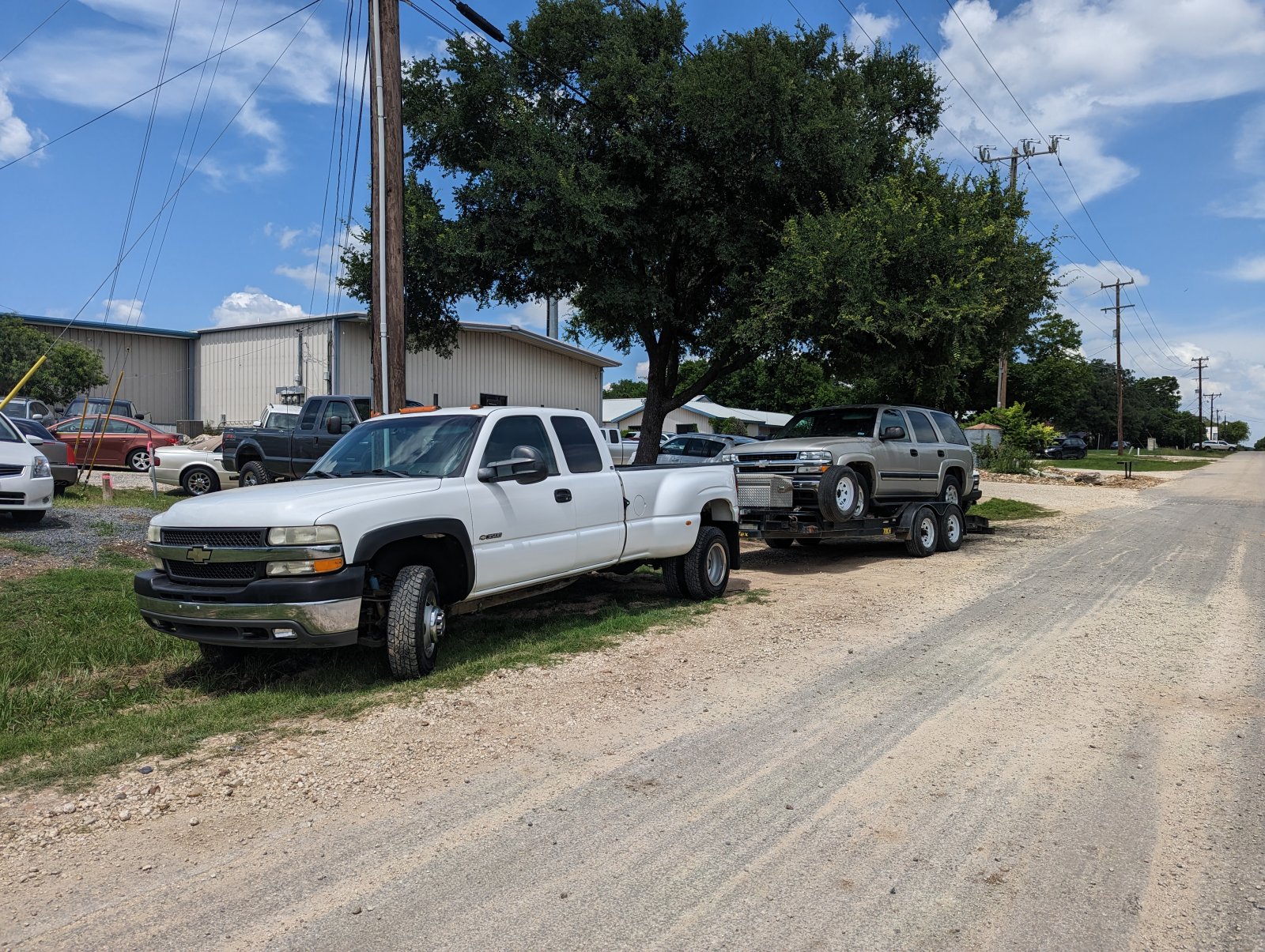

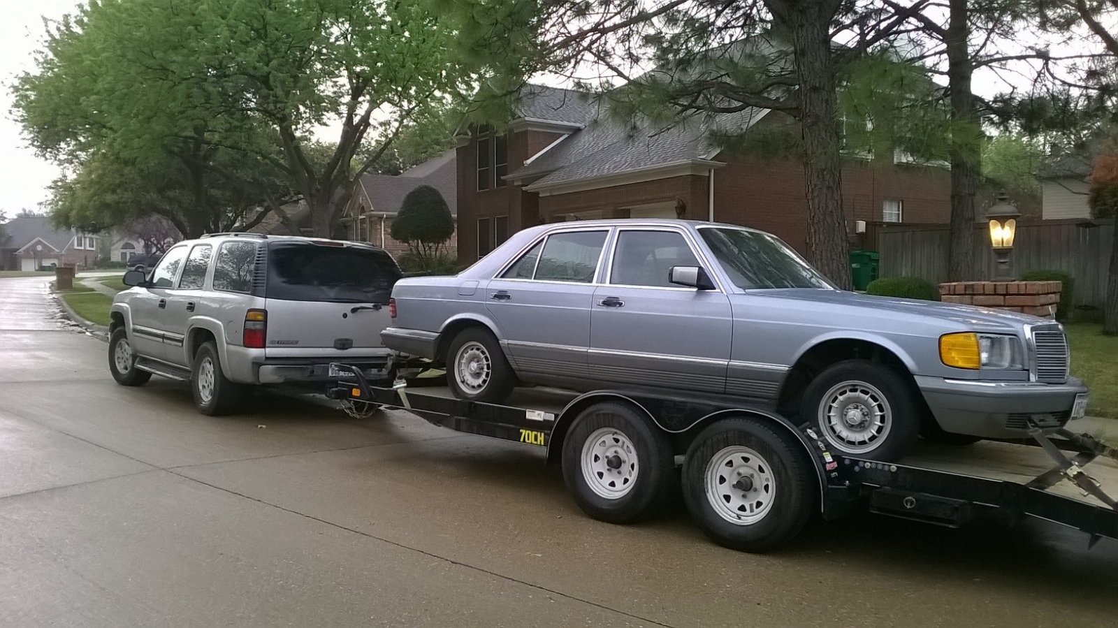

i have a 2005 Tahoe 5.3 2wd, approx 150k at the time of the described event. I towed my 83 300SD on a tandem axle car hauler from Austin to Dallas, it wasn't my trailer so i dont know the exact weight but guessing 5300-5800lbs combined. I had the car positioned on the trailer to distribute the weight properly (no weight distributing hitch), and used tow/haul and "3" the entire way home (you do not want to pull in D with these transmissions). The truck did the job, the engine is strong enough, but there was no doubt something really heavy was back there the entire time. Driving in "3" made my mpg's pretty poor, but a tank of gas is much cheaper than a trans rebuild. The drive down (unloaded) felt like i was driving a paint mixer the whole way. The ride home (loaded) was much smoother. Just my .02, but i would not purchase my Tahoe to pull that type of load on a regular basis.
Conversely, this summer i purchased an 01 Chevy 3500 4x4 with 8.1 and pulled the aforementioned Tahoe back from San Antonio to Dallas on the same trailer. I didn't even know it was back there.....
if you're going to tow the trailer/horses on a somewhat frequent basis, i'd consider a 3/4 at least.
