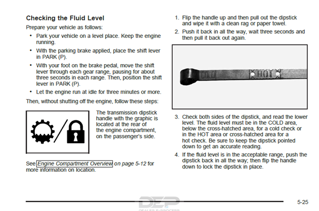

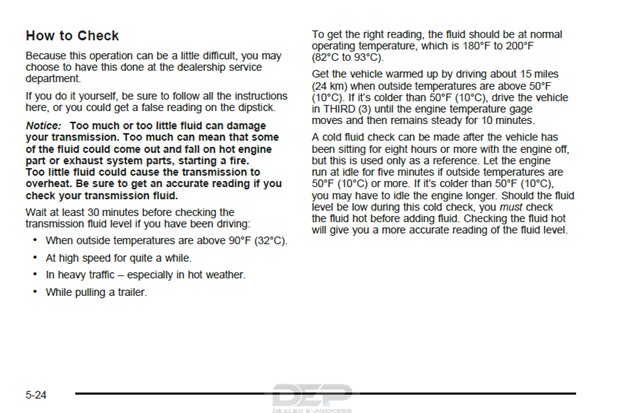

What is the best process to check fluid levels in these trucks?

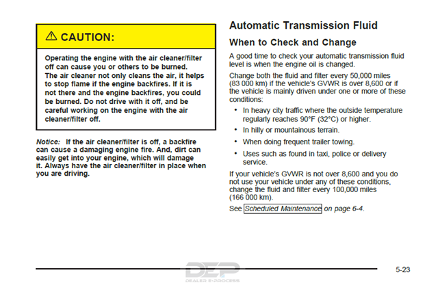

seems a little high to me, to check the fluid, pull the dipstick, it may be time for a fluid and filter change too. taking a look at the fluid can tell you a lot.

Fluid level is covered in your owner's manual, available online from GM, like this from an '04:

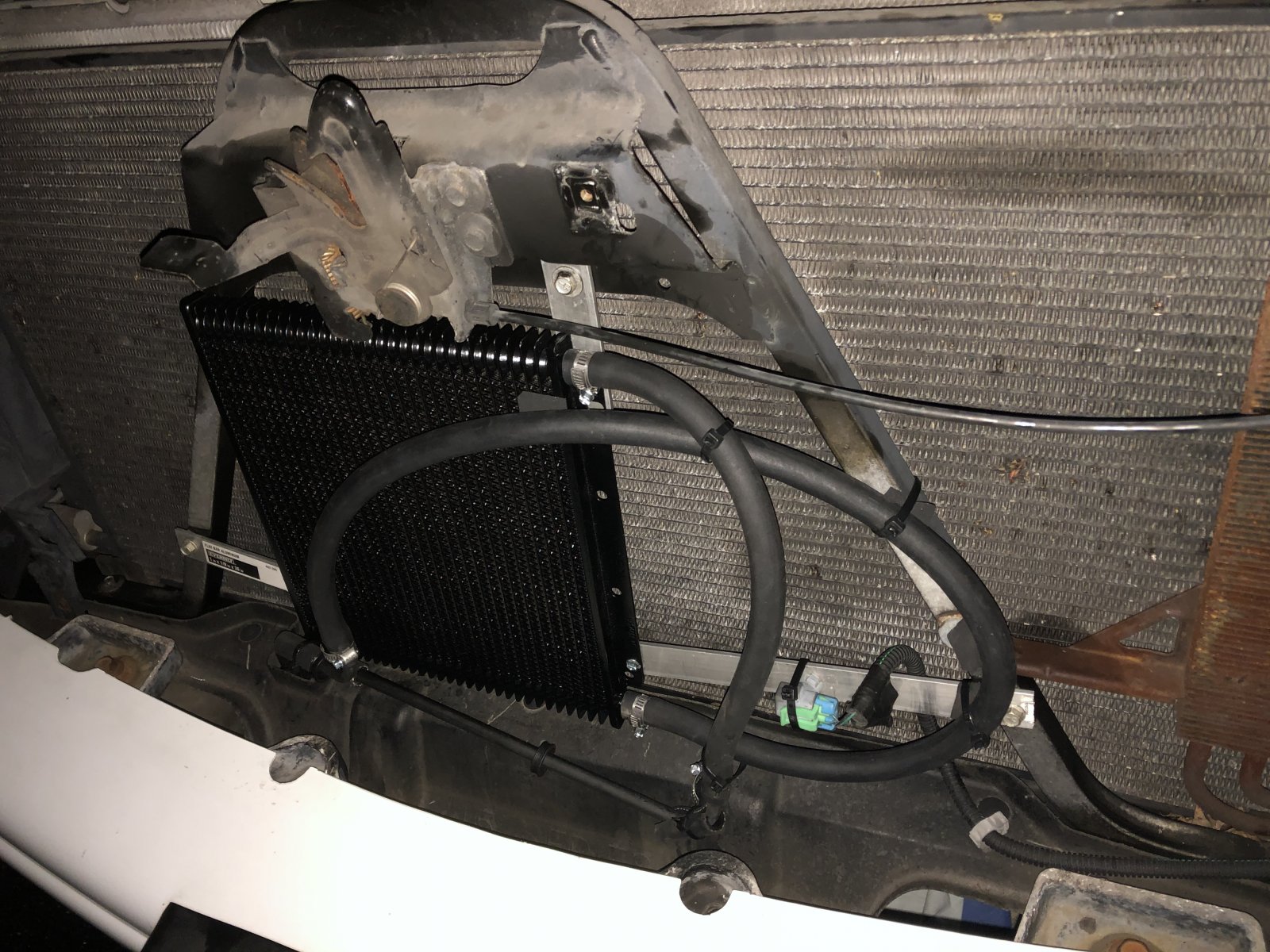

Update... I needed to tow again the next week and I was uncomfortable waiting for a cooler. I installed the only one I could get. Not anything as good as the Tru-Cool but it kept me below 180 rather than around 220. If I have to go back and replace with the Tru-Cool it will be easPictures below

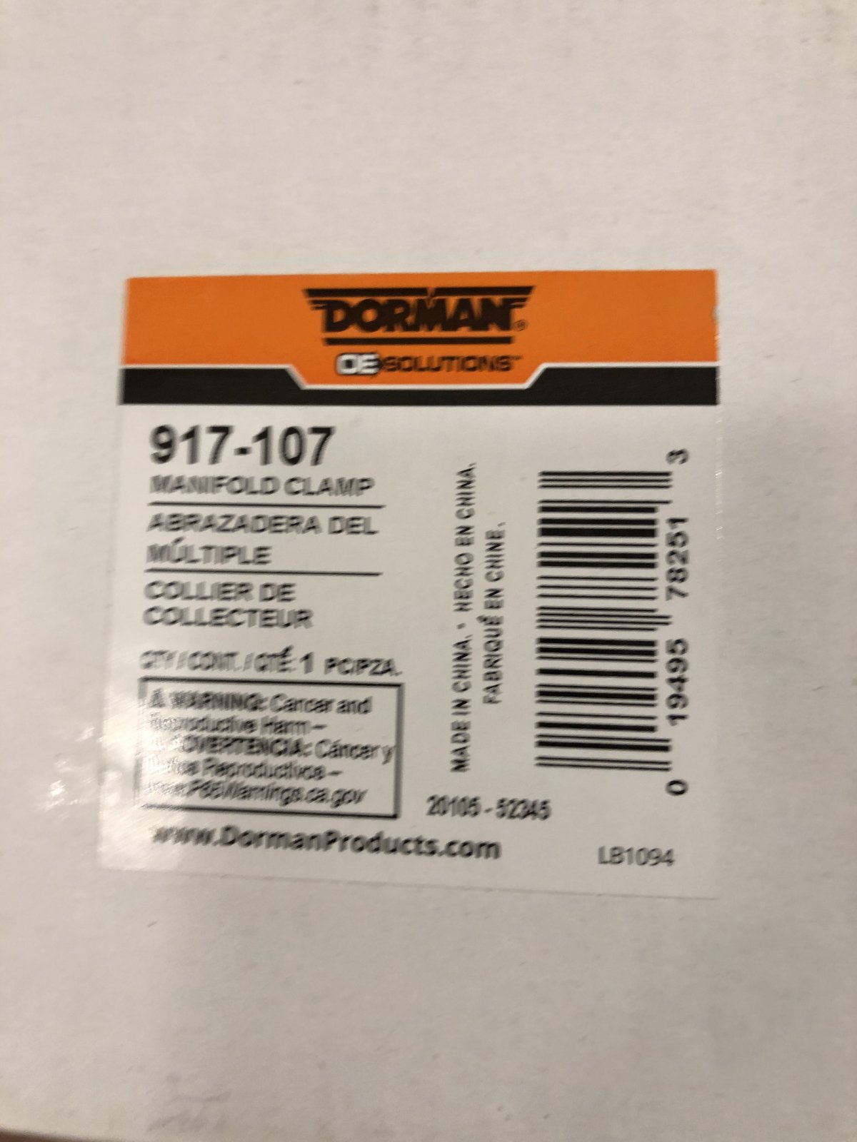

Next I needed to address the tapping I started hearing. Manifold bolts rusted off. Added this

Not sure what the line size is, but if the transmission cooler kept temps down with the load you had, and the load is the usual you will haul...you are probably fine with it.
Also what cooler was it?
rockola1971
Dec 29, 2016
2,862
4,083
Indiana (formerly IL)
Agreed. 220 deg isnt nothing to sweat bullets at BUT your tranny will last alot longer with a tranny cooler installed and temps kept below 200deg. I not only recommend them for towing vehicles but even daily drivers. They are cheap compared to the cost of a rebuild every 125k.
