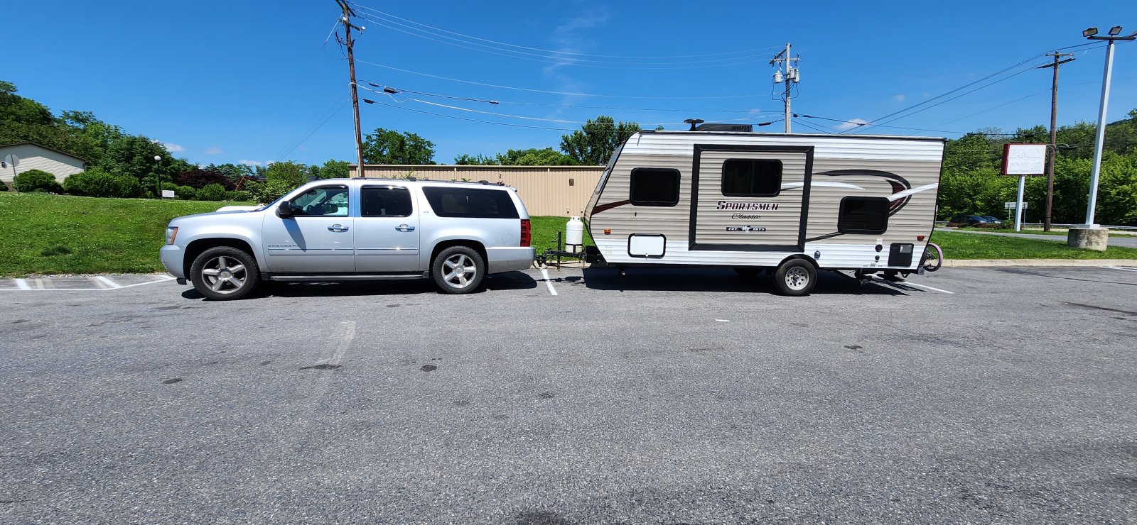

Hello, back again. Just hooked up the load distro. Went really smooth. The L brackets are at their lowest point. Probably because it's a fairly light trailer. That seems to be where the previous owner had it as well. He towed with a very similar Chevy pickup, that also had load leveling on it. Drove it around for a while. You can definitely feel the truck and trailer seem as one now. Will take it out in 2 weeks for our first trip. As always, these forums are fantastic, especially when the members are great. Much appreciation!

I do the same. Hitch and adjust with the ignition off. Your manual should have instructions for hitching with a weight distribution hitch. My 2016 manual says to adjust the weight distribution system to make the front fender opening height the same as when unhitched. This keeps an appropriate amount of weight on the front axle for steering control.
I suggest you monitor your transmission temperature. If you have a 6L80 transmission, the torque converter clutch can be a weak spot and is adversely affected by heat. There is a factory service bulletin to change out the thermal bypass valve (thermostat) for a 70°C (158°F) thermal bypass valve. I lost my transmission recently at 120k miles. I now have a GM reman transmission with the service bulletin valve.

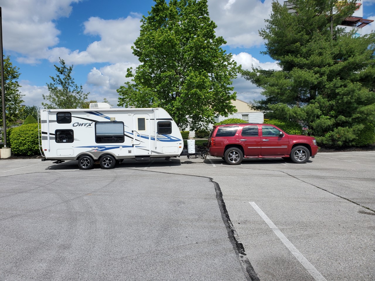

our suburban with auto leveling air ride. Pump runs before we pull out, then looks like this, vehicle is running. So question is why the squat? Max weight of camper is 3500. This should not squat one bit, but there it is. No cargo 250 lbs worth of children in 2nd row. 2013 suburban LTZ
4,655
5,900
View attachment 429421our suburban with auto leveling air ride. Pump runs before we pull out, then looks like this, vehicle is running. So question is why the squat? Max weight of camper is 3500. This should not squat one bit, but there it is. No cargo 250 lbs worth of children in 2nd row. 2013 suburban LTZ
there's will. know better, but I'd personally hook. up a scanner and see what the pressure in the air bags are doing.
my guess is they aren't holding air and the pump isn't coming on to try and refill.

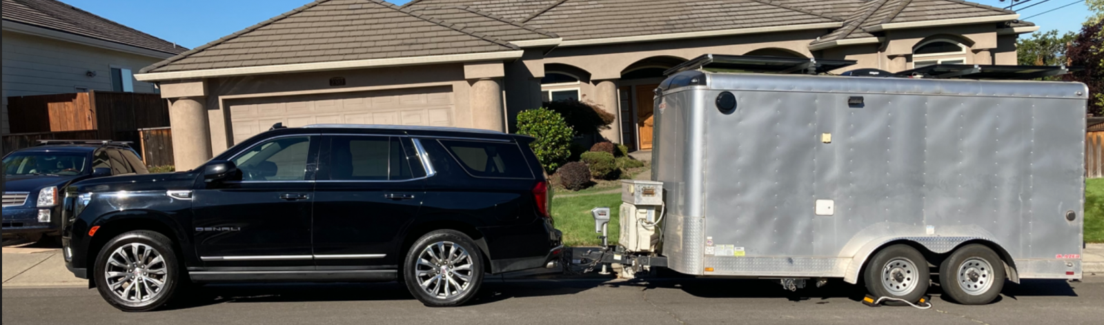

I tow a 5300lb (650lb tonque) 7 x 14 cargo -> camper with my 2021 Yukon Denali. The trailer has weight front/back but not so much in middle so much so it's not 'the best' for stability.
Without WDH it get's a little squirrely at 60mph+. With WDH it's rock solid.
I don't have air, just magnetic ride.
Without WDH the rear goes down 2" and front up 1" - it's visible in the pic.
With WDH the rear goes down 1" and front up 1/2". Since rear is slightly higher than then front in normal mode, it looks more level.
With WDH and you're tongue weight, I wouldn't worry :)
