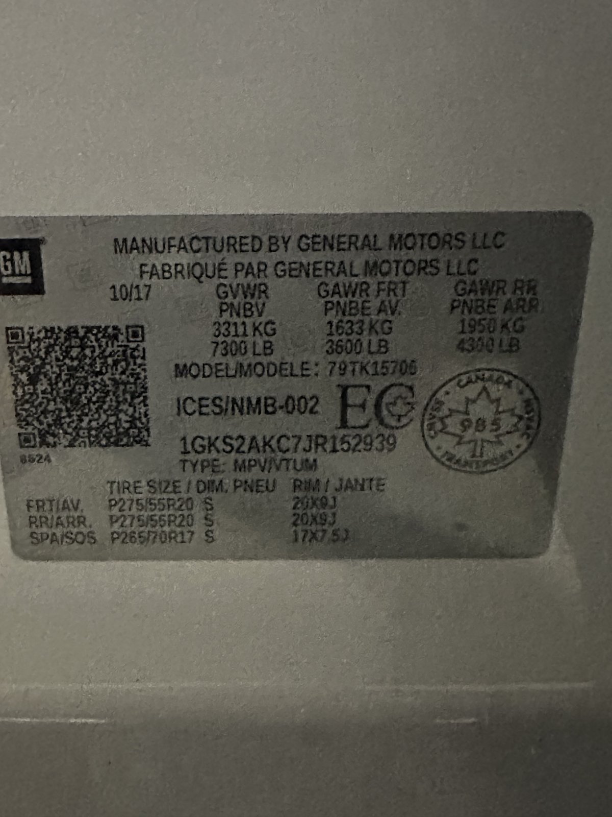

Hey folks i have a 2018 Yukon with the HD tow package. I’m currently looking at buying an RV that’s 34’ and about 7000lbs. I’m curious what you guys think about how this might tow and if I may run into any issues. I have attached photos with details about my truck and the RV. Any advice is greatly appreciated in advance.

Looks like 7,147 is the empty weight if I'm reading that right. By the time you get it loaded up for camping you'll be closer to 9,000 lbs. and the tongue weight will be close to the payload of the truck before you put any people or gear in it. Ours is 7,500 lbs fully loaded for camping with 950 lbs on the tongue, and I pulled it for 4 years with a long-body (Yukon XL Denali) and it's about all I wanted on the hitch in windy conditions. I pull it with a 2018 Suburban 3500 HD now and I'm much happier.
That trailer is Suburban 2500/3500 material, in my opinion.

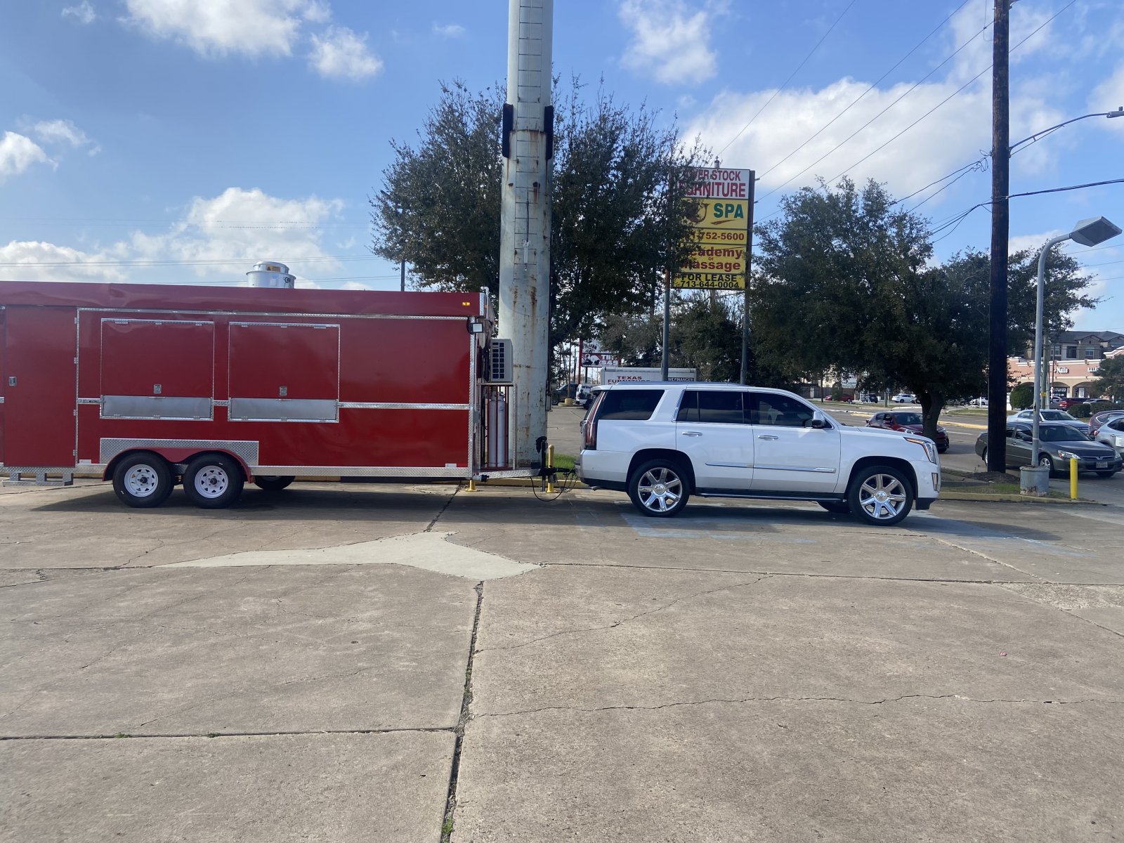

You will not have an issue pulling the bumper pull. I do sell trailers and I use my 2018 Escalade to pull it. I would suggest putting premium gas when towing. Monitor your trans temp and if it goes out of range then get the deep pan & trans cooler.

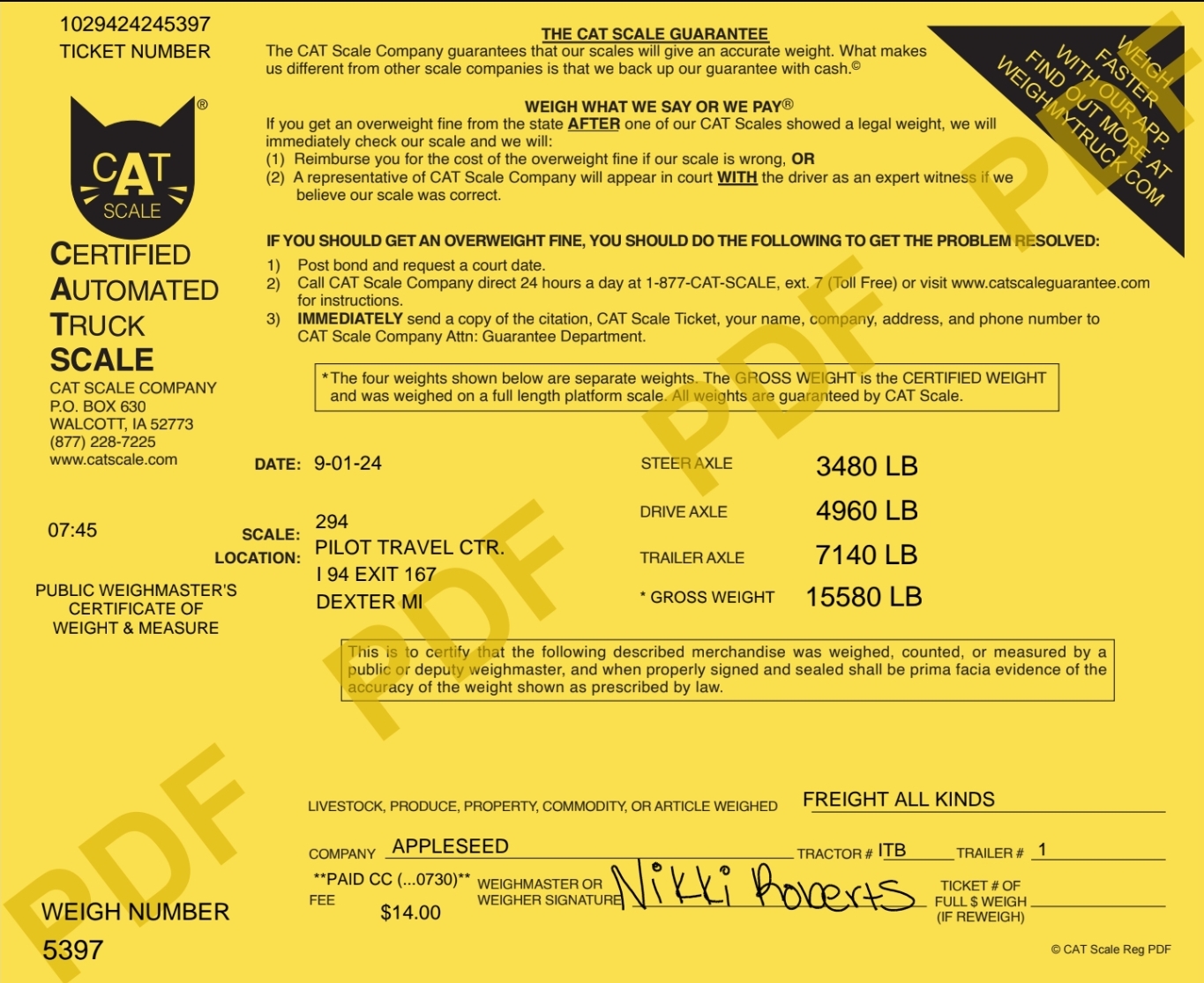

Never mind the fact that you'll be completely overloading your rear axle, the weak point of the half-ton trucks.
If you're planning to tow it 50 miles to the lake/shore, never going above 55 MPH, go for it. But if you're planning long road trips, you need to reconsider.
The three primary things working against you :
1) Short wheelbase - less stability.
2) Weak rear axle - will be the first thing overloaded.
3) Payload - unlikely you'll have enough left for people.
You want to shop for "half-ton towable" trailers.
For your Yukon - 24-26 feet, 5000-lb dry weight
RV dealers want to sell an RV. They're unlikely to tell you your tow vehicle isn't up to *****.
I tow what you're considering with my 2500 Suburban, and I'm close to its limits.
Do you pump low octane gas into that Esky when not towing?

Another thing to consider, does your hoe have the max trailering package? if not, your tow rating is 6,400 pounds. With max tow it's 8,400, and a gear change in the axles. That would mean that if your trailer starts at 7k, you would have 1,400 pounds of weight from people, camping supplies, water tanks, food ect ect to be within your rating assuming you have the max tow package. And that weight capacity starts going away pretty quickly....

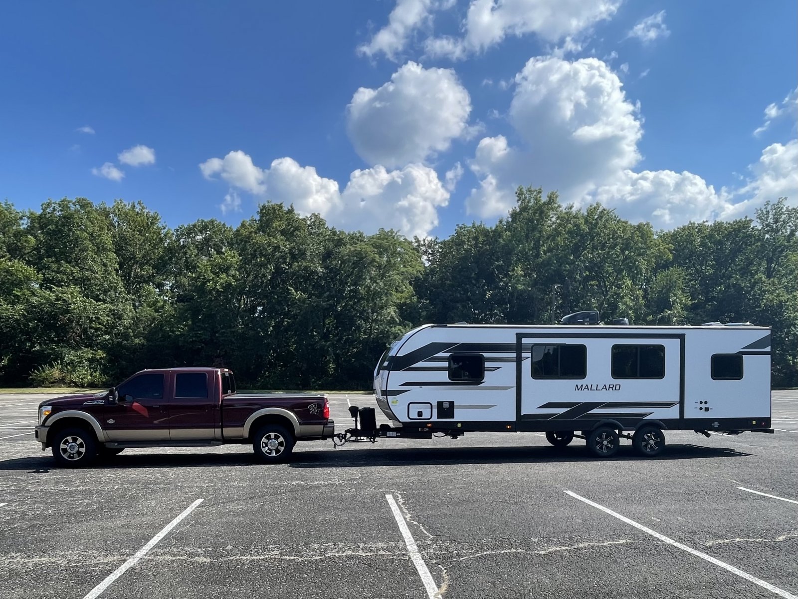

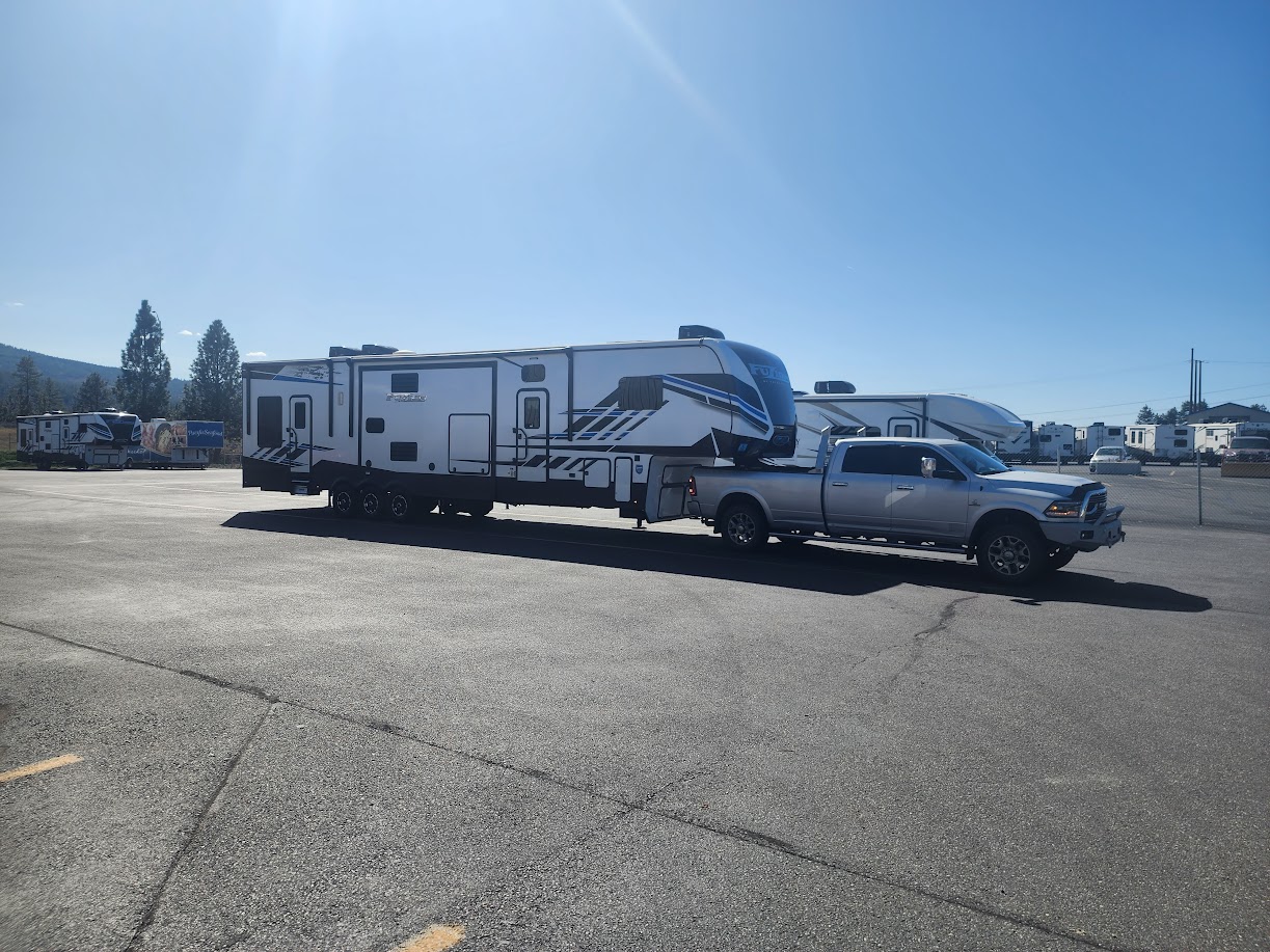

Can’t wait to go gamping with my 2024 Dodge 3500 Diesel pulls 38,000 lbs.

No duelly, no deal. Don’t want to be all over the road.

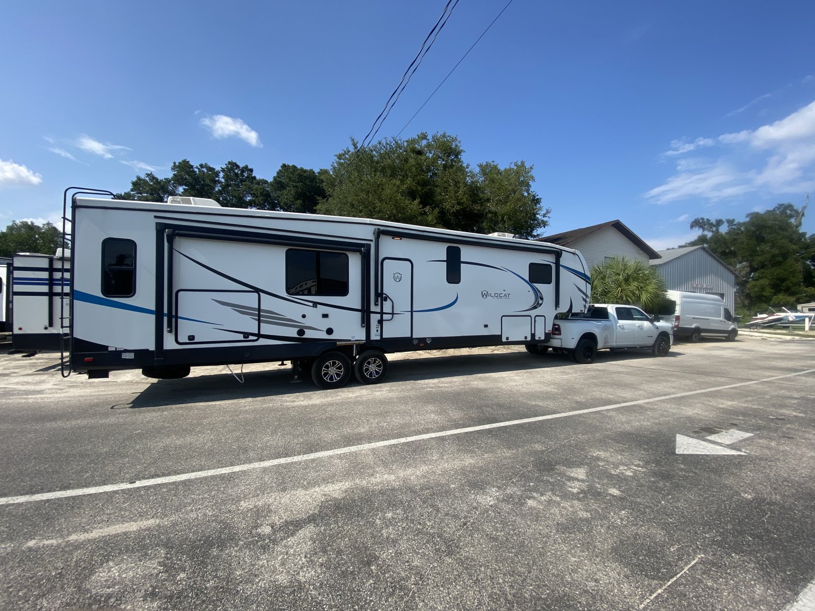

IDK if that picture is taken in wide view or not, but that looks like a heck of a trailer to stick with tandem axles. The trips on mine might not be ideal for tight turns but with the weight i'm glad the trips are under her.
