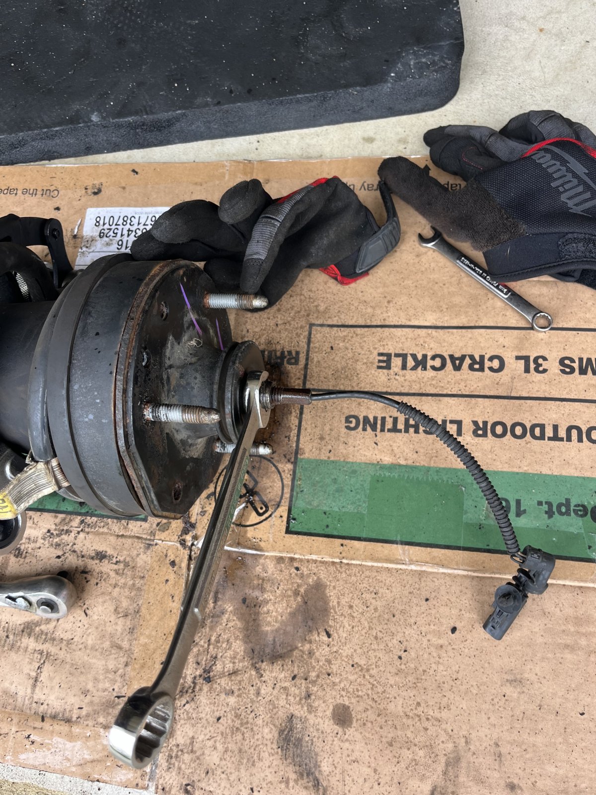

Replacing front mag shocks in a 2015 LTZ.
Took apart the struts and put in the new mag shocks but I can’t find the torque spec for the top mounting nut anywhere. My repair manual only goes into replacing the strut assembly not the shock and doesn’t give me torque values for it. Here is a pic of a wrench on the nut I’m talking about.
For right now I just used some locktite and a good 2 grunt method. I impacted it off so I can’t even estimate how tight it was.

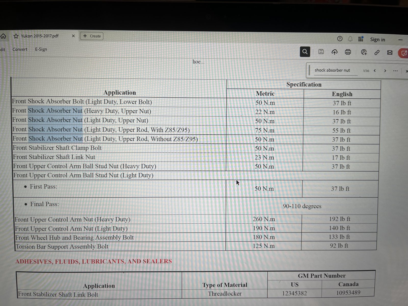

FYI I found it in the GM shop manual. 55 ft-lb with Z95 mag ride.
