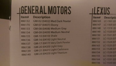

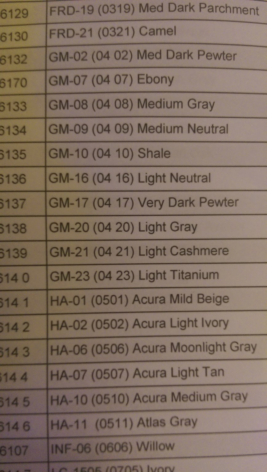

IMAG0131.jpg IMAG0130.jpg Don't pay attention to the numbers, just the name of the GM colors. These aren't all of the GM colors, but most of these are used on our NBS's.

The RPO chart I have says the 922 RPO for model year 2002 is Neutral Pewter so I don't know for sure. I painted the sides of my console with the SEM and it's real close but if I put the pieces next to the dash it's just a bit different, just enough to be noticed.

Have you thought about spraying the air bag also? Dashes do fade some over time. Where did you get your too chart from? The listi have is my form from the school I went to, not GM.

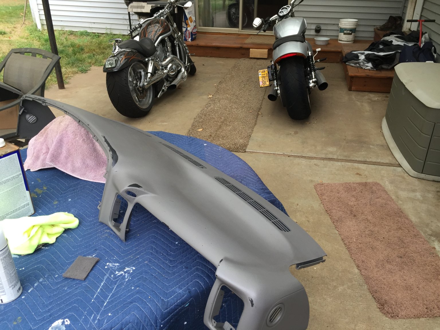

Well this turned into work. I thought I could just scuff the dash, feather the edges of the peeling and repaint but after I put the first coat on, I saw it bubbling a bit at those areas so I decided to strip the whole thing. Most of it came off by just rubbing it with my fingers. Some I used a heat gun on low, and some was real stubborn and I had to use denatured and scotchbrite pads. Some before and during pictures:

A couple after pics. Tomorrow it's going back in; I'll post some final pictures then.
