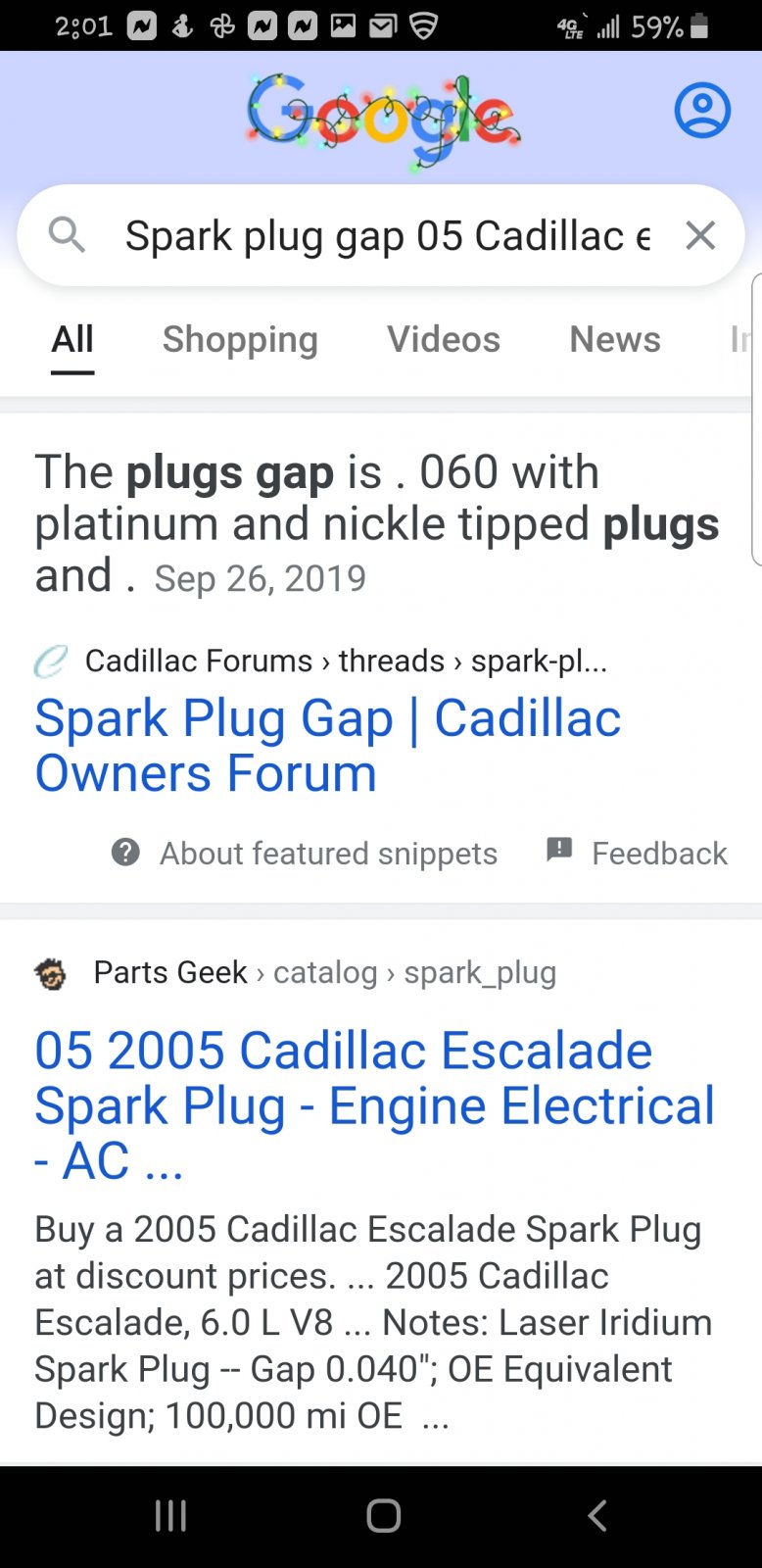

Does anyone know what the gap should be? I found this--
But I also found that the platinum--AcDelco that was in it--should be gapped at .040. Anyone know for sure? Opinions? I think I MIGHT go with the Delco's 41-962, unless someone has a better plug. Opinions?

Found similar but the iridiums that I got were gapped at 40 or 45. I just went with what they were
