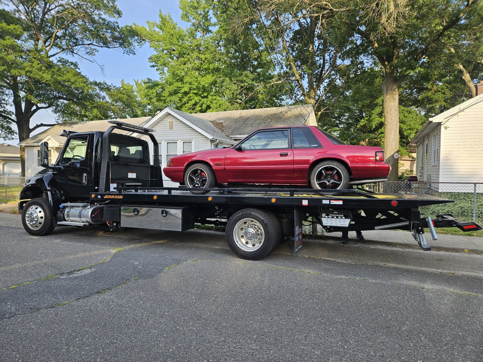

Fuel injector was pi$$ing gas through the grill onto the road. Weird.
i think most of us expect to see a ford on a tow truck. lol
Can't argue with that--Although--my most reliable car is my Crown Vic. Figure that $hit out. I had a leaking brake line that pi$$Ed out all the fluid for the front brakes--and I drove it like that for a few weeks lol. And I didn't even know!
