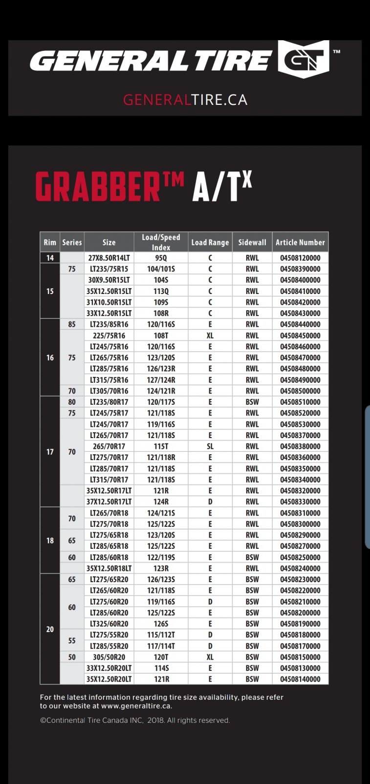

Just put mine on yesterday, so my first hand testing is yet to come, but I did ALOT of research and I ended up with the new General Grabber ATX. (275/70/18). They are heavy, LT, E range tires, but are M&S, 3 peak, and studdable. Not tons of reviews out there yet, but enough to satisfy my OCD purchasing requirements. Check em out.
Will be interested in hearing how you like them in winter. Will be needing some tires on my pickup in the few months and was considering these as one of my options.

Your load range rating on the sidewall can dictate that "lighter" feeling. The ones that were on there were likely a load range E and had a stiffer sidewall while the smaller tires likely had a lower load range and can feel a bit "mushier" because of that. The taller tire can also effect your gearing ratio and therefore fuel mileage. The General Grabber ATX gets great reviews from a friend of mine that likes to go to some of the out in the country passes and he said he has great handling in the snow and on ice. Not studded. He was just telling me that last week.

My favorite part of my research was the custom offsets AT reviews where he said all of their dads run ko2s. Lol. After TONS of reading/watching, I decided the ATX is the new ko2.
My oh my, they say imitation is the sincerest form of flattery! Look at the treads on that new General tire, almost a mirror image from 3 feet away! Looks like after 2 years the KO2s are no longer king of the hill, their numbers are down on Tire Rack compared with early 2017.

They really are a total copycat. Lol. It's the silica compound (duragen), I think that got me. It's said they wear like iron. Also studdable (not that I'll ever use it), and the $100 rebate didn't hurt. With that and tirebuyer coupon codes I landed at $173 each including mount/balance/disposal. I could resist no longer.

So far so good. The shop said easy to balance. I've yet to align :oops:...but will have my buddy check the Tirebuyer's "installer" balancing to verify when he aligns.
No road noise to speak of. A little "siren" kind of sound with all 4 windows down accelerating from a stop or turn, but man, they're quiet.
Haven't had any real snow, but the little we did get, they were great. Couple rains, with 0 traction loss. They look pretty mean in person, too.
I cranked the keys a touch more and will settle them for final measurements and then align in the next week(ish).
Also will add some red for HP gains to make up for the mpg loss ( approaching -2).
