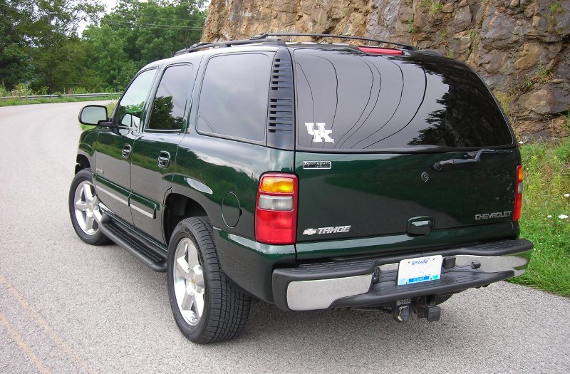

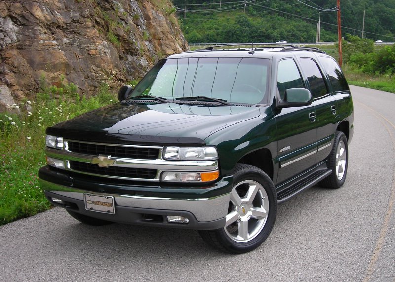

So many things I liked better on my former 03 LT…especially the seat comfort and the folding mirrors, etc. Really, the only upgrades from the 2015+ platform that meant anything to me was the Nav / backup camera and electronics. This will be my last Tahoe as even setting aside all other issues, I can’t adapt to the 2021+ styling…looks too much like a ford for my tastes.
