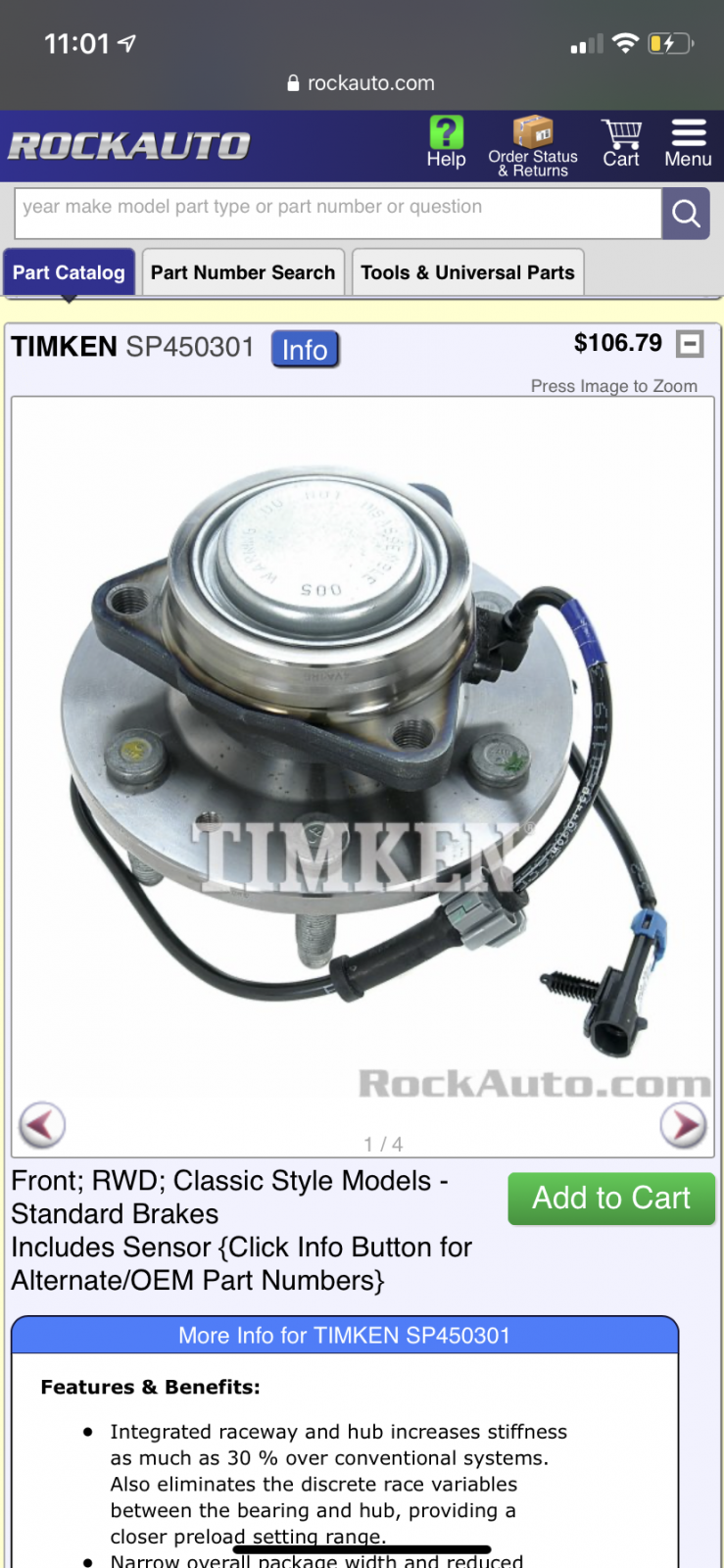

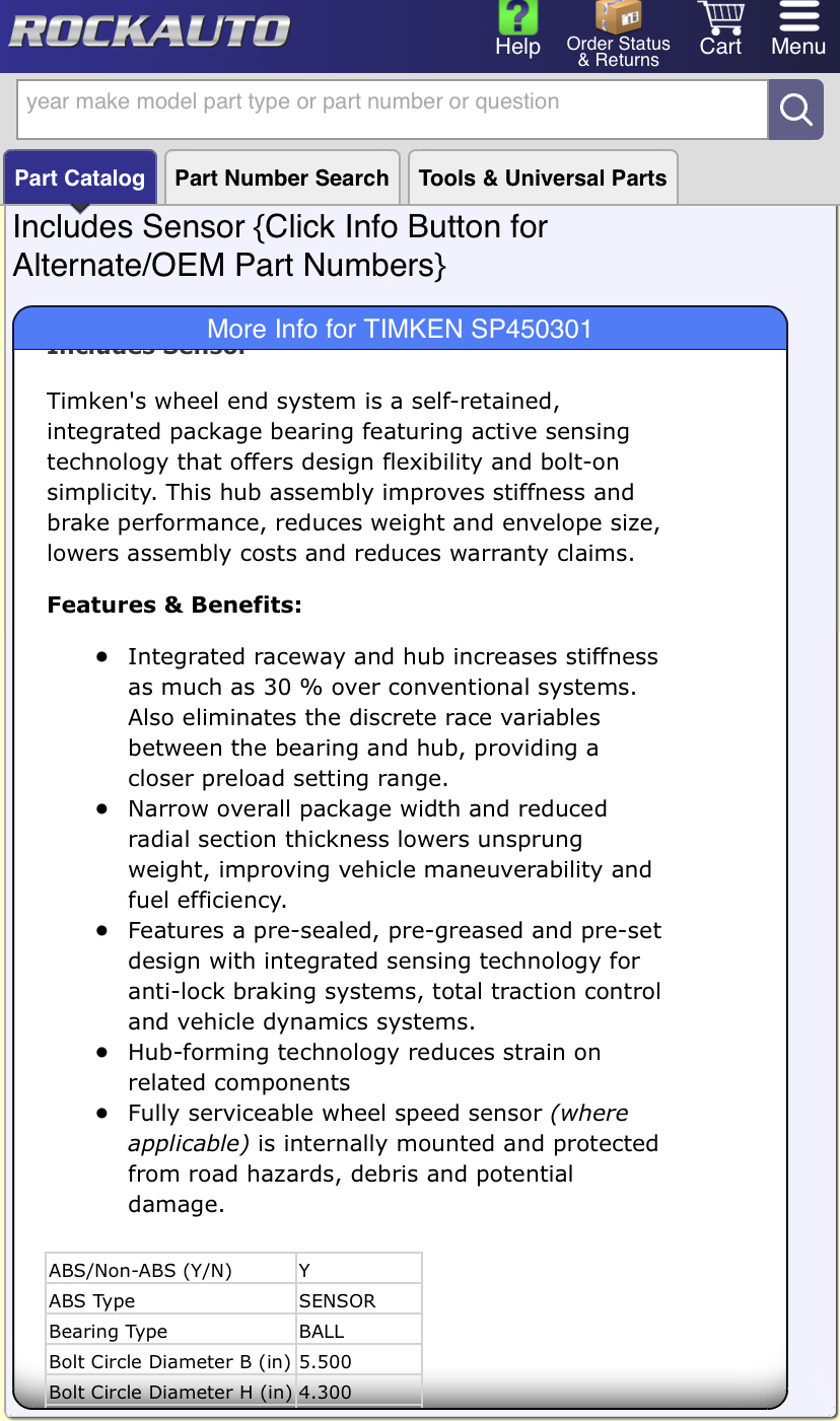

Rock Auto has the Timkin hubs. They say “Standard Brakes”, but are for ABS. They have the speed sensor and even spell out that they are for ABS in the info box.
