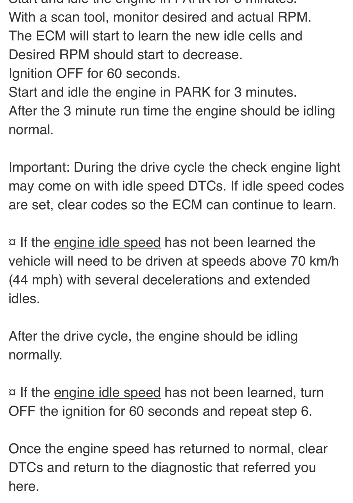

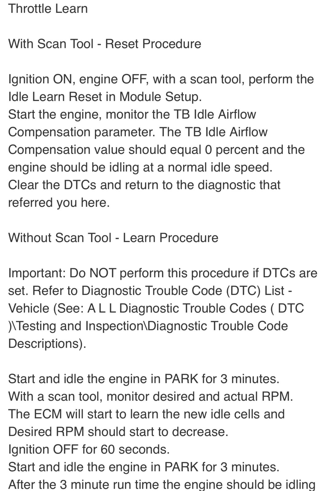

There is an idle relearn procedure, disconnecting the battery doesnt do it. You are supposed to do it right after cleaning or reinstalling tb. Although I remember i read that if you you don’t do it immediately now you have to drive a while a different speeds for a few days, weeks and it will ‘relearn’ that way. Give it some time. Ill see if i can find the procedure
