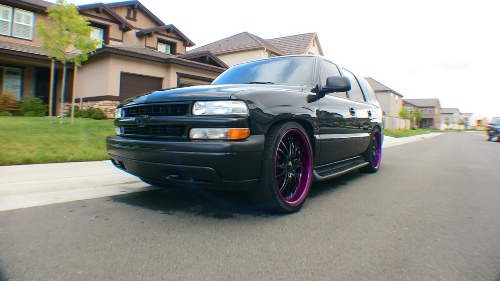

Did the box weigh yours down to 30.5? Or what else did you do to lower it?

dude will i finnaly tell these people u bagged ur shit already! damn
aired out hes 26.5ish

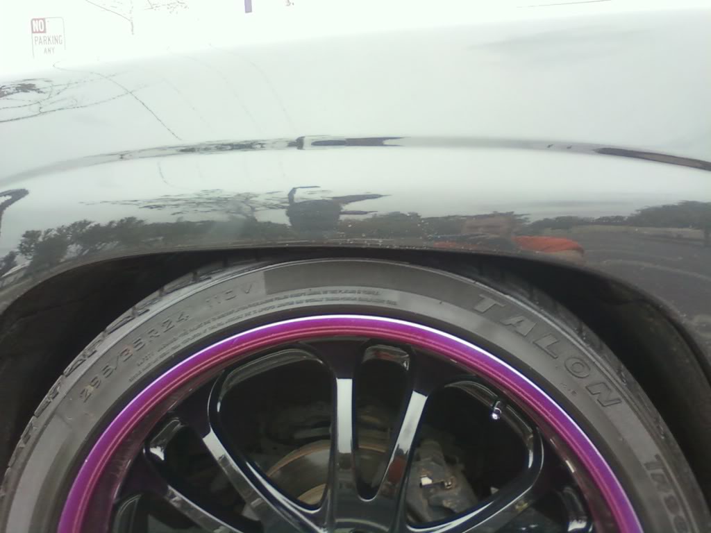

Damn that ** is nasty low, my lowest ground-fender measure is 33.75 haha, 3.25" from you, too bad the NNBS Tahoe cannot go lower that 32" without bags!

Did you cnotch it too? Because the way mine sits, I only have 3in of travel before the axle hits the frame.

Your panhard bar is pushing the one side of your truck farther over than the other side, removing a small amount of material from the middle of the panhard (track) bar and re-welding the bar will pull the axle back to center between the frame.
