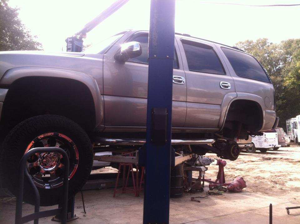

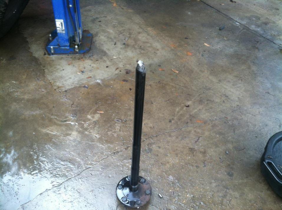

so it ended up not being my gears, but my axel shaft snapped.
i can't get a new one in till wednesday :/

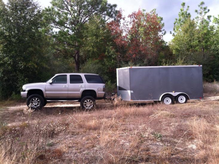

Do u tow a lot or pull heavy loads in it? That's the only thing I can think of that might case some stress on the axles aside from the bigger tires. 4.56's will be a great upgrade

i was pulling out of my friends back yard on to the asphalt and got some wheel spin, then when my big ol' 37s grabbed the asphalt there was no forgiveness. But its all good, live and learn haha
on a weekly basis this is my load
(older pic so truck looks a little different)

Towing on uneven dirt roads and off-road is hell on the rear end. Upgrade for sure.
