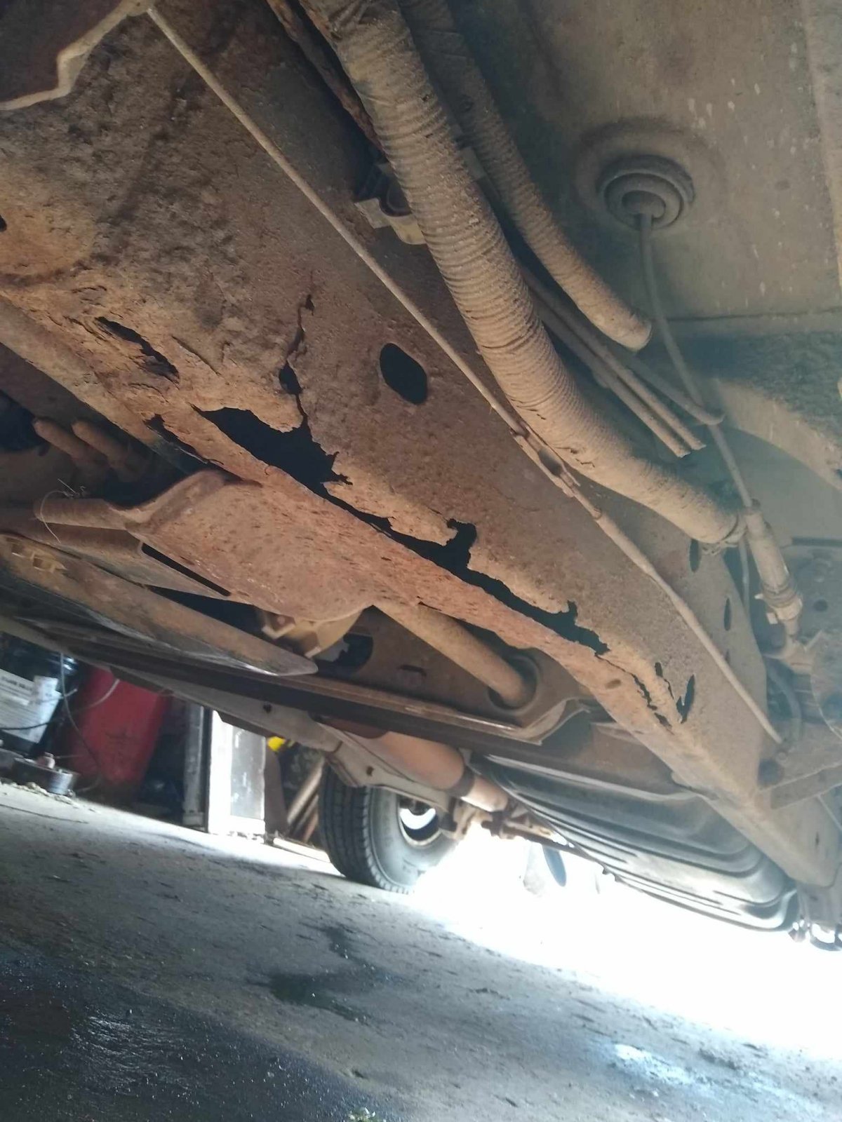

and now my more long term project
1968 beetle
not a lot of progress on this one but i am having to redo the body work on the passenger front part of why i got the tahoe so i can practice on that
all these lap welds need to be but out as it was just rusted metal under them
and some never installed carpet that is very dirty but got for $50 the whole point of the beetle is i am trying to do it correct but also keep it period and low cost
Mater
Mater
Nov 26, 2023
52
100
You can see that passenger rail and it's perfectly solid.
I always suspected it pulled a boat and boat launching did it in at the rar bumper was also really bad and both lower rear quarters where replaced at one point as the body fully was cracking through.
