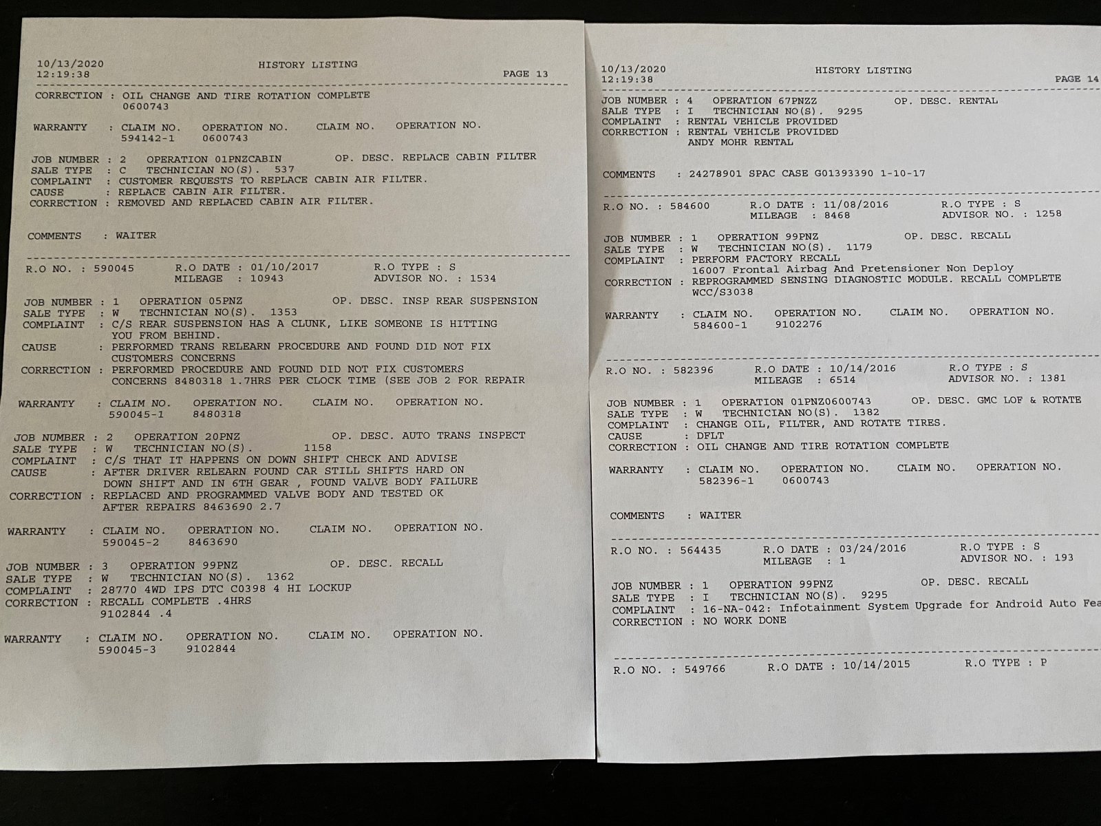

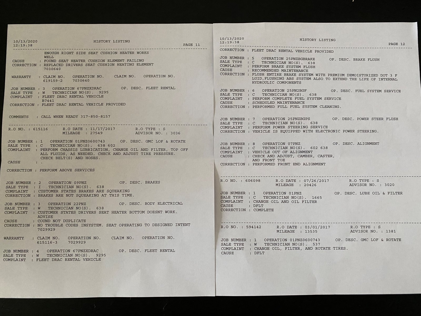

I really appreciate folks taking the time to read this and give me there values opinion. It looks like a valve body was replaced in the trans @ 10k. However I do not see the TSB flash and different fluid installed to correct shuttering problems ( I may have missed it). I hate going to stealerships but I think I might have to to get the flash done and fluid and filter changed. Pics coming very soon...

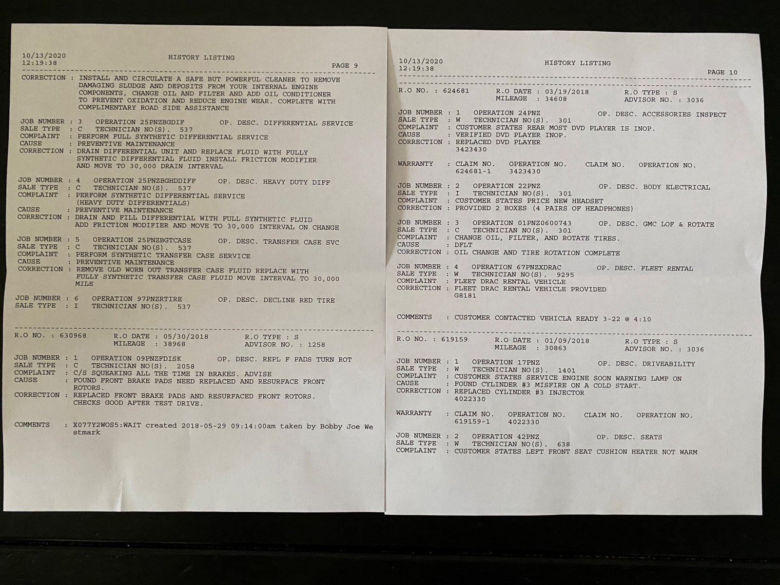

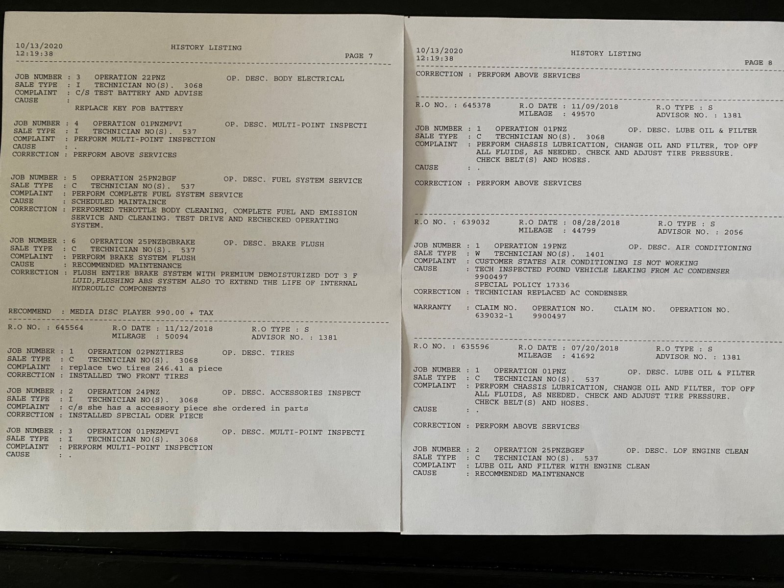

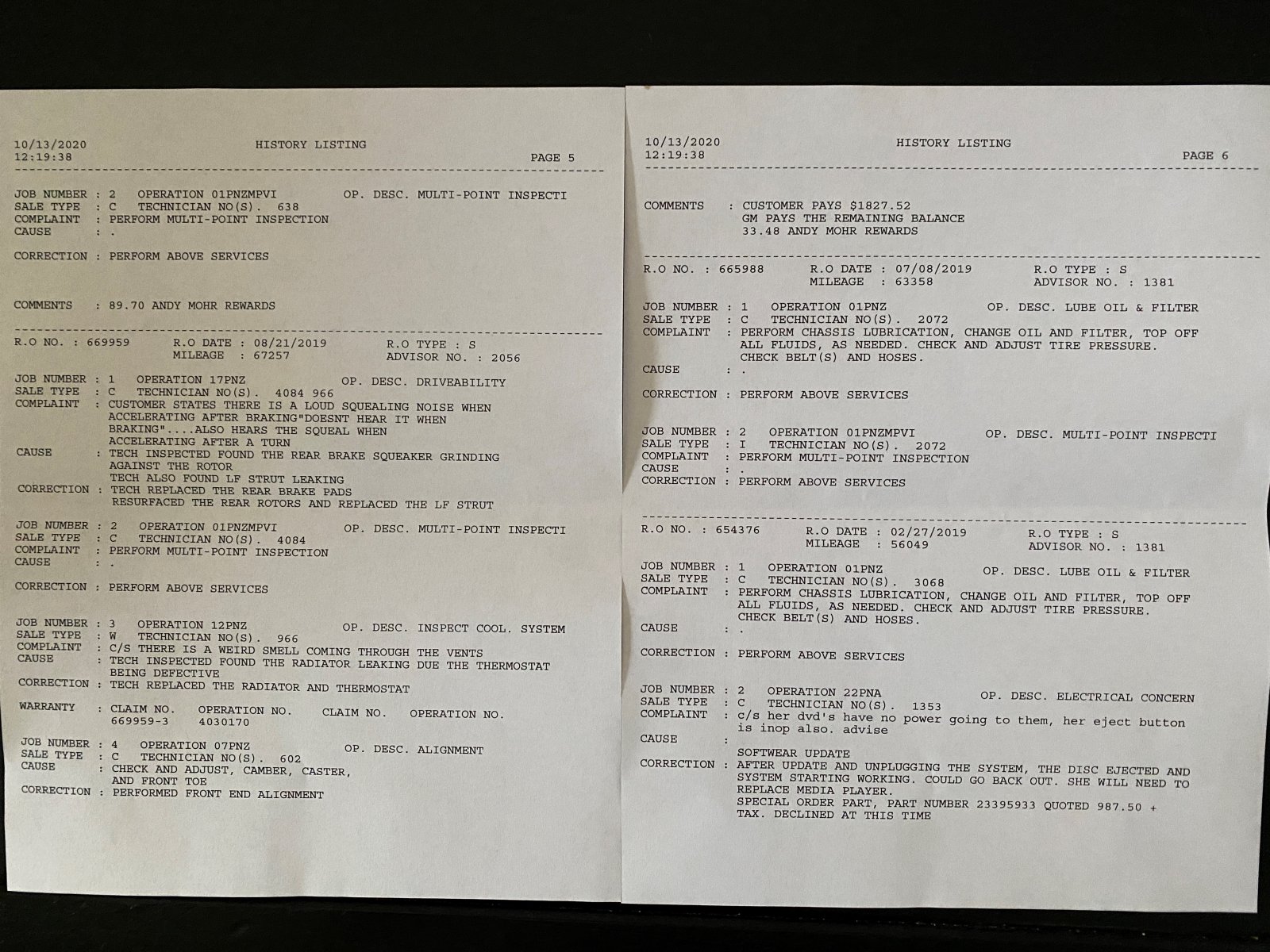

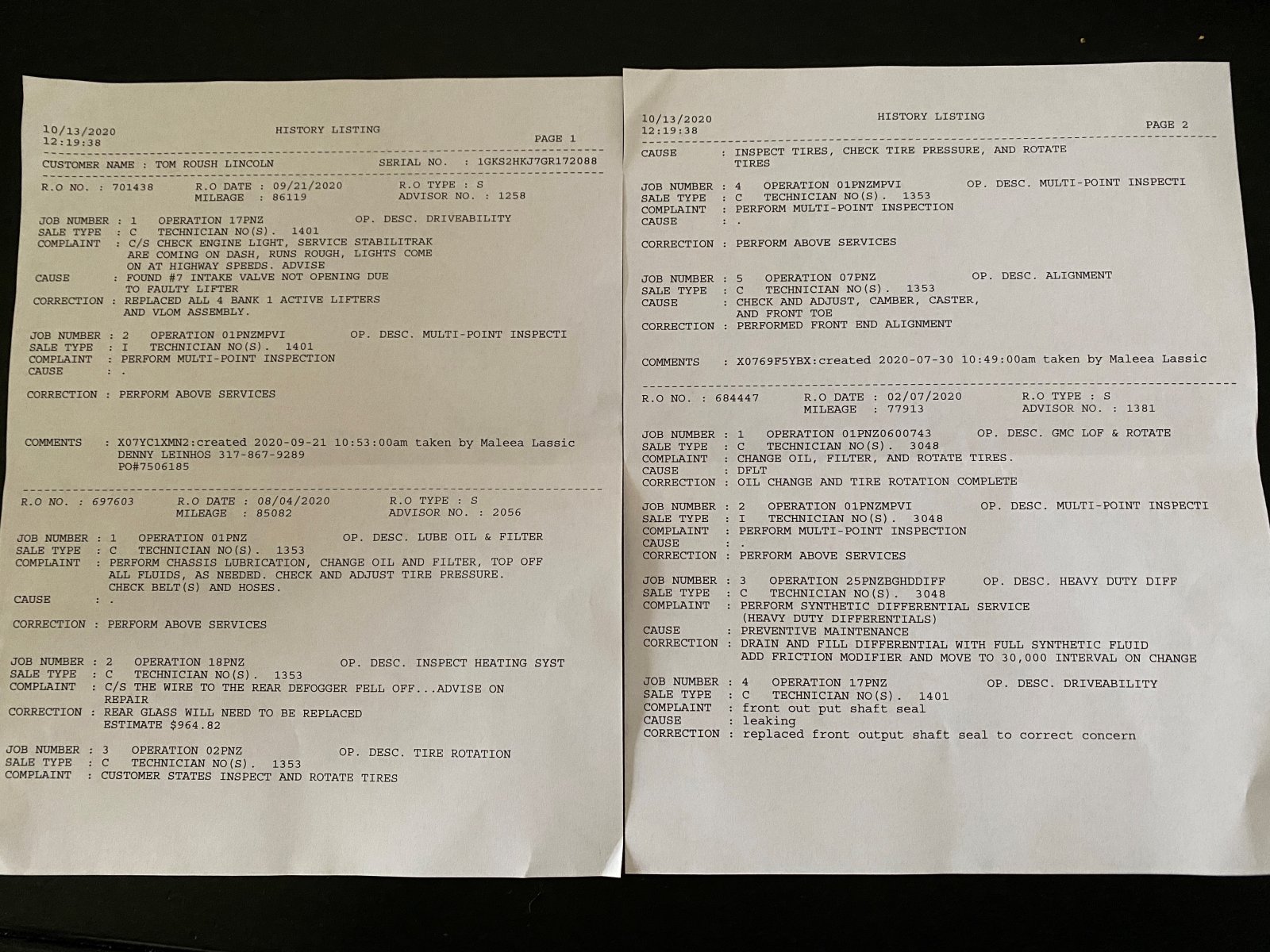

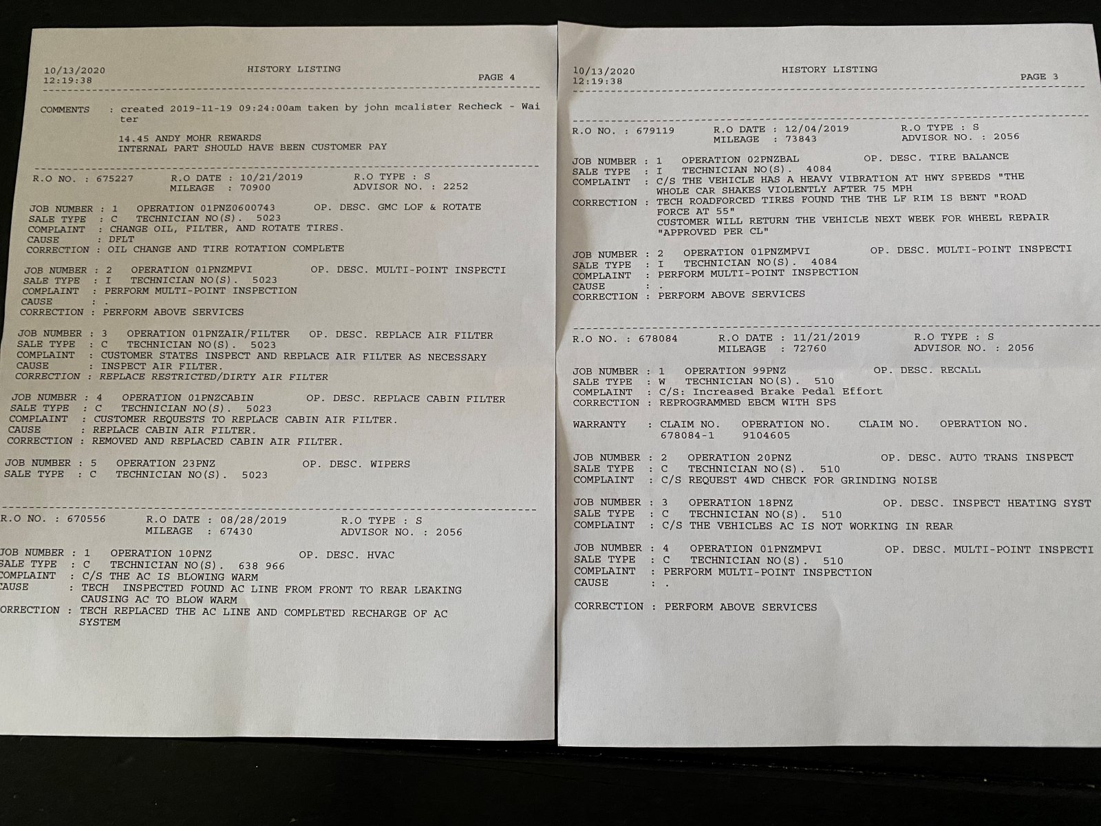

In my opinion of course. But it looks like the PO took it to the dealer for every maintenance schedule and complained about any issue they had, and paid for the dealer to fix. They replaced the AC condensor which I hear is a good thing because it is a high failure item.
If everything works now and is in good shape, I wouldn't sweat it. I didn't see anything in the report for major engine/mechanical problems......
I just bought a 2015 and have a similar report, with a few modules replaced, shocks, all brakes, rotors, ball joints, etc.
30,772
48,476
looks like most of that is just regular maintenance, needed an injector, needed one side lifters, seat heater, some dvd player issue, ac repair, couple recalls were performed.
borderline excessive, 2016 L86 they made changes in mid 2015 so right on the edge of new model year.
the good news is they at least took care of it, many do not.

It did shutter the day after we brought it home, but 595.00 later for transmission flush it runs great. The lady traded it in on a black beauty navigator

She needed front brakes @ 38.968 She must of been a lead foot lol. Seriously though after the Mobile1 ATF change and the lucus oil fuel treatment this truck is a beast (providing you drive in tow/haulass mode with TC off)
