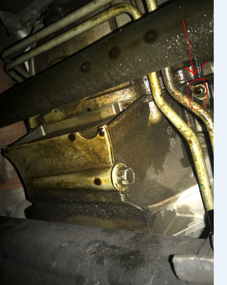

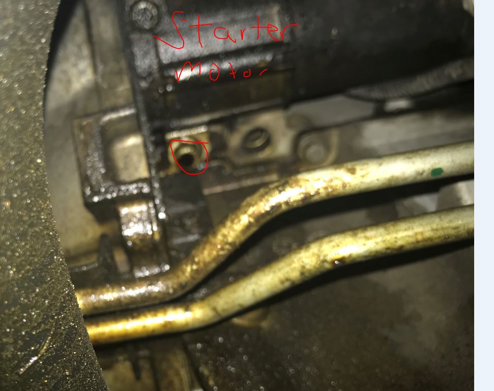

Ok, so I'm back. I decided to take a picture or two of the general area as I'm starting to really wonder the cause of my leak. First, the leak is only on the back portion of the block/bell housing. No leaking from the oil pan in front of the housing. So either my leak is the oil pan at the rear OR the rear main seal. That's my conclusion thus far, but I've never removed the housing and don't know what more could be in there.
What has me puzzled is I noticed some oil also on a bolt that attaches the starter motor. See my attached photos. This higher oil leads me to believe the leak is higher than the oil pan--likely rear main seal.
Would appreciate your thoughts from these pics. Sorry my 2nd pic isn't in focus.

take that inspection cover off the tranny to engine, you can see if its wet up to the crank and leaking out of there.

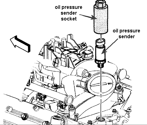

id think its a oil pressure sensor leaking, or the back of a valve cover. its behind the intake manifold, see if its wet up there with oil.

Ok. Just got underneath with a bright flashlight and confirm it is NOT valve covers. Could see the underside of them from the below block view and I see no oil coming down. Oddly this is high enough to oil up the starter motor, so either the oil pressure sensor or rear main seal. I just can't see or feel back where the oil sensor is cause I don't' know were it is. Do I have to replace much of the intake to get to it?
