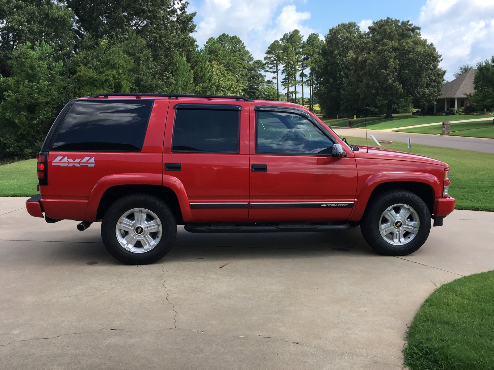

I thought this would fit better here rather than in the 2000+ thread, since it is the 5.7 square body style. I have a 2000 Z71 Tahoe. 150,000 ish miles. Bought it July of 2018. Clean carfax. Drove fine for about a year then the electrical zombies and gremlins surfaced. Keep in mind I have done nothing to it or made any modifications, other than replacing the fuel pump (ac delco) and some of the front end components. They were ok but just wanted to have a little new stuff in those spots. And replaced the wheels. Originals were awful. lol.
