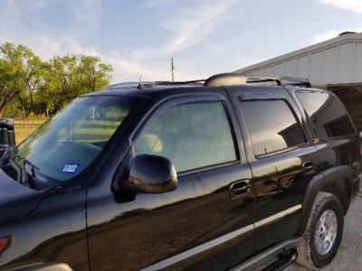

I also installed some cheapo wind deflectors from Amazon. The whole set including the sunroof one was around $40, but I wouldn't recommend it, they're probably not going to last the summer. I think I'll pick up the AVS brand to replace them in a few months.
