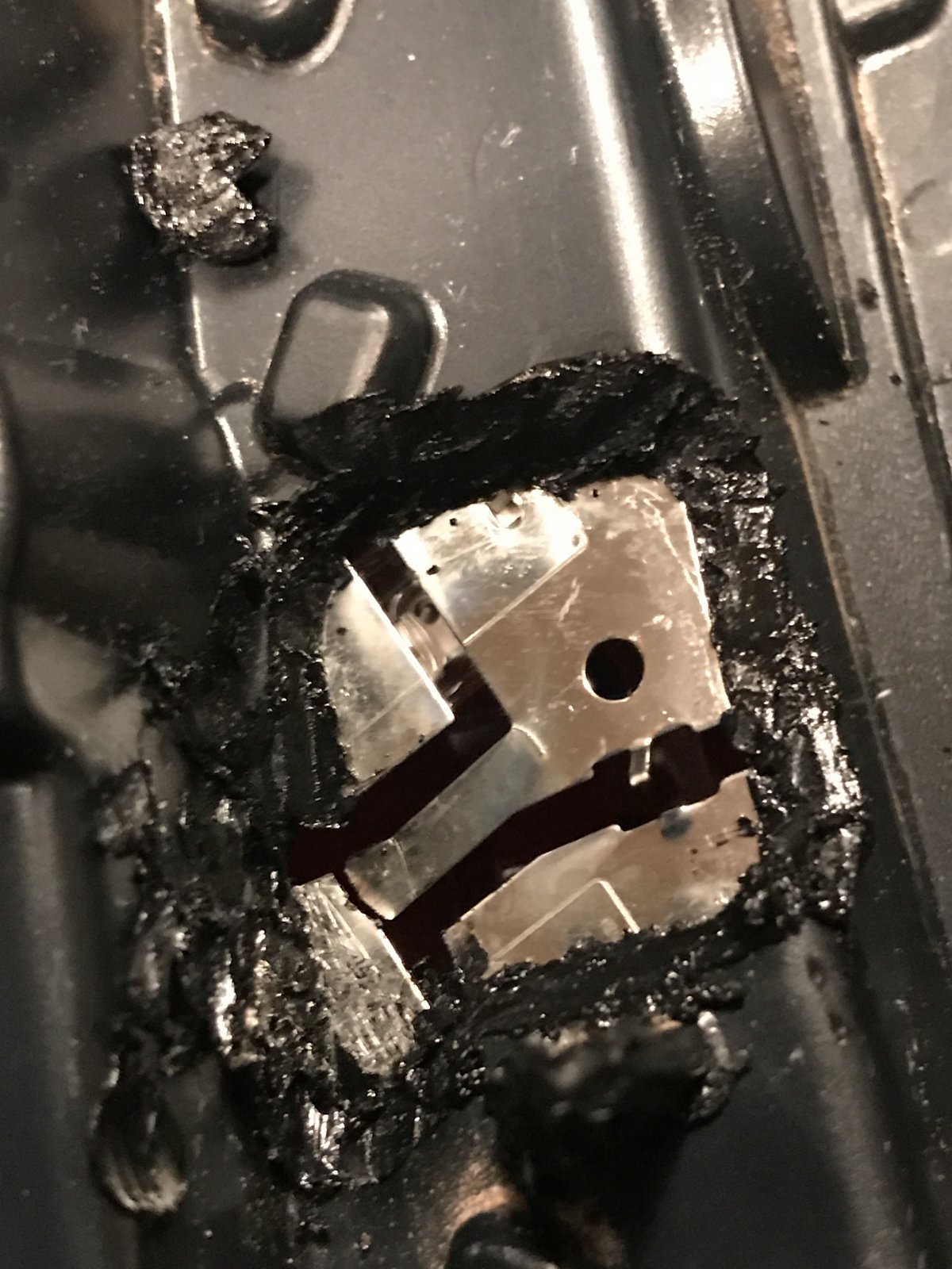

My other taillight caught up with the other I was having intermittent issues with, so I couldn’t not have primary brake lights. Gathered up some soldering tools last night and fixed one.
Here’s a look at the part that breaks:
Perhaps this is useful for someone interested in repairing their own. I’ll spare you the repair - I don’t have soldering experience and it’s apparent in my final product.
