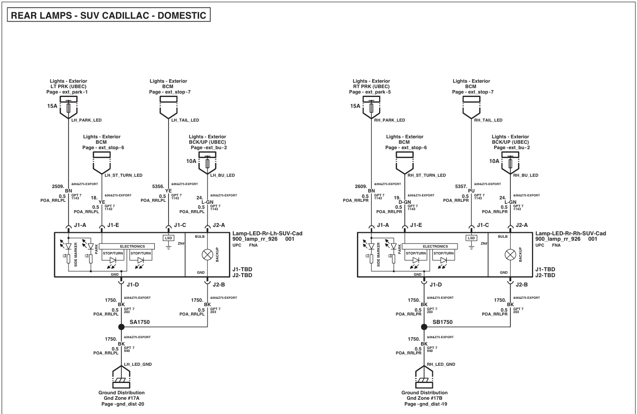

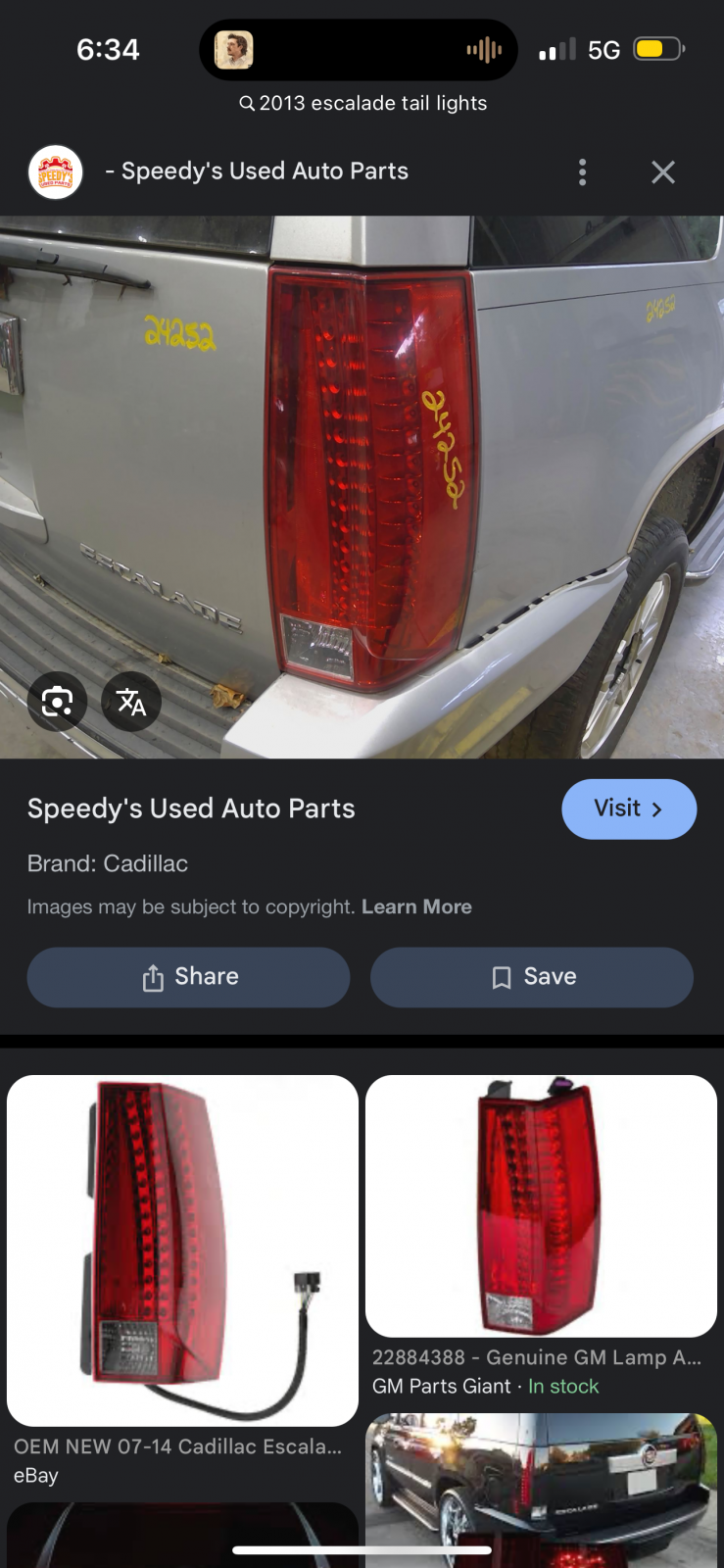

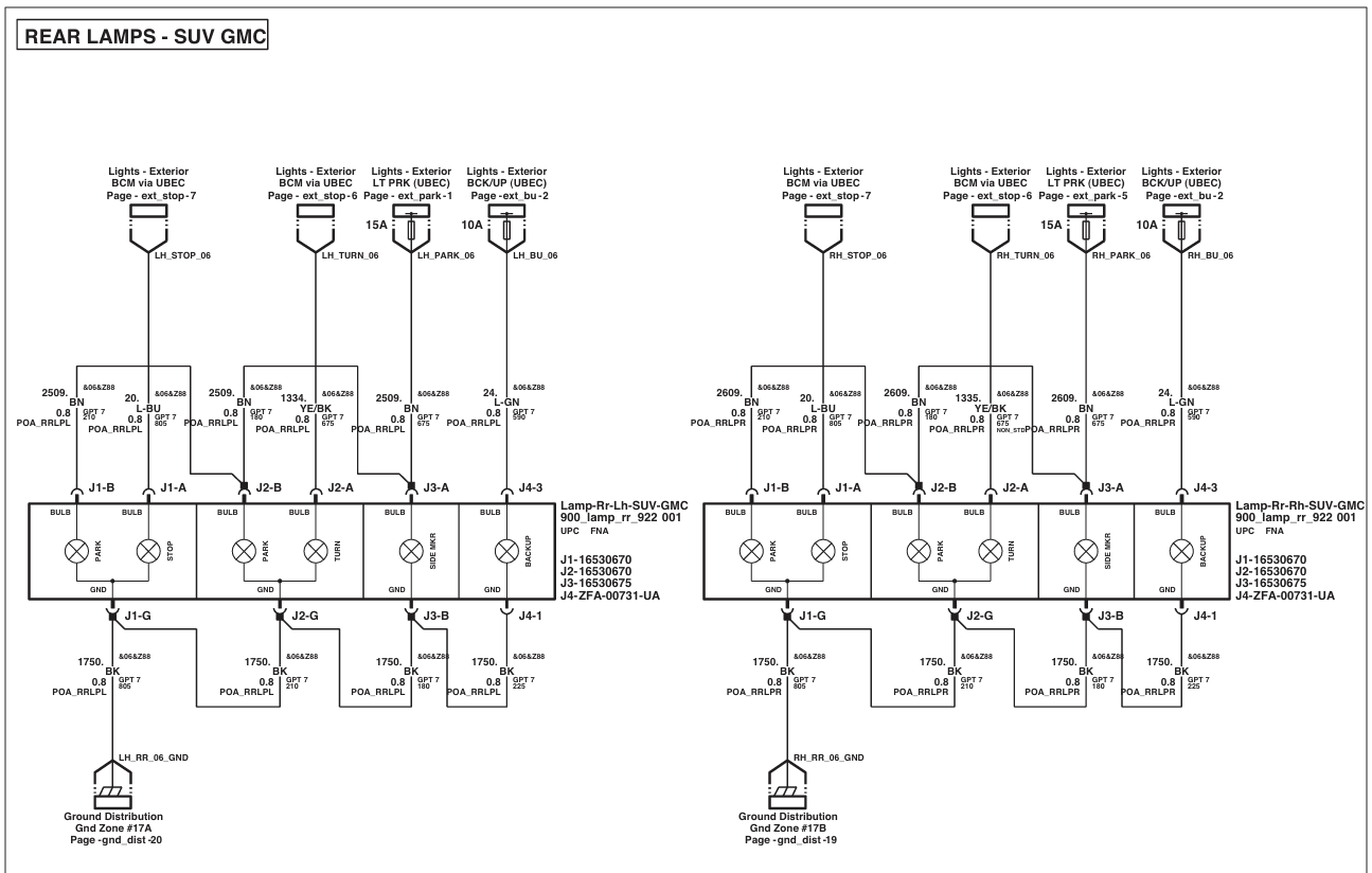

i bought 2013 cadillac escalade tail lights for my 2013 yukon denali, the wire that comes from my truck is 5 pin and the wires that come from the cadillac tails are 6 pin how do i get the escalade tail lights to work
