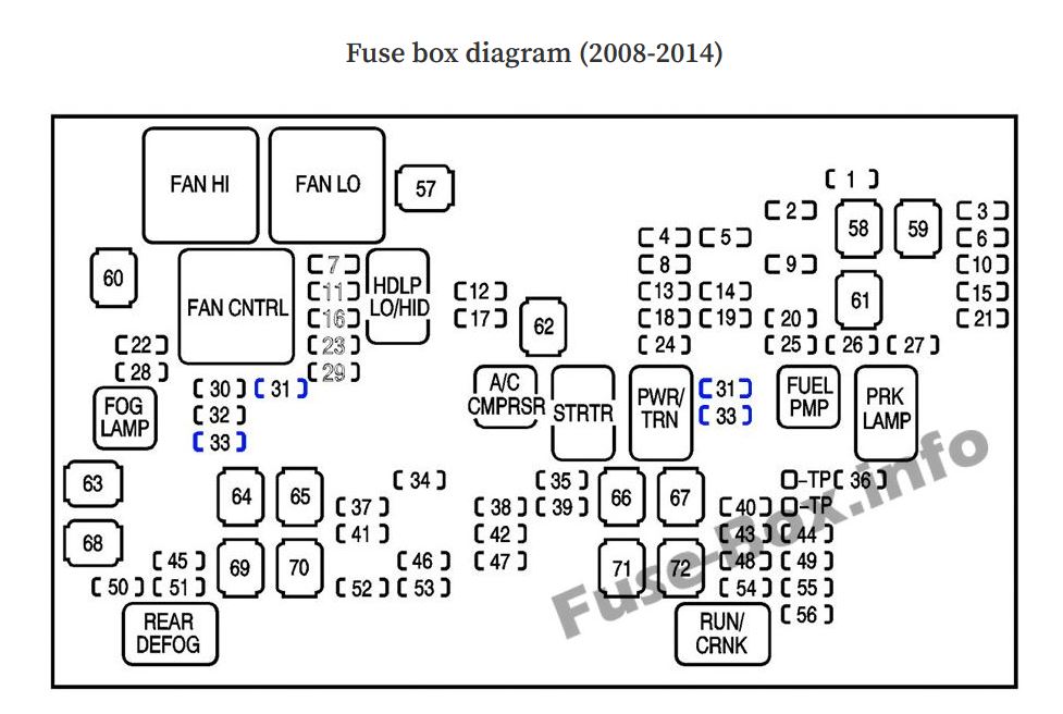

Do the front parking lights illuminate when the headlights are on?
With the headlights on check the voltage (in and out) and the pin fitment on fuses 26 & 27 in the underhood fusebox:
There is also a Park Lamp relay in that fusebox to check.
If all that checks good, remove one of the taillights and check for voltage and ground on the taillight circuit. If no voltage there but the fusebox tests were good, then pull the top of the fusebox out and check the underneath connectors for corrosion, pin fitment, and rodent damage.

I just checked and the front parking lights do not turn on
