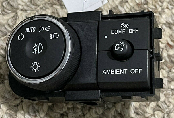

So I just recently bought a 2014 Chevy Tahoe police interceptor, I can’t for the life of me figure out how to turn on the fog lights, it has them there the whole assembly is there, but there’s no switch anywhere or anything with the fog light emblem, I’m thinkin maybe the center console the interceptors have when theyr being used for the police possibly had a switch on it an when they removed everything out then there went the switch?

It's right below the dimmer control knob

My SSV didnt have foglights when I got it - had the blanks in place. In my case, seems the wiring is not there (havent taken the entire bumper off) nor was the headlight switch that contained the button installed. I did replace it with one that has the switch but still lacked the wiring. I believe mine may be disabled in the BCM as I dont have DRLs/auto headlights either.

My 2014 PPV didn't have fog lights and from what I have seen the PPV/SSV's tend to not have them. Departments typically install emergency lights in the fog light space. I installed fog lights on my 2014 outside of the factory headlight switch which I changed to the fog light style and the bcm was not programmed for the fog light option. The factory relay was in the fuse box but the fuse was not there nor was terminal populated with the wire to power the lights. Unless you have the ability to program the bcm and ecm, in my opinion the easiest way to have fog lights is to wire them with a switch, relay, etc.

You most likely have LED flashers/wig wag pods installed in the fog light spots and they aren't actually fog lights. arent

You can easily run an external rely harness and tap into the marker light to add fog lights, I did it on my 9c1 impala and worked great. That amazon kit will install, but you'll still need the BCM flashed to enable the fog light option.
