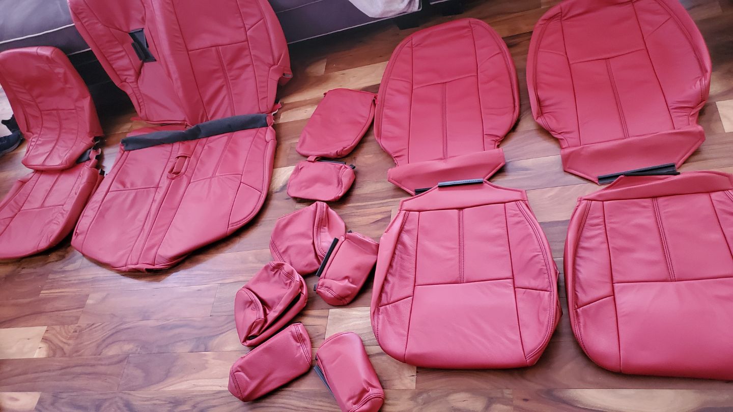

I ended up going with Custom Factory Interiors (aka Leatherseats.com) as my supplier because i've worked with them on multiple projects in the past and both their product and service rivals the best in the business. I deliberated for months over what color theme to go with...for the longest time i've wanted the baseball-glove leather but it just didn't work with my black-with-red-accents exterior theme so I decided it would have to be some version of black with red. It came down to either black with red stitch, black with red inserts and red stitch, or, the ballsy-est route - red with black stitch. I even surveyed my family and friends to get a bearing on what I would probably be happiest with over the long term. Black with red inserts won, red with black stitch came in a close second though. So I was all set on black with red inserts until I realized that i was not going to be able to achieve red stitching on my dash project (see thread)...my sewing equipment that had worked in the past on my WS6 and Z06 interiors just was not able to reliably complete the 5ft long stitch I would need across the dash. So at that point I said F-it, i'm going all red. I did the lower dash in matching red vinyl and ordered the seat kit. They quoted me three weeks from start to doorstep, and it actually took two weeks and two days.

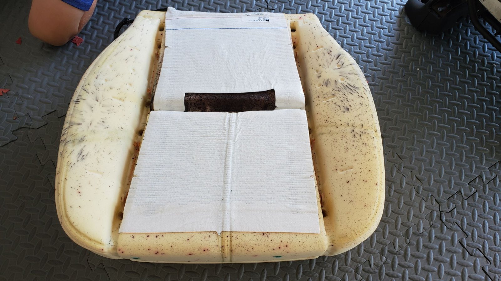

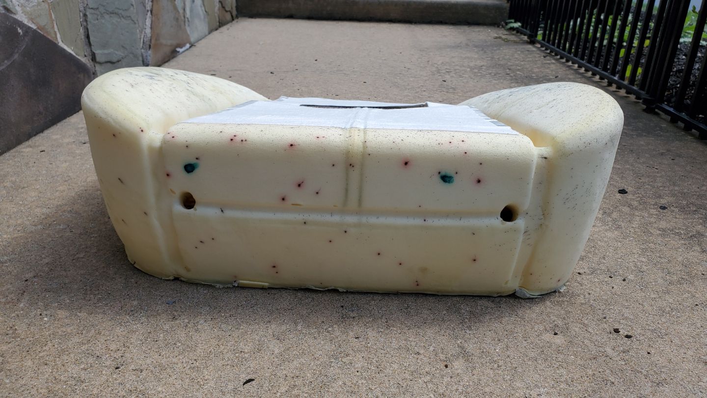

When disassembling the seats, I steamed each cushion. This is especially important on the front base foam because it's going to be very compressed from years of being sat on. Steaming is a nice cheap way to restore the foam to like-new condition so you don't have to spend $100+ on a new cushion (or many). I picked up a used commercial steamer for $36 shipped on ebay and steamed all the foam.
Driver's cushion before:
Notice the left bolster is deformed and flat, with deep indentations from the leather seams.
After steaming - notice the bolsters are back to original shape and the indentations from the seams are gone:

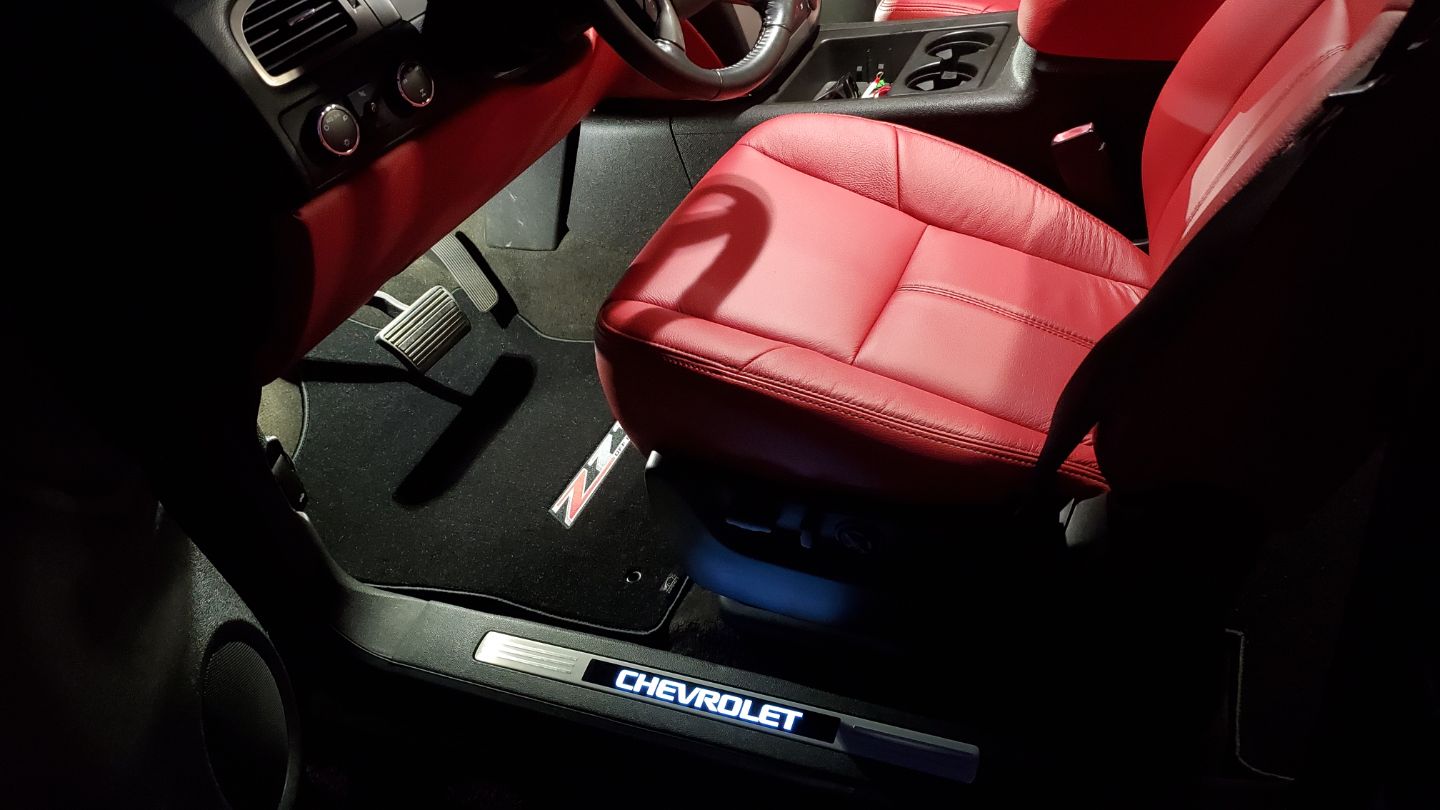

(During the interior reno process I also installed the lighted door sills, Lloyd Z71 mats, and footwell lighting but I don't have pics. I'll get them ASAP and they'll go here.)
That color combo looks badass.

All leather tops. It's their "Premium" content setup, so only the sides and backs of the seats are vinyl. So basically everything on the top facing surfaces out to the edge french seams is leather.
I went with their standard leather cause this is a truck, and I use it like a truck. What they call "Ecstasy leather" or Katzkin's version - "Tuscany leather" is for luxury cars...it's much softer and doesn't hold up well to abuse. Their standard leather is a major upgrade over what comes stock in our trucks (it's arguably nicer than my XTS Platinum) so I can't imagine you'd find yourself missing the ecstasy stuff.
Color is "Red". I got samples of "Bright Red", "Red", "Cardinal", and "Medium Red"...I had originally chosen "bright red" but I was afraid that would be retina-melting in large amounts...even with the regular "red" it still turned out brighter than I expected. I could have gone with "Cardinal" but the sample looked too brown in sunlight. So i'm pretty sure I picked the one i'd like the best. "Medium Red" is real dark...I would have been fine with that too but it would be too different from the red on the exterior.
Cost was just under $1k cause I only did two rows. It is possible to order just one row so I might decide to do the third row at a later date. I just couldn't see spending the extra $400 because in the 7 years i've had this truck, i've used the third row three times and that was 5 years ago. Plus I figured two rows would give me all I could handle in terms of installation anyway. My hands were so sore by the time i got to the last part of the 2nd row that I could barely work.
The biggest lesson I learned is that it's not nearly as hard as you'd think. There are so many pics of hack job installs and if i'm being honest, those guys should have known better than to attempt something like this. You have to really not care and rush through it to make it look as bad as some of those look. Seriously, all it takes is patience. Don't worry about finishing the whole thing. Pull one front seat, and give yourself a full day to start. Start with the center left-right clip rail and work outward from there, pulling the leather taught as you go. Keeping working the wrinkles out as you go, and by the time you have the cushion wrapped, you'll already have removed all the wrinkles. The cost for professional installation varies majorly by region but the only two shops in my area that would consider tackling something like this wanted over $1k. So it was well worth it for me.
