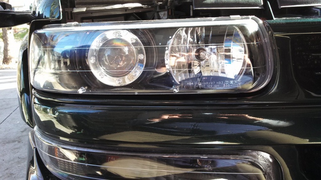

Okay, I'm a convert now. As soon as I get some of my stuff to finally sell I'll be ordering a set of Depos.
Gotta love the nbs! (hate away!):hands:

I know it's not a nnbs, but thanks anyway Serge. Your guide was my inspiration:
