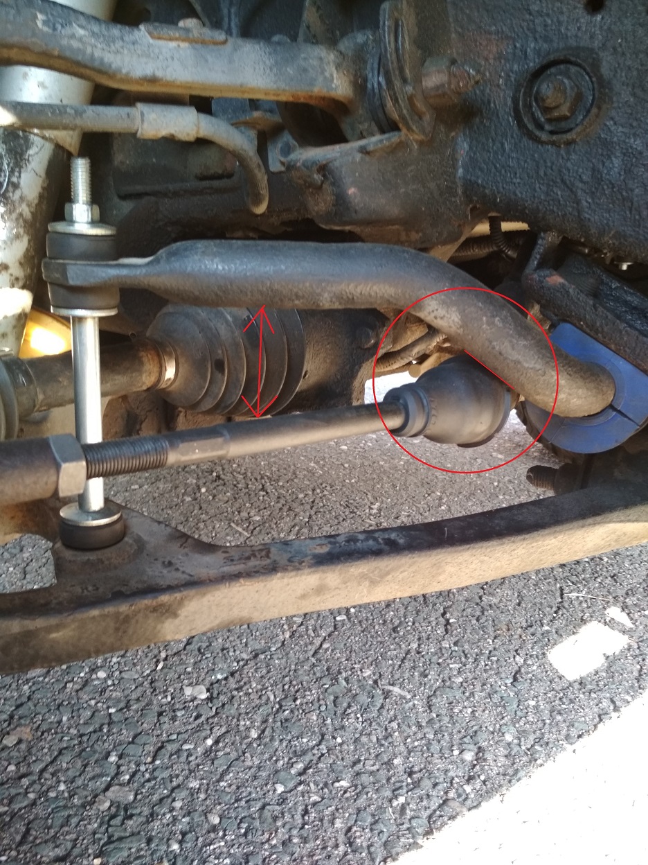

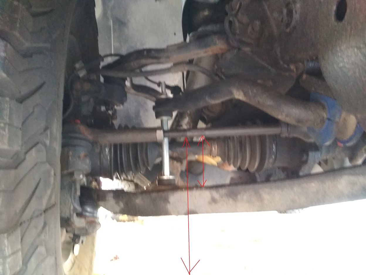

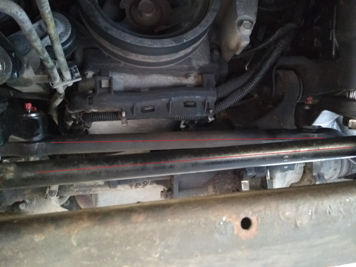

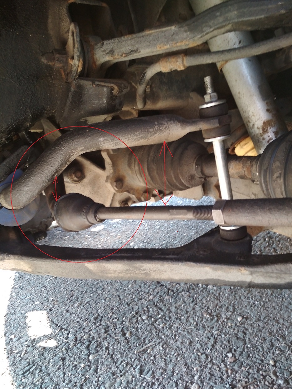

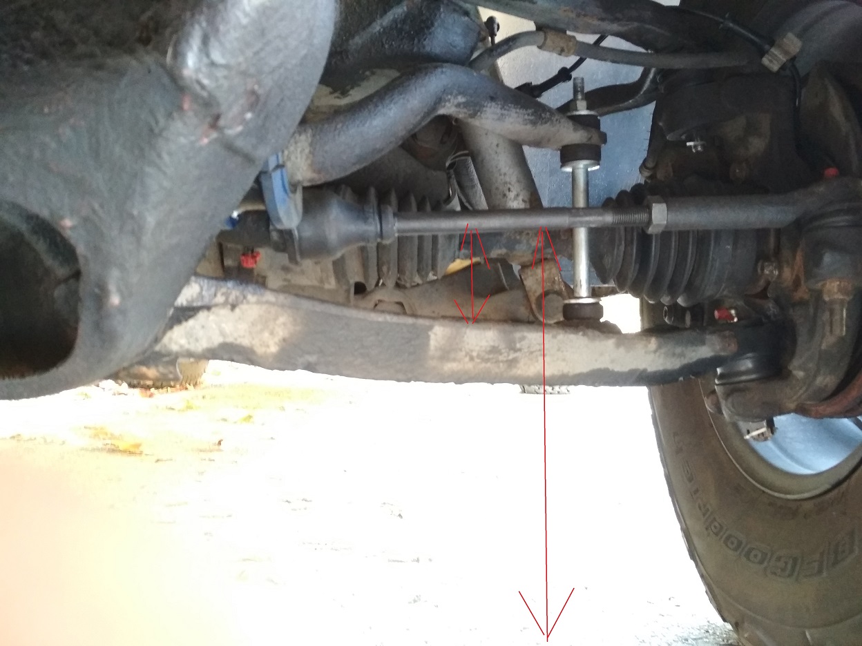

the problem is still going on. I guess I know what's causing a tire problem. But I do not know how to solve it.
The tie rod at the right-hand side, when swung to the right, hits the stabilizer. I do not know why.
I replaced the Idler Arm, Idler Arm Bracket Assembly, Pitman Arm, Steering Gear, Inner Tie Rods, Ball Joints Lower and Upper, Stabilizer Bar Bushing, Stabilizer Bar Link, Wheel Hubs. I have not just replaced Outer Tie Rods.
He does not know why this is so? The car comes to me that it stands straight.
Center Link is oblique, but I think they probably all have it. I can not imagine how to put the Center Link on the plane when only the Idler Arm and its Bracket Assembly are on the problem side.
Photos below.
Thank you Jakub

Did you do the work yourself or someone else? Was the centerlink removed entirely when servicing the idler/pitman? It looks like it was installed backwards and needs to be flipped 180* horizontal. The "tie rod droops" should angle to the rear of the vehicle and your pics look angled to the front. @SnowDrifter has a thread here: https://www.tahoeyukonforum.com/threads/scrubbing-binding-while-turning-at-near-full-lock.86256/ that helped me greatly as mine was installed incorrectly as well when I had front end work done.
Swayi
Swayi
Dec 20, 2017
12
Czech Republic
I can not believe that! I have it the opposite way. I did everything myself and gradually, I never took the center link to turn it. But someone has done it. When I put everything in the right position and make the alignment I submit the information. Thank you very much. I have read that you have solved the problem for 4 years. Fortunately for me only one year is enough: D
