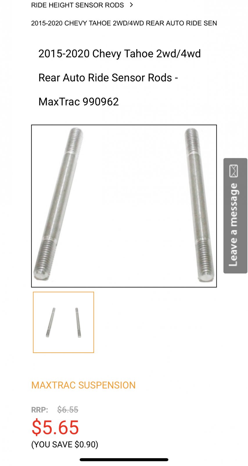

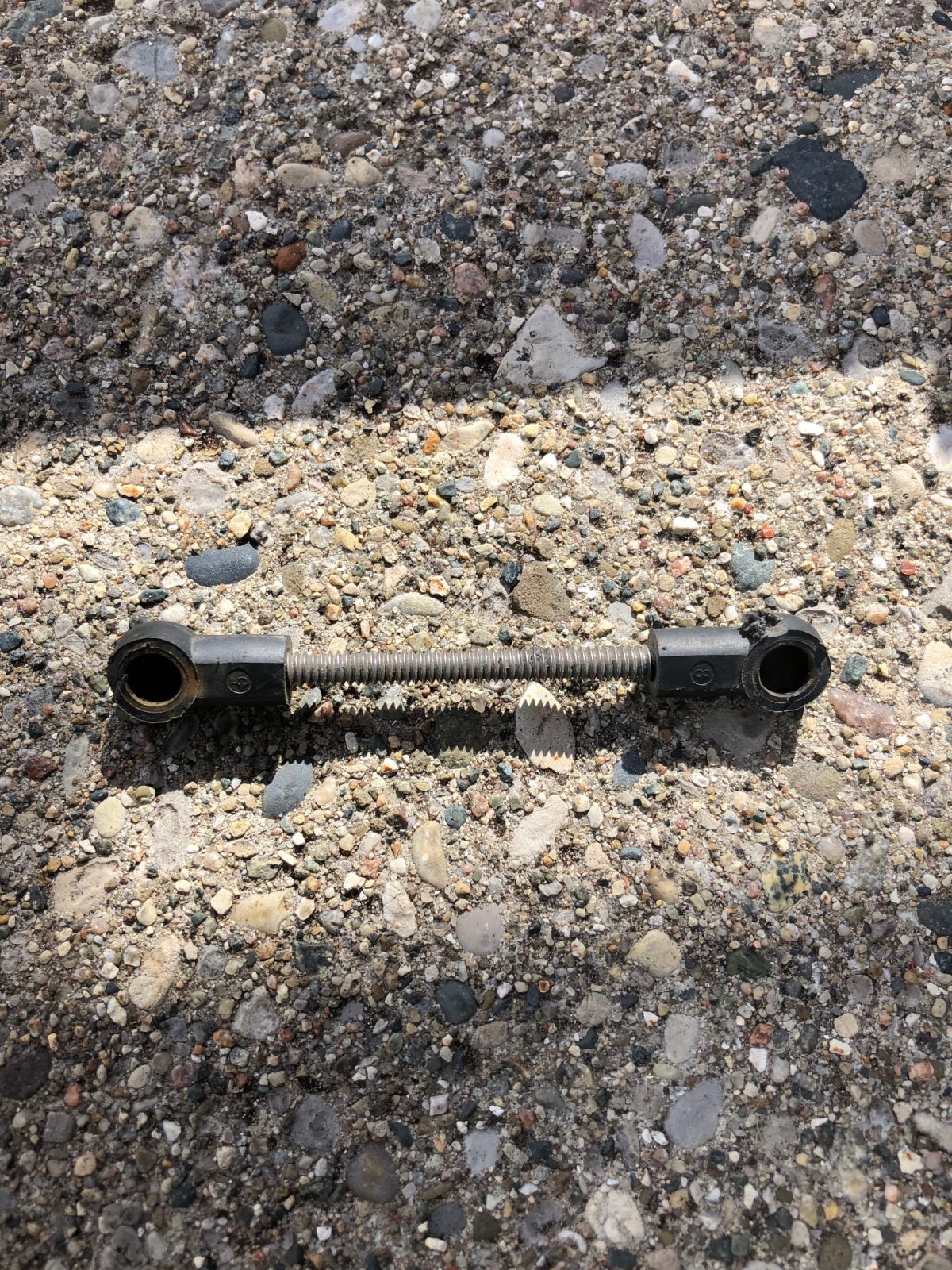

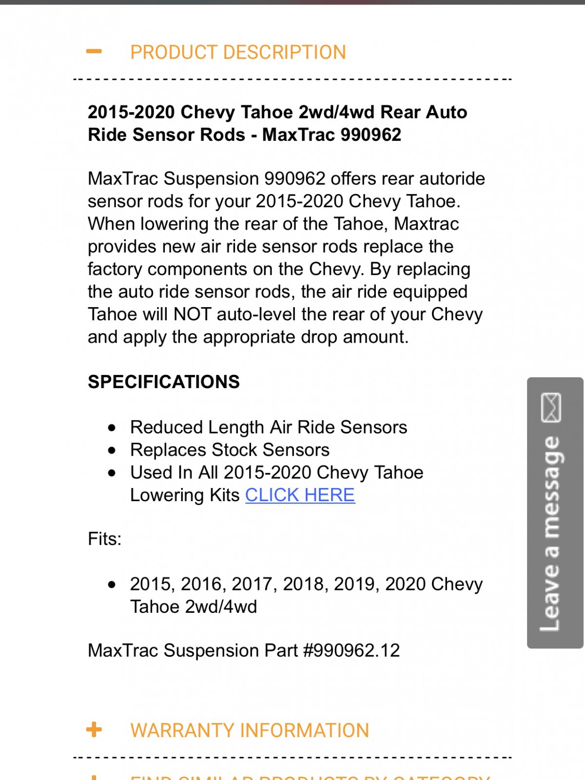

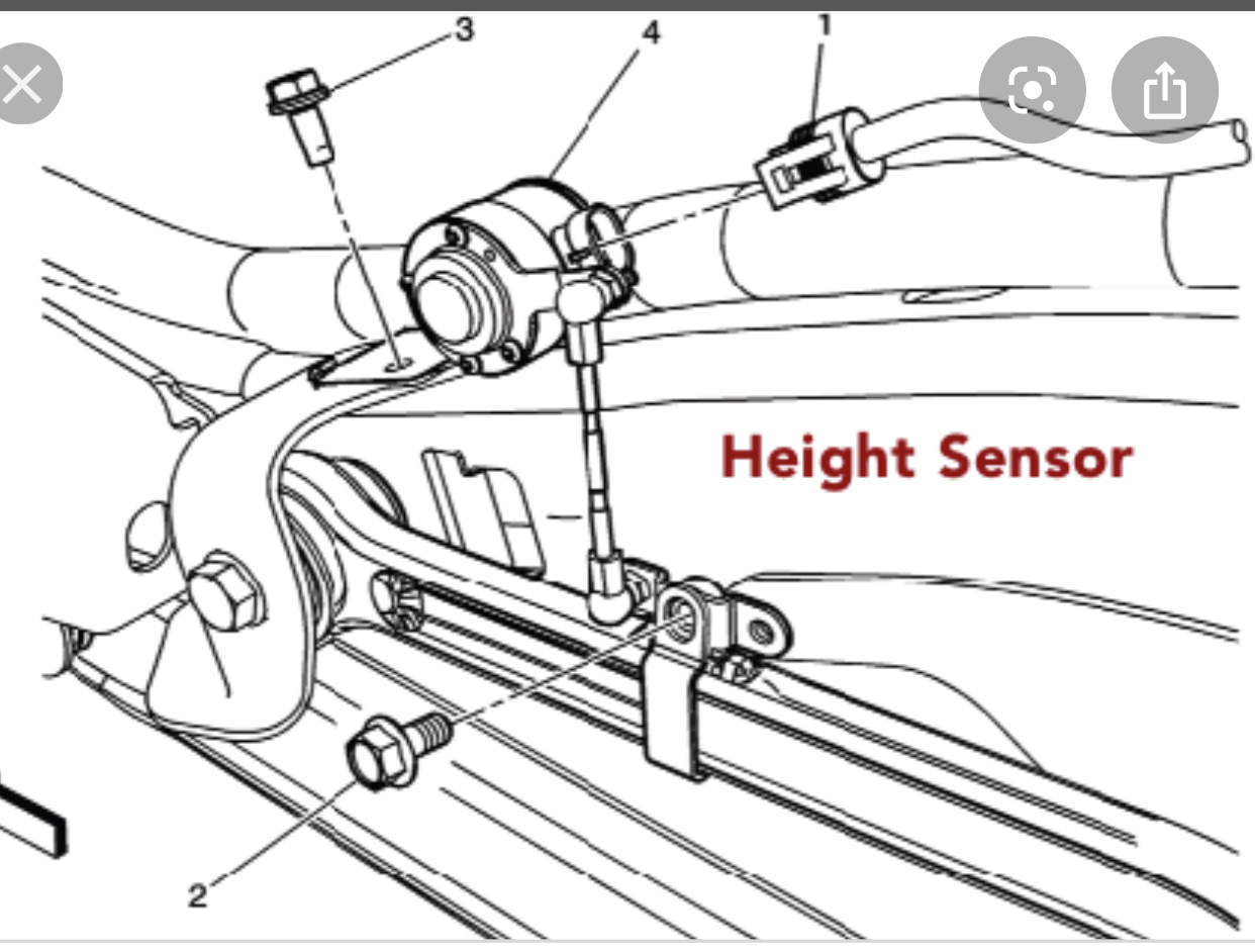

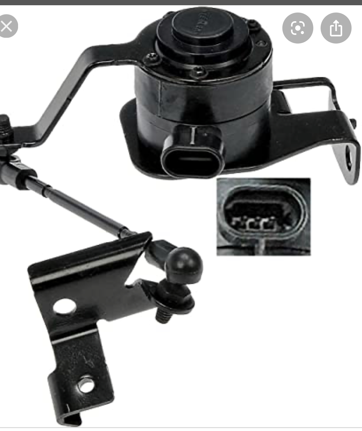

I tried a Belltech 3" rear lowering kit with a 1" spacer on my 2015 with max trailer option, then later tried a 2" spacer. Great smooth ride but a little too soft for trailering.
Then I installed Belltech 5321 2" drop springs. They are a perfect blend of good ride and trailering ability due to their variable rate. The spring specs state "not for use with auto level suspension" but you can disregard that.
You simply need to buy two 1/8" diameter "all thread" bolts from Home Depot and cut the heads off to make your control rods adjustable. Snap the control rod's plastic sockets off their ball mount to remove them from the vehicle. Then pull the plastic sockets off the ends of the stock rods and screw them onto the threaded rods. Start at 3.25" center to center of the sockets. You might have to slightly shorten or lengthen them to make the autolevel maintain the correct vehicle height. Note - you have to drive the vehicle after any rod adjustment for it to normalize.

I tried a Belltech 3" " rear lowering kit with a 1" " spacer on my 2015 with max trailer option, then tried a 2" spacer. Great smooth ride but a little soft for trailering.
i then installed Belltech 5321 2" drop springs that were a perfect blend of good ride and trailering ability. They are a variable rate spring. The specs state not for use with auto level suspension but you can disregard that. You simply need to buy some 1/8" all thread bolts and cut the heads off to make an adjustable control rod. Start at 3 .25" center to center on the rod to make the autolevel work correctly
got any pictures of your set up as for a the diy control rod? Rear suspension pictures in general?
thanks

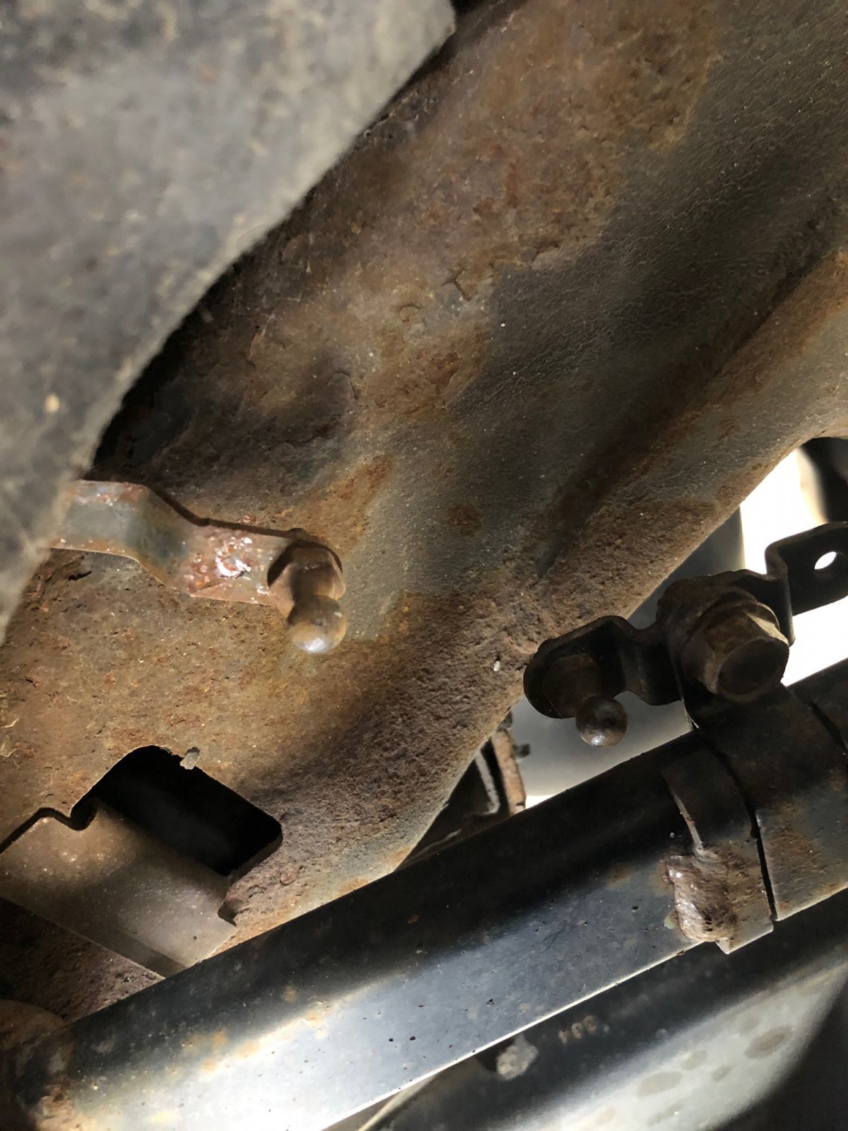

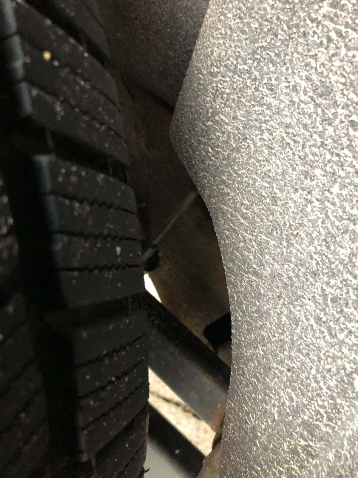

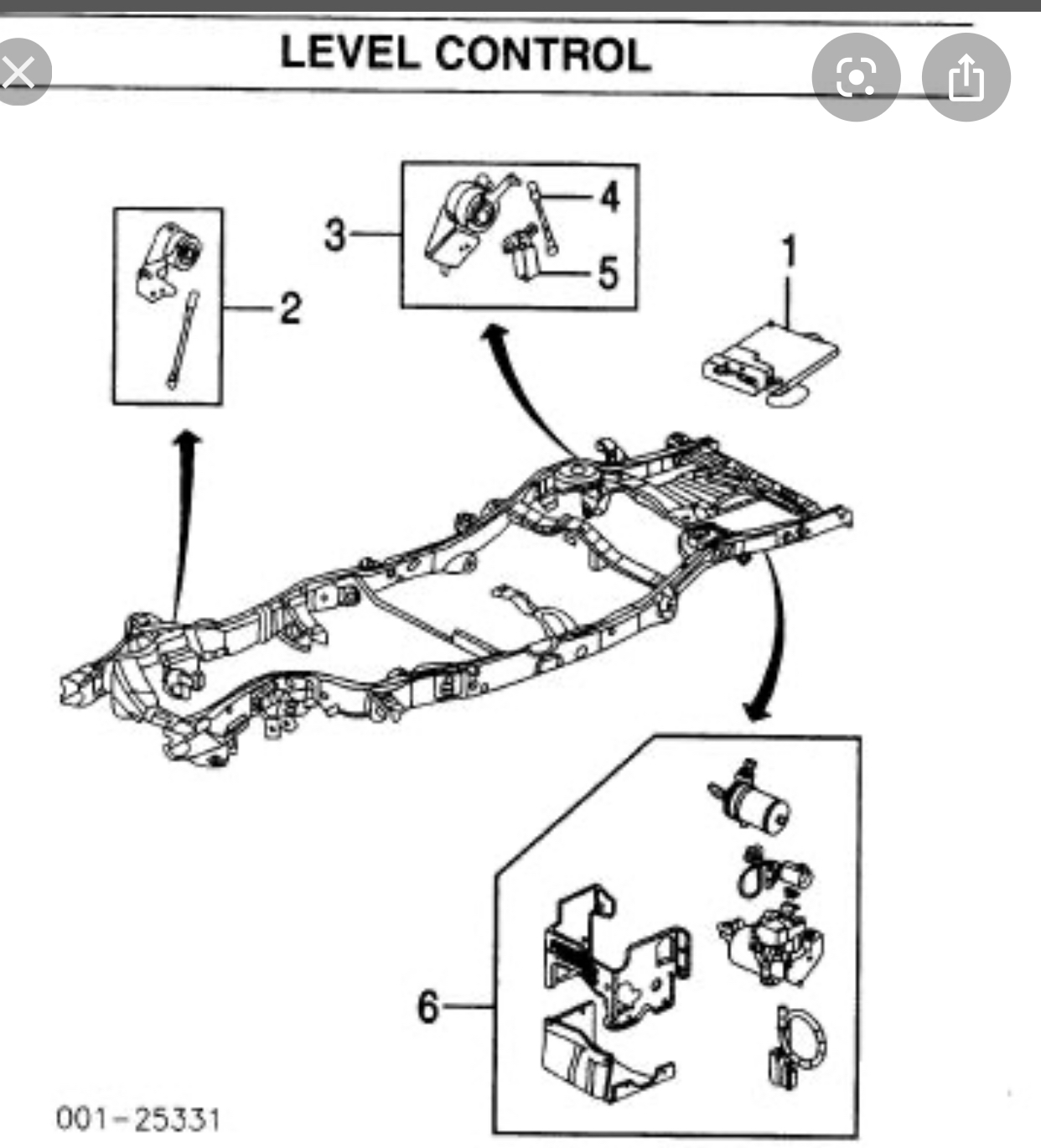

What year is your vehicle?
I unfortunately I can’t find that arm anywhere on my set up. I know where the compressor is all it has is a couple electrical plugs and the Compressor air line nothing else they must’ve change something
This is the passenger side in front of the rear tire. Easier to see if you jack it up or take the wheel off.
