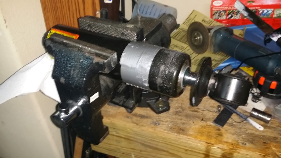

I decided to buy the used lathe and make my own parts for the short throw shifter. Once I had the lathe and a couple HSS cutting tools for it I needed some raw material to use for the shifter components. As luck would have it, I recently upgraded my Tahoe's rear shocks to QA1 shocks and I had my leftover stock shocks. I decided to carefully depressurize the shocks and then cut them open and see if I could use their internals as the basis for this. If you decide to do this then do your homework about depressurizing the shock because it can be very dangerous. Here are the shocks being cut open:

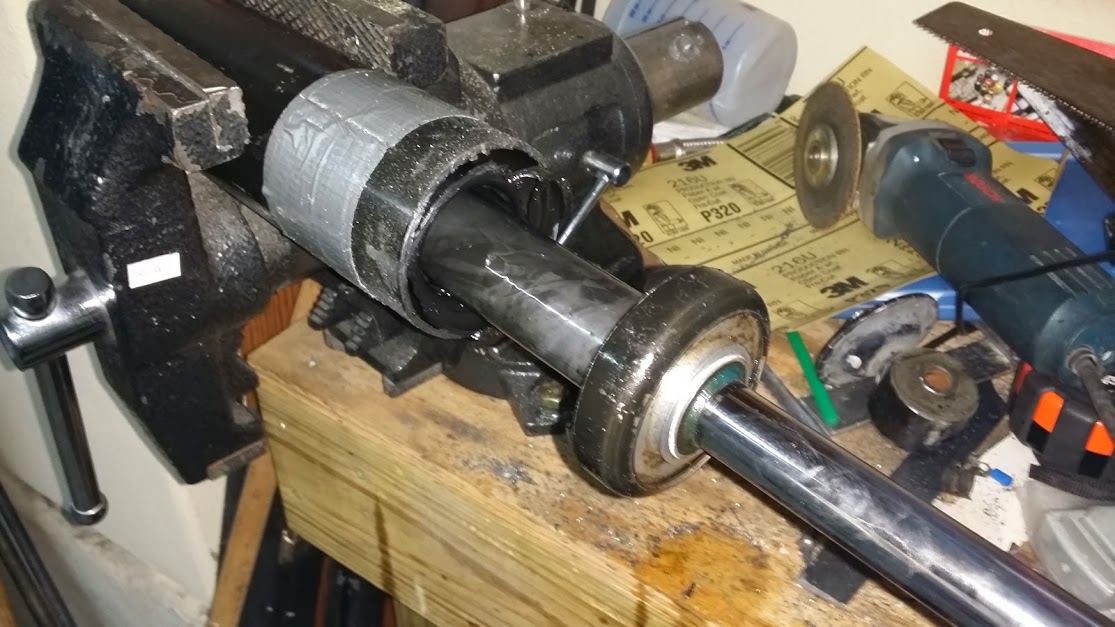

I ended up using the main chrome rod that has the top eyelet screwed onto it. Here are the internals of the first shock:

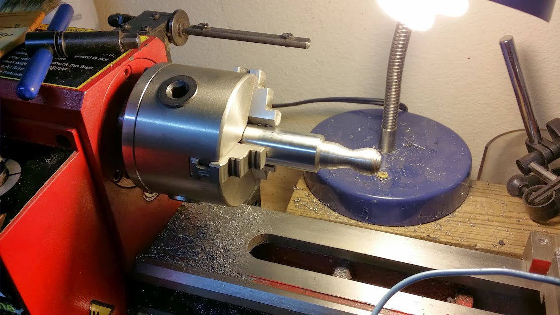

Once I trimmed the main part of the shock to the right length I got started on turning it in my lathe to the right shape and dimensions:

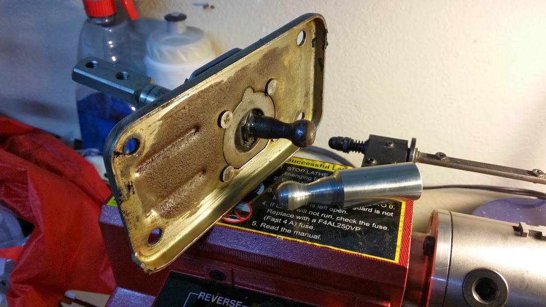

Here is the stock T56 shifter next to the extension just before I reached the right shape:
And here's a trial fit:
