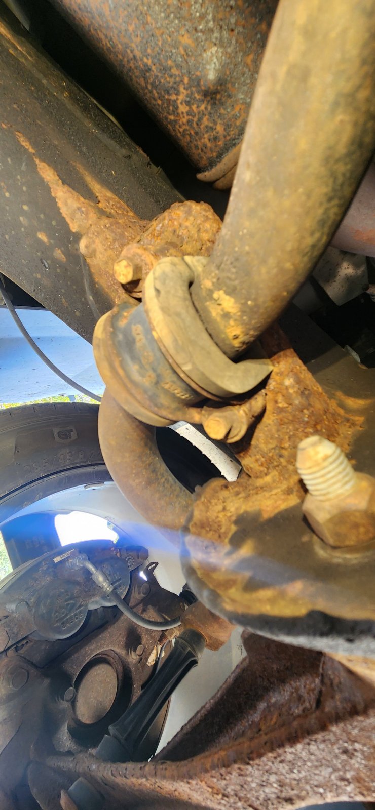

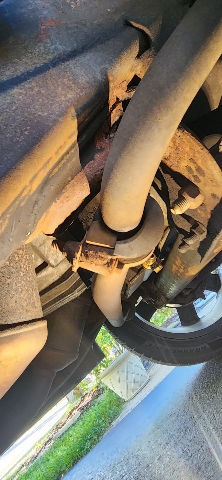

So the Yukon wants attention. Anyone d.i.y. this? I guess I gotta grind the old one off and driveway weld the new one in place? Also anyone have the part #'s handy? I know I've seen them on here before but too aggravated to look..

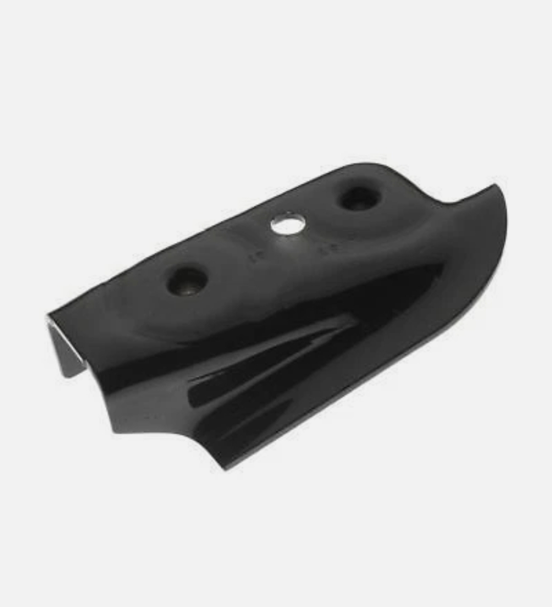

Thanks Joseph but in addition to the parts you listed I need these as well. They need to be welded in.
Go to the GMPartsDirect.com site, enter your truck specs or VIN, and see if you can find that part, as well. Or, talk to the dealer.
In reality, your best bet may be to bring the truck to a local welder shop (exhaust shop, for instance), and let them fabricate and weld a piece to the truck. Should be easy peasy for them.

84037074 (passenger side)
84037075 (driver side)
Found info in this thread...
TSB 15-NA-082
This covers the swaybar bracket replacement with part numbers

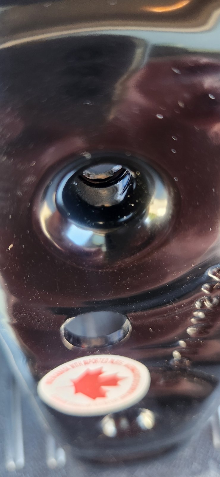

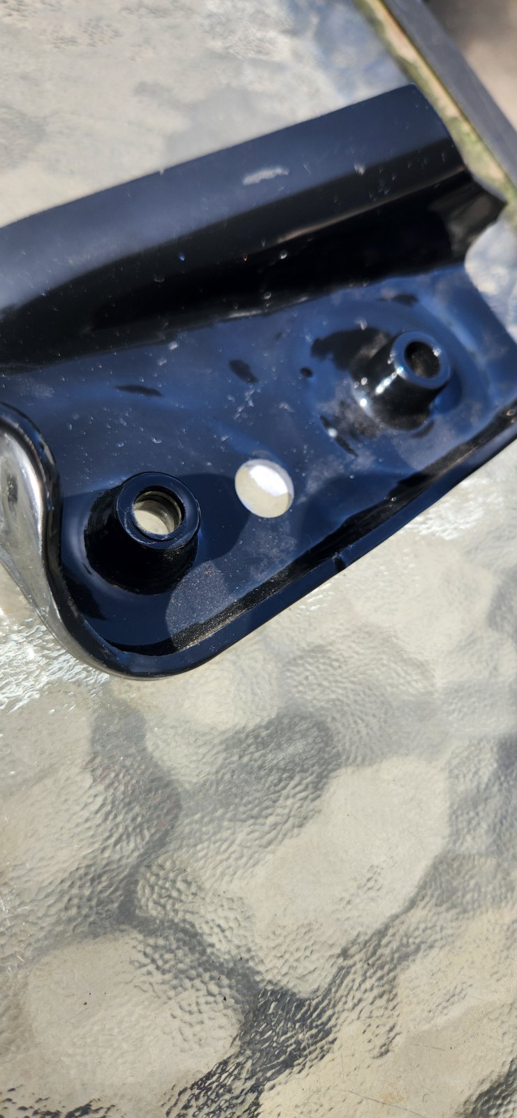

So the new brackets don't have any threads in the holes..Im assuming the new bolts 11570934 make their own on the way in. GM calls the bolts "hexagon flange head tapping" bolts. Just wanted to check on here for verification.

That makes me want to weld a nut plate in, instead of welding a new mount. (I drilled one bolt out crooked)
Though in @solli5pack's case, the mount looks all rusted out.

There is a factory retaining nut on the top but I assume it's welded to the frame?? If so, aligning the new mounts will be key so everything lines up.

That nipple that gets threaded, becomes the retaining 'nut'.

I guess the nipple nut should be better at not rusting on the threads vs a nut...
Maybe what we need is a drainage hole on that corner that gets welded between frame and front crossmember...
