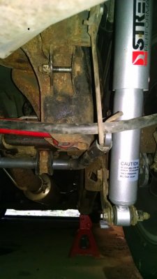

I'm having the same issue with my 02 burb. It's all djm on my truck. End links and bar. When it's all bolted in it hits the pass shock. Actually had it hooked up wrong before and broke the pass end link because it was hitting the pan hard bracket. So I'm interested in what we find out here. I've already ordered new endlinks but not putting them on untill I find out some more info.

Thats exactly what my sway bar looks like with the endlinks. It is pushed as far over as yours and rubs on the shock.
How much is yours lowered? Mine is only lowered 3" and it seems that they are way too short for a 3" drop, and also seems there is way too much of a bend. Its kind of frustrating that I bought the endlinks because everyone says you need them and then you run in to a situation like this that you cant even use them. Especially in your case when you broke one.
