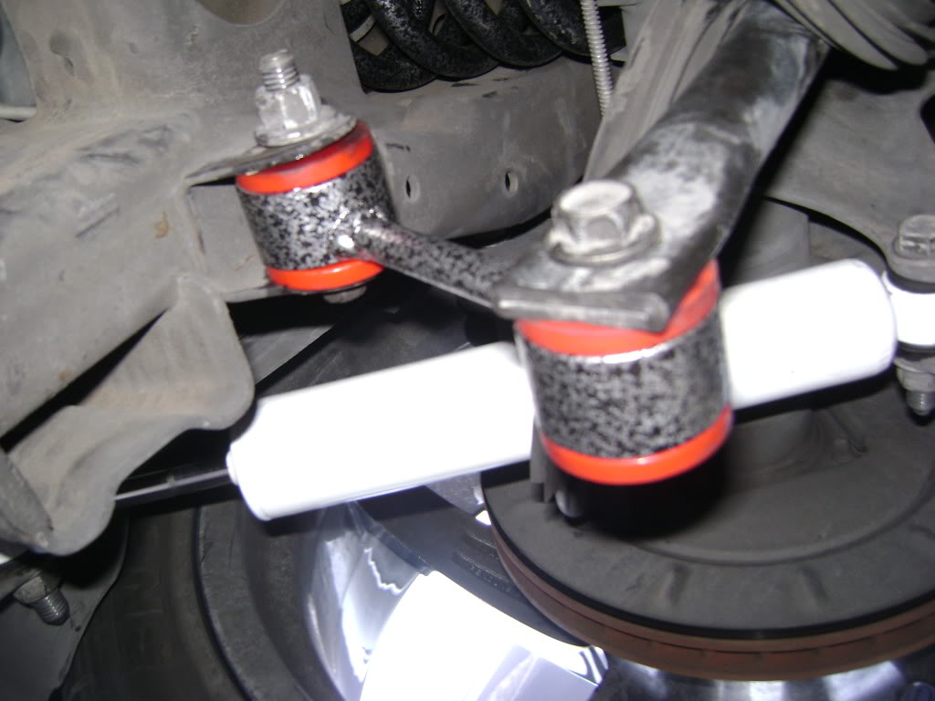

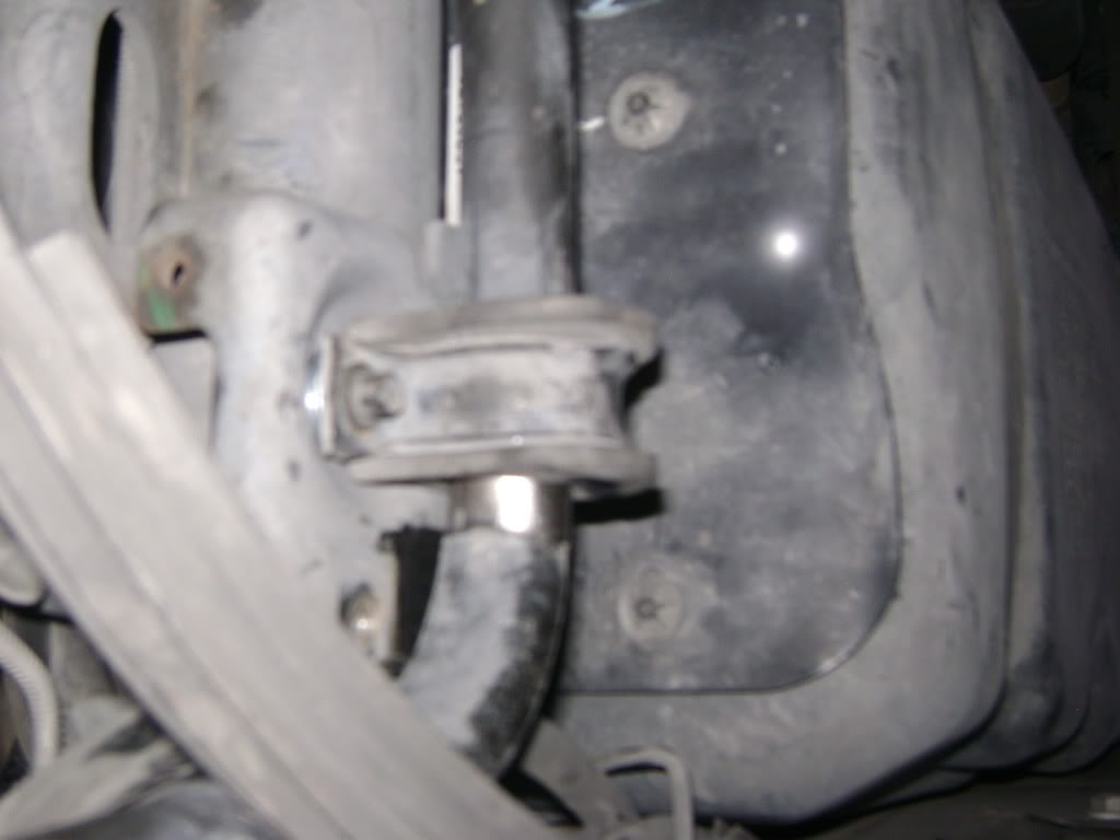

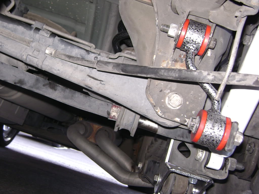

You gotta move the left sway bar bracket over two inches so you can move the sway bar over. Then the end links should go on the outer side of the sway bar. ill take a pic right now and show you.
EDIT: the right one goes on the inside.
---------- Post added at 06:53 PM ---------- Previous post was at 06:38 PM ----------
Gotta move it over
Should line up like this (driver side)
Passenger Side
