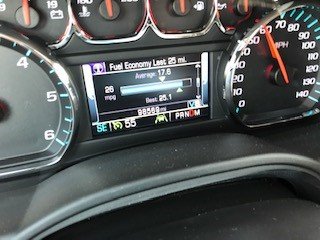

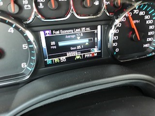

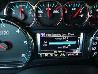

Just an update.
Still averaging great gas mileage after the upgrades. Posted pics of the dash board.
Using Tow/Haul button while pulling my salt water boat, averaging 15mpg on Arkansas roads.
Adding pictures.
