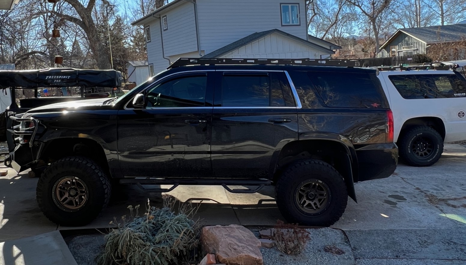

I built my own cross bars for mine. I used wing shaped cromoly steel tubing for light weight and strength.
They are mounted directly to the side rails for a very low profile. Photo below: the top black cross member is stock.
I added a third rail to make mine more rigid with my 270 degree awning. If you are mounting a third rail you will discover the center will not be the same height as the front and rear ones.
If I was going to do this again I would consider using T-slot material and T nuts and mounting it in the side rails.
Great pics. I was about to ask how you mounted the awning.
