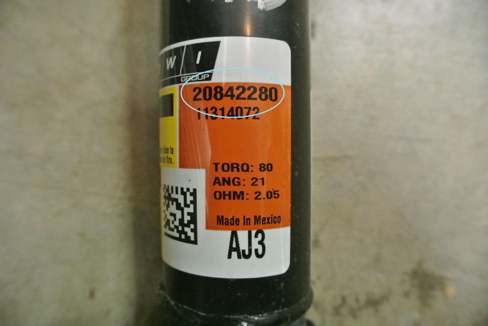

there should be no difference other than you have MRC or you don't, unless your springs are shot for some strange reason then you can just replace the actual shock, look for the part number on the shock and enter into the rock auto search button, your part number will be something like this
30,500
47,887
you can also just look on the rock auto site by entering you make/model/year there pretty accurate and cheap
