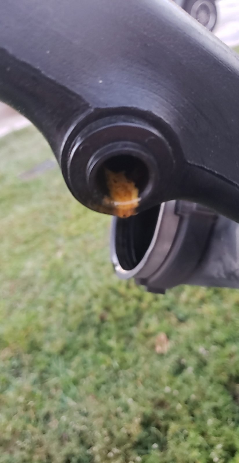

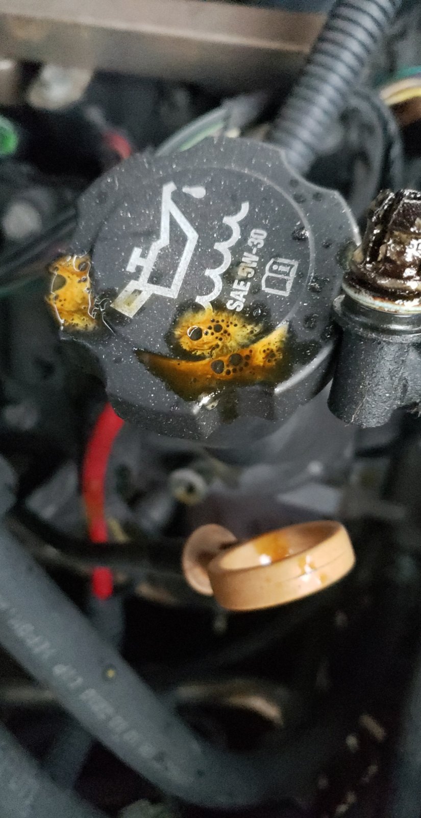

Okay no stalling today. I did clean the throttle plate again. Checked the terminals, looked for shorts, and cleaned the MAF, and got 60 PSI at the rail. I still have plug wires and tuff to check. She is running better. The throttle plate was pretty bad. Which leads me to my second question. Anyone have any idea what the heck this is? The hole its coming from is where a valve/hose connects to the upper intake from the fuel rail/valve cover area on the passenger side.

milkshake from the pcv, probably need a catch can
Would that be a failing PCV that needs to be replaced or does it just need a catch can?
Edit: If this thing even has a PCV valve. I assumed it did because my other truck has one, but I dont see a valve listed online. Just a hose that connects the PCV to the intake.
There is no pcv valve. The pvc system is built into the valve cover.
There is a Technical Service Bulletin that may apply?
https://f01.justanswer.com/ebrock63...il+Consumption,+MIL+ON,+Engine+Runs+Rough.pdf
Vehicles Built Prior to February 1, 2011 Require Updated Valve Cover
Aluminum or Cast Iron Block - Oil in Intake Manifold - Install Updated Valve Cover on All Models Built Prior to February 1, 2011
like noted above it's built into the drivers side valve cover, there is a updated one, but either way a catch can will help prevent the oil +moisture mix from getting into the intake.
