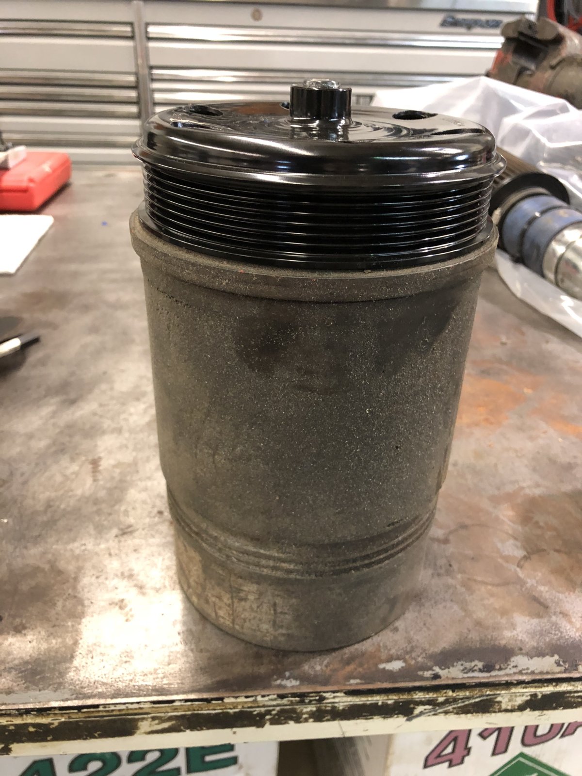

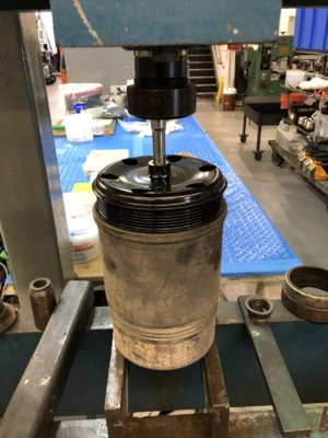

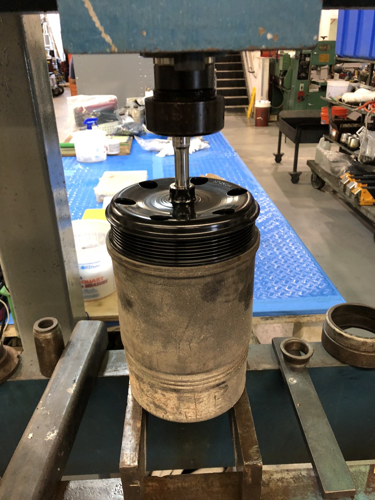

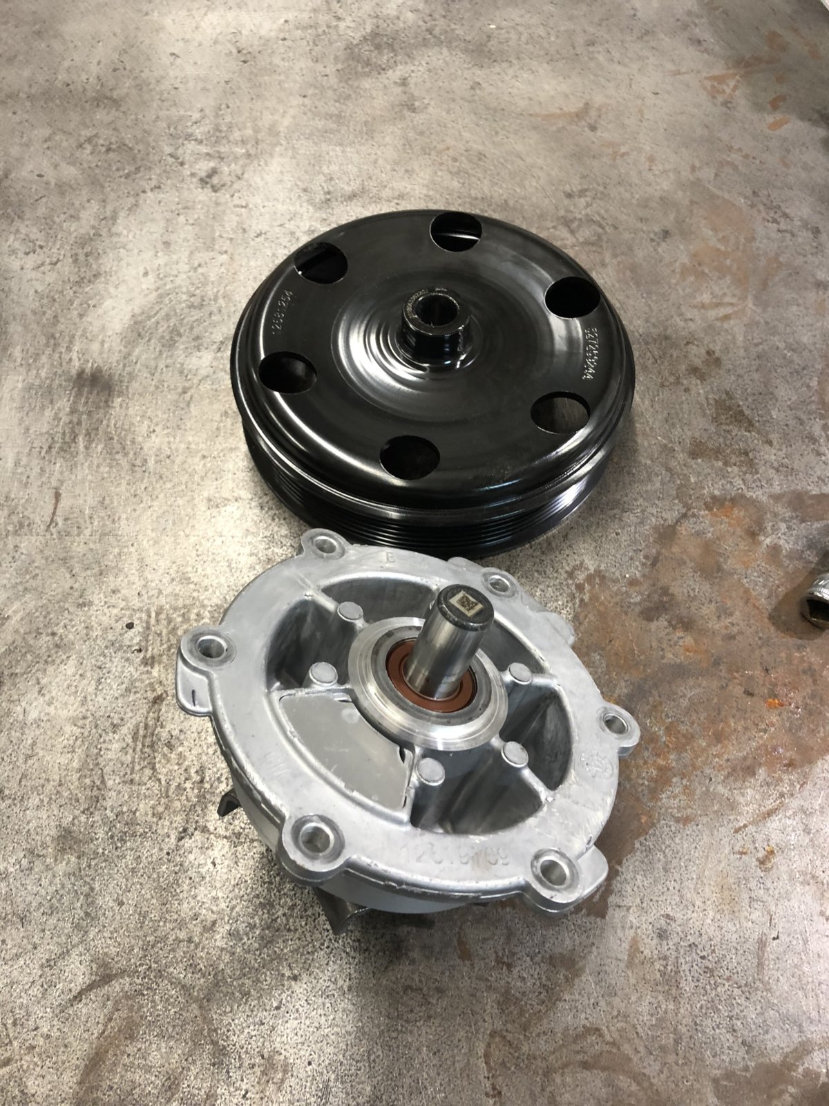

Received my water pump today and removed the pulley will press on the 8rib and start the trial pulley install tomorrow. Used a liner from an old overhaul, worked perfectly. My press bin if full of fun stuff.
6CB097BD-A1D3-4B1F-8A8C-84B355142B5E.jpeg 25C1F422-8BC1-41BD-AC8F-ABA0F79322F3.jpeg 735353D8-7FDF-4494-80D2-5D9AE50B28D7.jpeg
