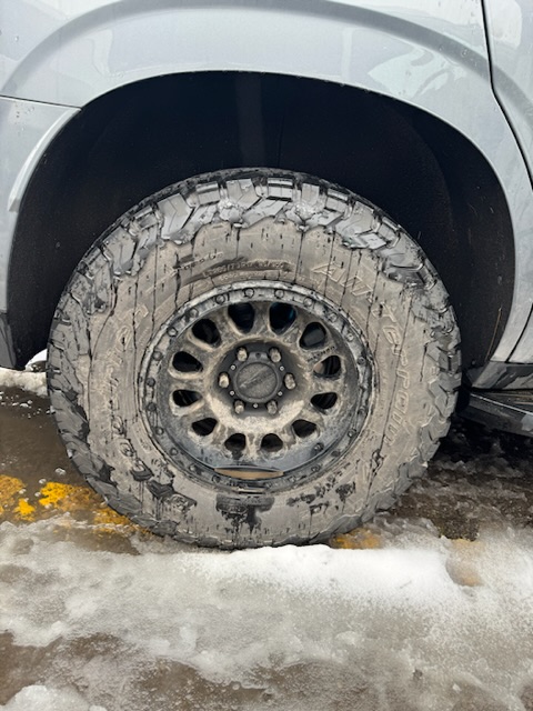

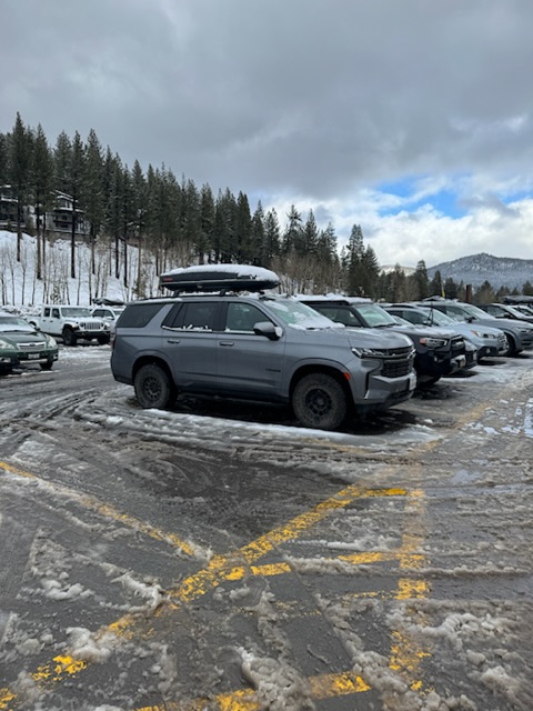

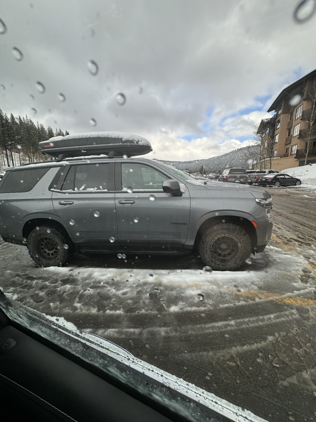

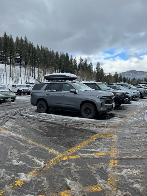

Hey everyone. I’ve got a 2021 suburban primer diesel that I’m looking to put beefier tires/wheels onto. I saw this Tahoe in the parking lot last winter and love this look. Does this look lifted/leveled to you guys?
285/70R17 on it
I was thinking it possibly had a 1.5” leveling kit on it but should have taken a closer look.. Any thoughts?

These rigs come with a minimal amount if any rake anymore but it looks a little higher up front. Go to the tire size calculator on line and punch in your tires vs these to see the difference.

those are probably (guessing) 18" wheels and it may have a 2" level. The tires of course have more rubber because of the smaller wheel, stock wheels are now typically 22-24, which is for looks only.

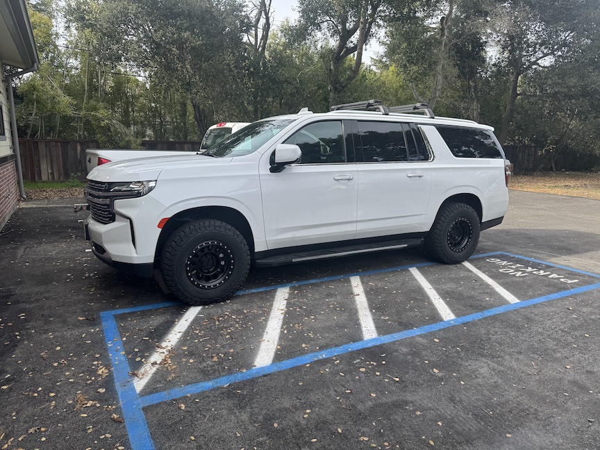

For anyone wondering: Ended up putting a 1.5" leveling kit on the front. Even with that and minor trimming, there is a slight rub in reverse at full turn.

Looks cool. Additional offset makes it rub more. It looks like you have more offset than the silver one.
