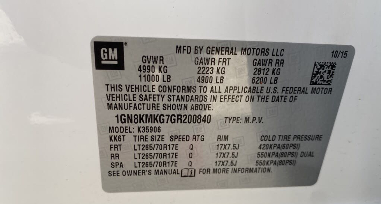

The bottom line to using all of this information is to make sure you stay within the limits of your vehicle's cababilities, and that you keep your family safe, and the others on the road, and that you don't break anything on your vehicle. It's a lot more than, "How much trailer can I pull?"
Any questions?
Even though this is an older thread overall, it’s a good review for towing between 1500s and 2500s so I’ll add my experience.
While my 02 Z71 (with e load rated tires & a transmission cooler) pulled my 26’ Toy Hauler over the hills on US 101 through Oregon & Washington and I90 over Snoqualmie pass, it came at the cost of a bent axel and heavy wear on the brakes. Actually went out and found the old 92’ K2500 and never looked back at the 1500 for towing more than my 10’ flat deck; even though I put a brake controller in the 09 Tahoe LTZ. If it takes a 2-5/16” ball, it should have at least a 2500.
