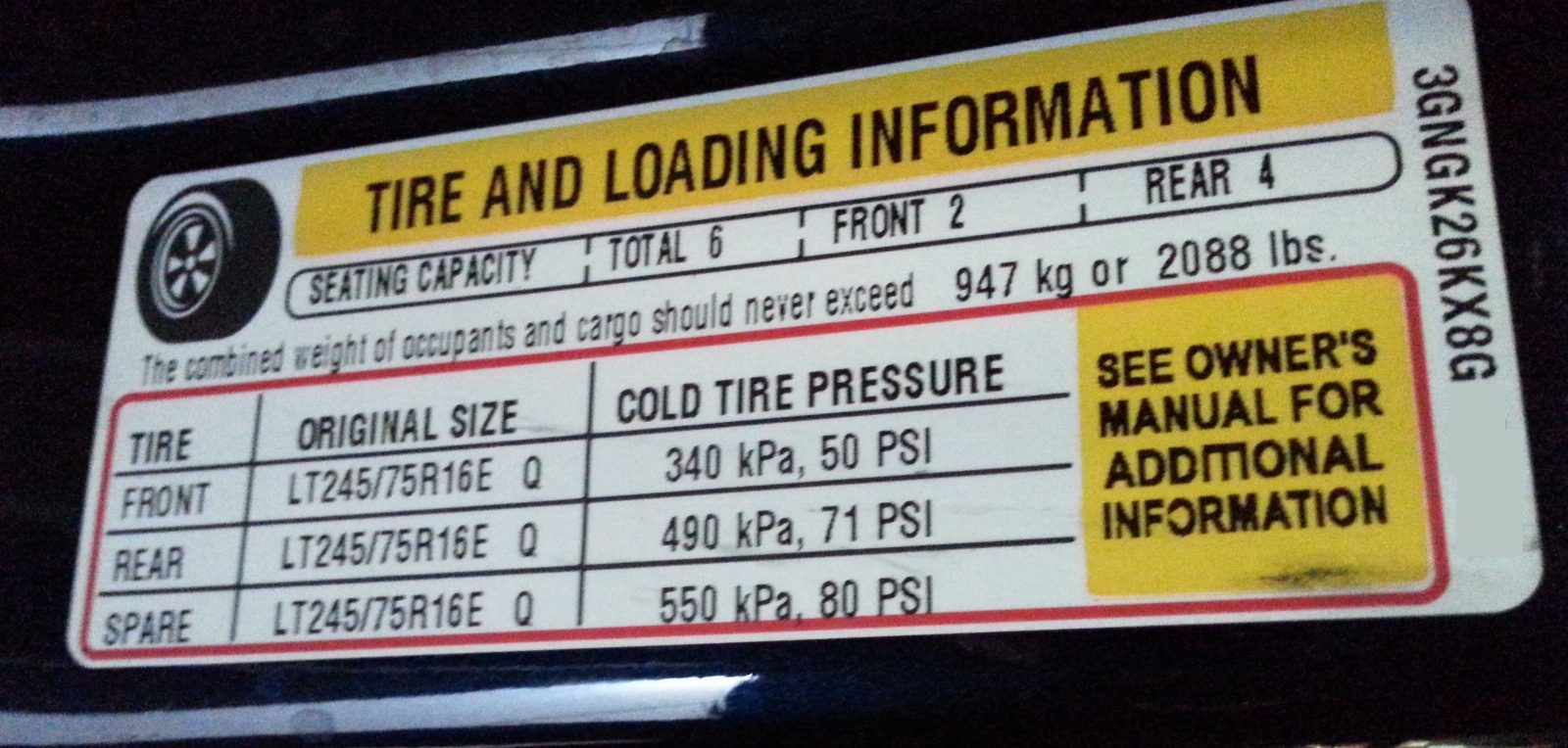

Here's what your payload sticker looks like:
In my case, my payload is 2088 lbs. To calculate the tongue weight of the trailer, I subract the sum of my vehicle axles with the trailer (my GVW) from the sum of the axles without the trailer:
(5620+3220)-(3740+3980)=1,120
The trailer tongue weight is 1,120, and looking at the sticker on my hitch, my max tongue weight is 1,000, using weight distribution. So again, I'm over.
That also means my remaining payload is 2088-1120=968 lbs for people and gear. People and gear in this case weigh more than 968, because I'm over on my GVW. I know that's true because my family of 5, with my fat butt and two teenage boys both 200 lbs, weighs almost 1000 lbs, and then we also had a bunch of gear in the back, plus the weight of the hitch in the receiver.
